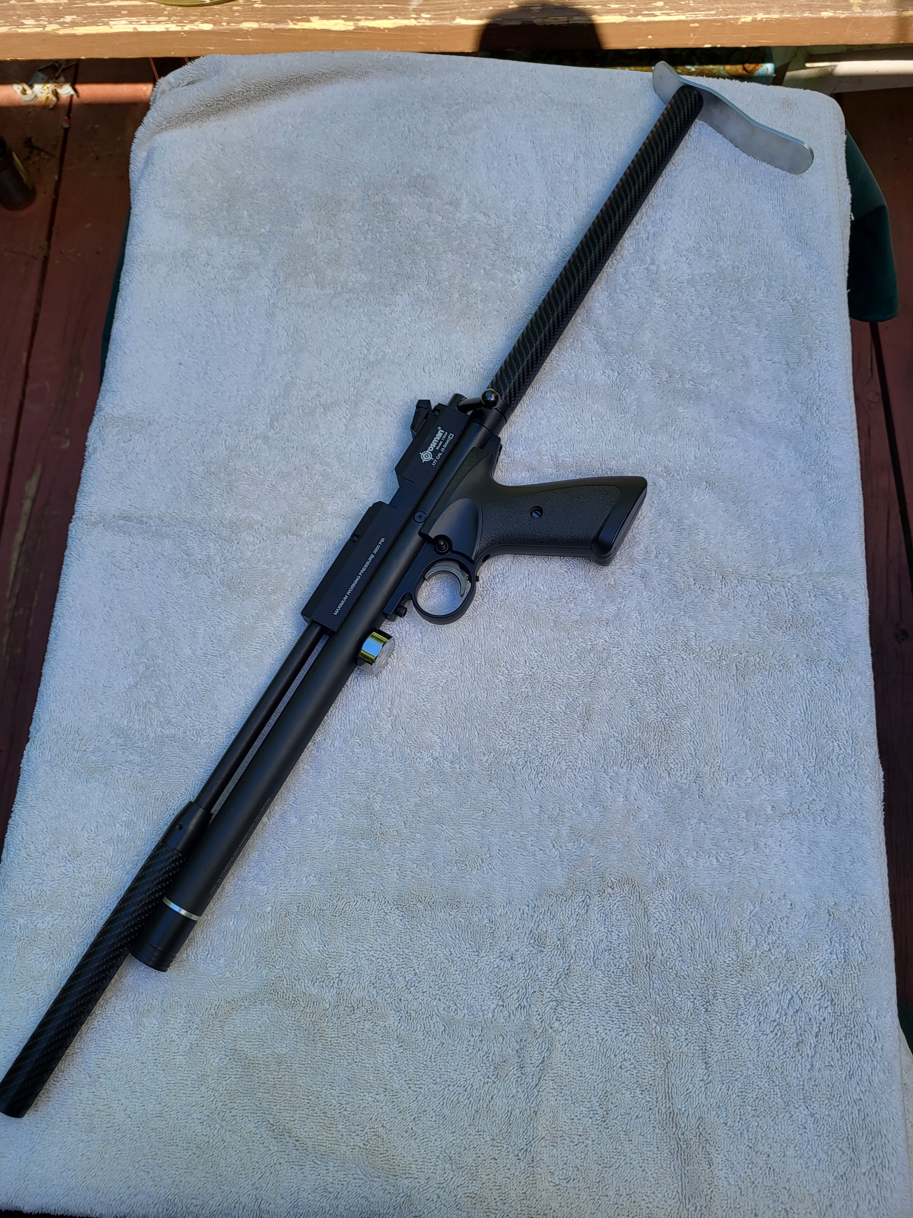

Crosman Crosman 1701P Silhouette

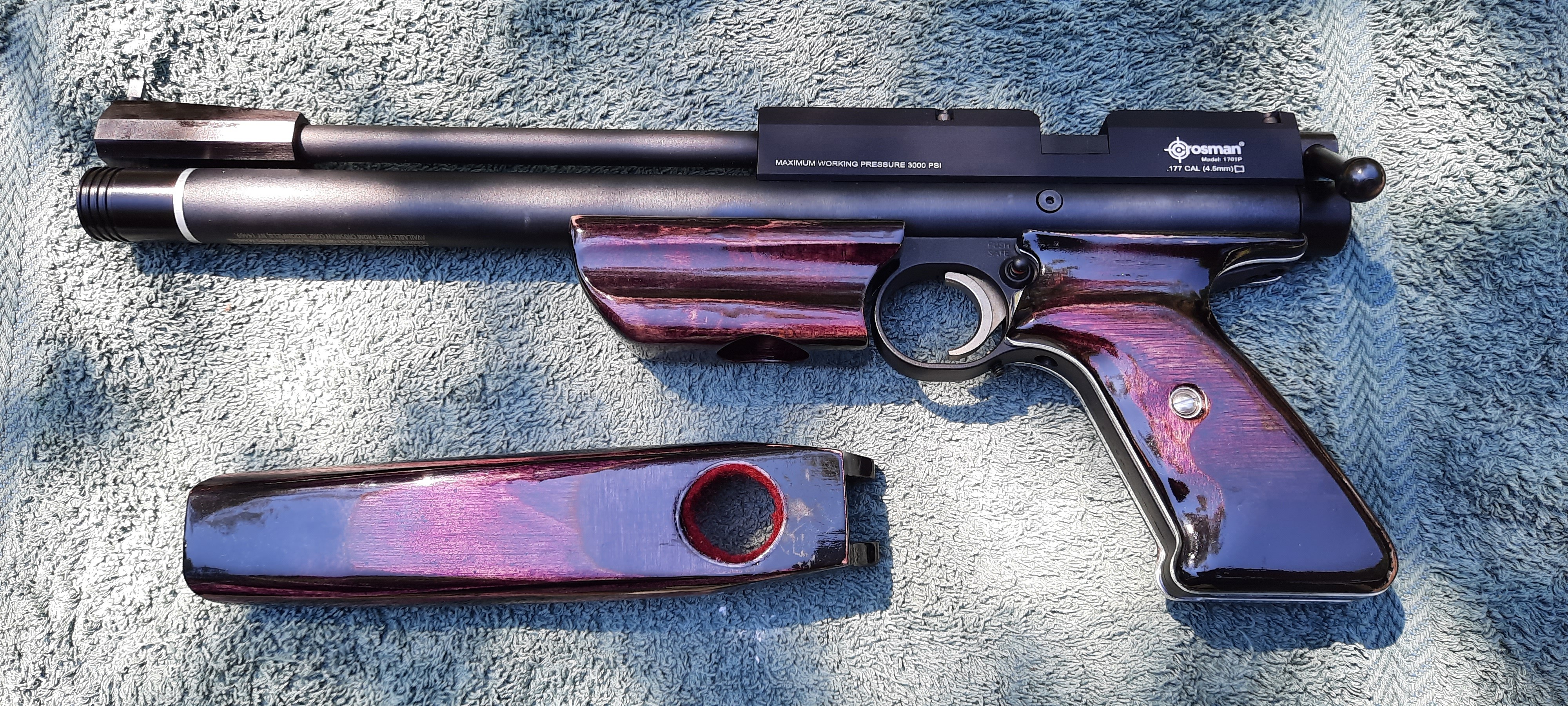

Stunningly accurate, pictured with my 1720.
So much fun! I'm still shooting mine as it came from the factory. From about 2800 PSI down to 1600 PSI, I get well over 50 shots. I refill in less than 60 seconds with a cheap hand pump. I find that loading can be a little tricky with the lighter domed pellets, as they tend to turn on their heads when they go from the pellet tray to the barrel. My remedy has been to push them into the barrel with my thumb a bit and then close the bolt. heavier pellets with longer skirts don't seem to do that, but JSB 7.3gr and 7.8gr pellets do.
The gun isn't particularly pellet picky. Light pellets, heavy pellets, lead round ball and even slugs seem to shoot great from mine at 10 meters. But I usually shoot 7.8gr domes for target practice. If you're after accuracy and honing your skills, this is a very nice gun for the money. What sight will you put on yours?

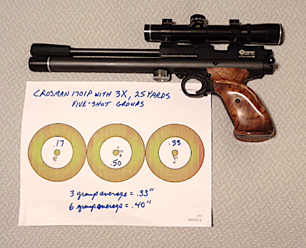

Upon diving into mine to drill out the transfer-port to soup it up to 10 foot pounds with absolutely no previous experience going into Crosman PCPS, I declared my 1701P the most logically designed and well-executed airgun on Earth. Consequently, THE EASIEST TO WORK ON AIRGUN ON EARTH.
It took all of 20 minutes for me to go from utter ignorance in servicing Crosman PCPs, to increasing my 1701P's power by 300% with no loss of accuracy whatsoever. Check out that .17" c-t-c ONE-HOLE five-shot group on the left, shot at 25 yards; not to mention the .33" AVERAGE group size.
Per my attached testing notes, a subsequent B-Staley mod increased shot-count by 46%, at a cost of only 10% of the souped-up power.
I consider the 1701P not only the easiest to work on airgun on Earth, but also the best bang for the buck in air pistols. Likely also the least appreciated!
It took me all of 20 minutes for me to go from utter ignorance of servicing Crosman PCPs to increasing my 1701P's power by 300%, with no loss of accuracy whatsoever. Check out that .17" c-t-c ONE-HOLE five-shot group on the left, shot at 25 yards; not to mention the .33" AVERAGE group size.
Thanks for sharing

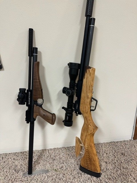

Thanks for sharing. Grips look great
I'm going to try with open sights first and then decide

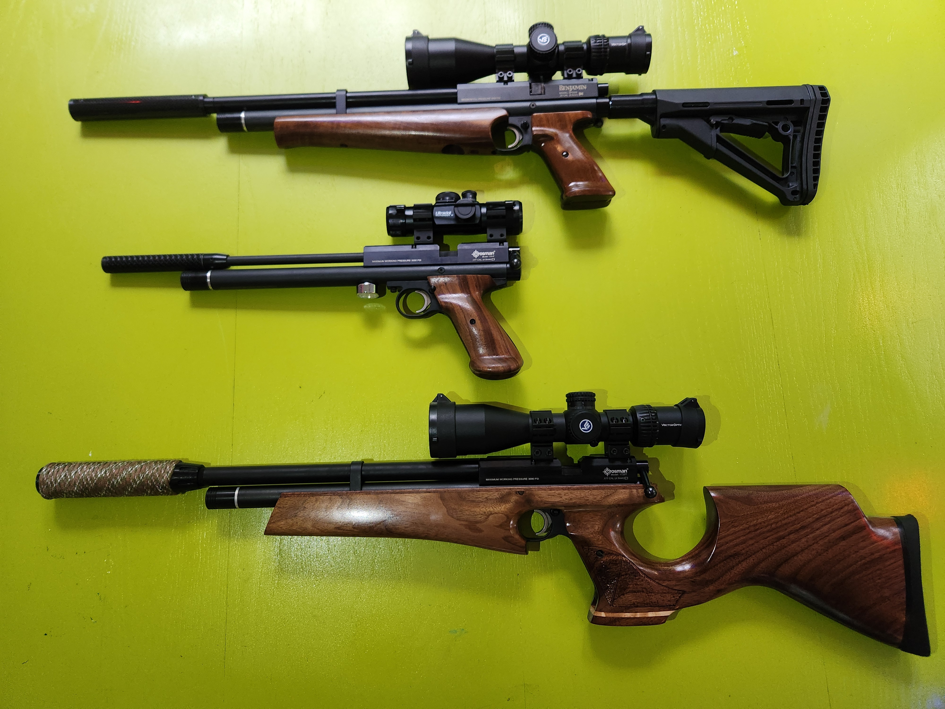

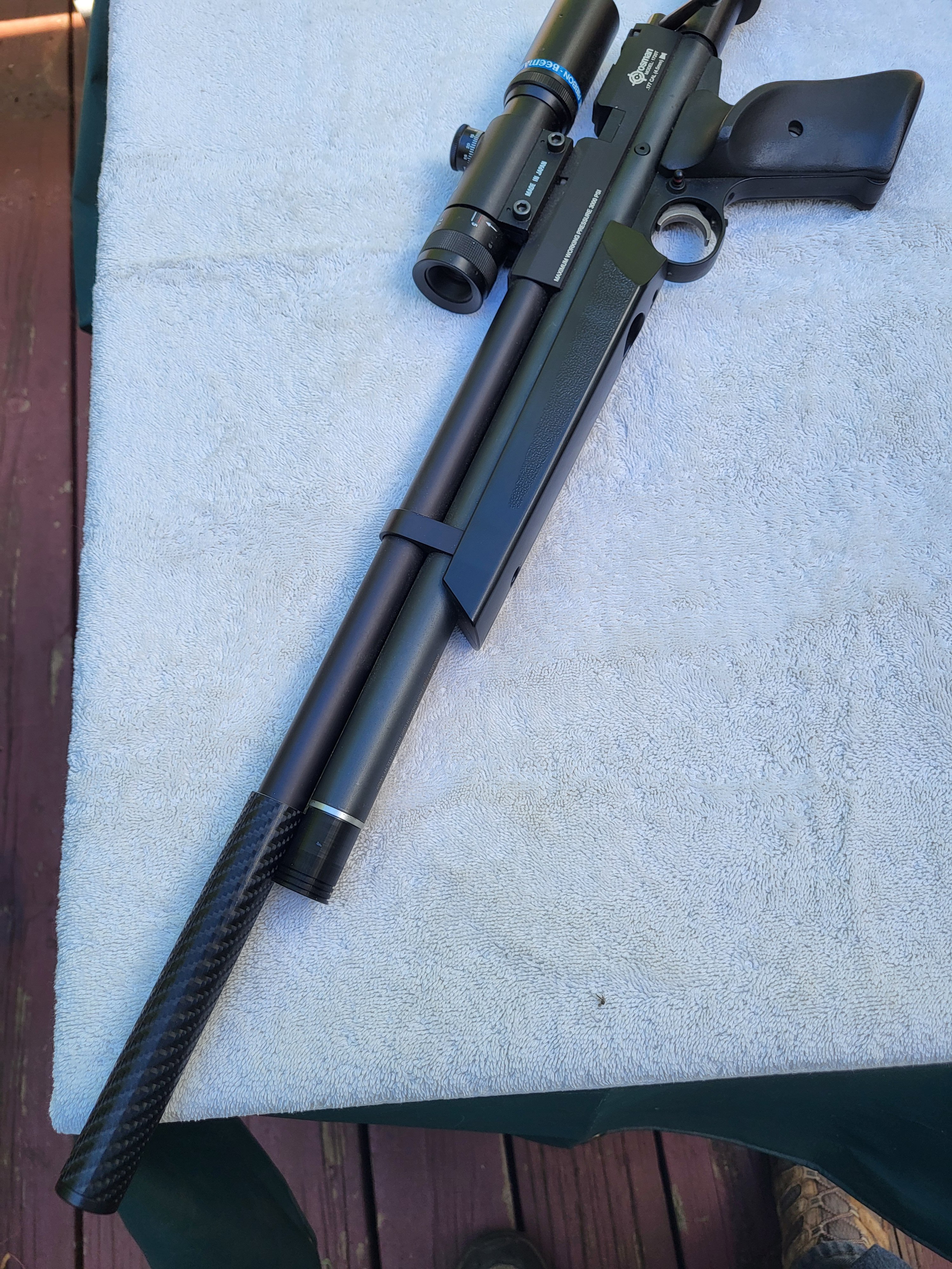

As you can see, I love these pistols. Easiest guns ever to work on. I left my 1701 stock tune as I get 60 shots with 8 grain pellets that yield 390-425-390 fps......405-425-405 for 50 shots. However my 1720 and Prod definitely benefit from the Bstaley mods to help flatten out the shot curve. Excellent accuracy with all 3. 1701 not pellet picky and shoots many pellets well. It doesn't really need the tko moderator, but with it the pistol is super quiet to shoot indoors. With the Ultradot it's so much fun to target shoot as well as plink cans. I have a number of high end airguns and these get shot just as often if not more.
