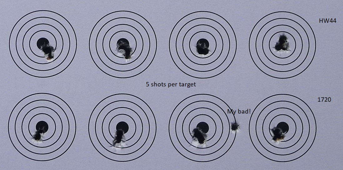

I had time and good weather today to compare my Crosman 1701 to 1720 conversion (both in .177) with my new HW44. Both pistols are equally accurate (see targets below).

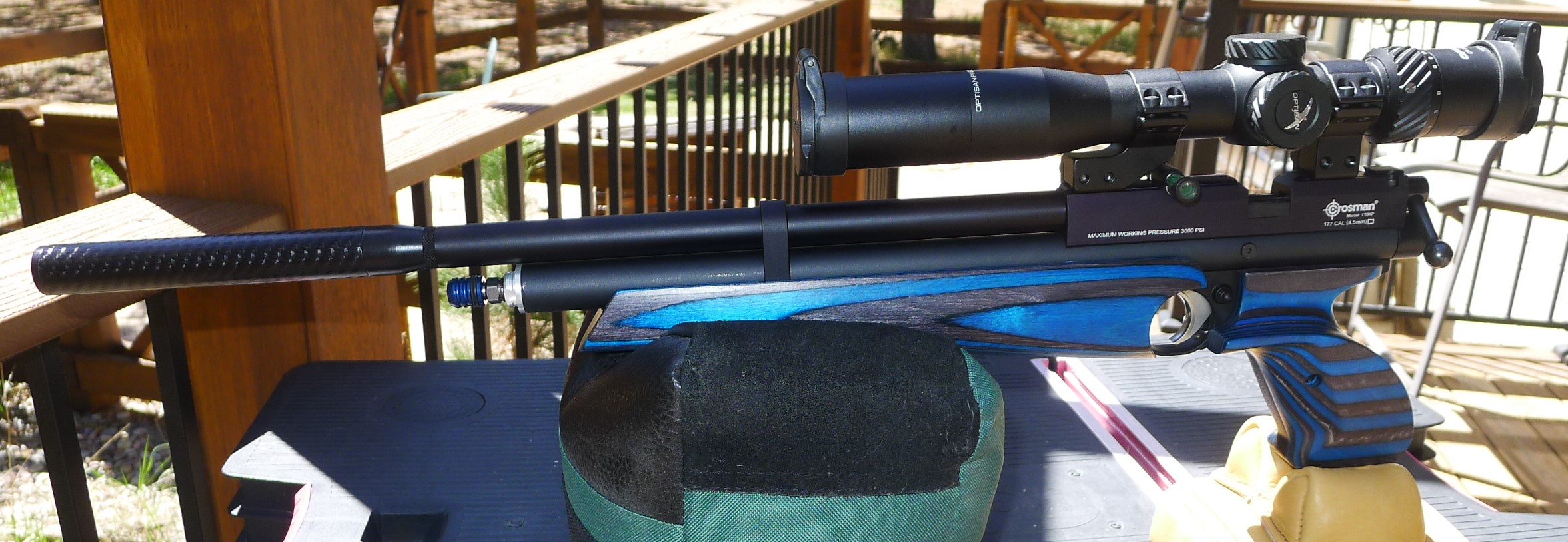

My 1720 conversion is configured as follows:
Crosman 1701 converted to 1720
Huma Regulator
TP = 0.80”
TKO Moderator
DonnyFL moderator adapter
Steven Corcoran Forearm & Grip
Optisan CP 3-12x32P Scope
UTG Accushot Scope Rings
Weight as configured – 5lb

Shot count: 19 (forgot to power up Chrony for first shot – shot 20 pellets at targets)
Low: 728 (don’t know what happened for this one shot – all the other shots were around + 6fps of the average velocity prior to and after this shot)
Hi: 761
Avg: 755
Spread: 33
STD Dev: 6.9
1720 conversion
Pellet JSB 10.34gr
Target 10yards
Shot count: 20
Low: 677
Hi: 689
Avg: 683
Spread: 12
STD Dev: 3.0

The 1720 was my first PCP. Still stock, shoots fine but I've been looking for a magazine fed 177 PCP pistol. I've been eyeballing the HW44 for a while now. Pricey but I feel it checks all the boxes. @fderry That blue stock on your 1720 is sharp!! Mine has the cheapy plastic brace on it now. If I come across a good deal on some upgrades then I may have to jump in.
