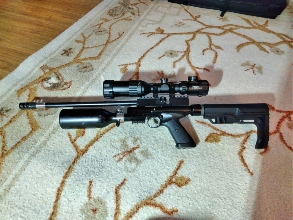

My latest yes, I know the barrel shroud is a bit long I am planning on cutting it down a bit. It is a 2240 bulked with paintball parts regulated to 1200psi, Custom Air breech, FX .22 STX barrel liner for a barrel and of course a modified valve. Shoots one hole groups at 25 yards.
Side lever magazine fed breeches to better feed the addiction.
