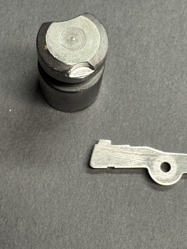

I made a change to both the Striker and Sear on my pistol. I milled a flat into the bottom of the Striker. I then filed the Sear to fit. This change makes for a nice Single Stage Trigger that starts at the wall, then goes bang.
I made an Instructable that illustrates the process.

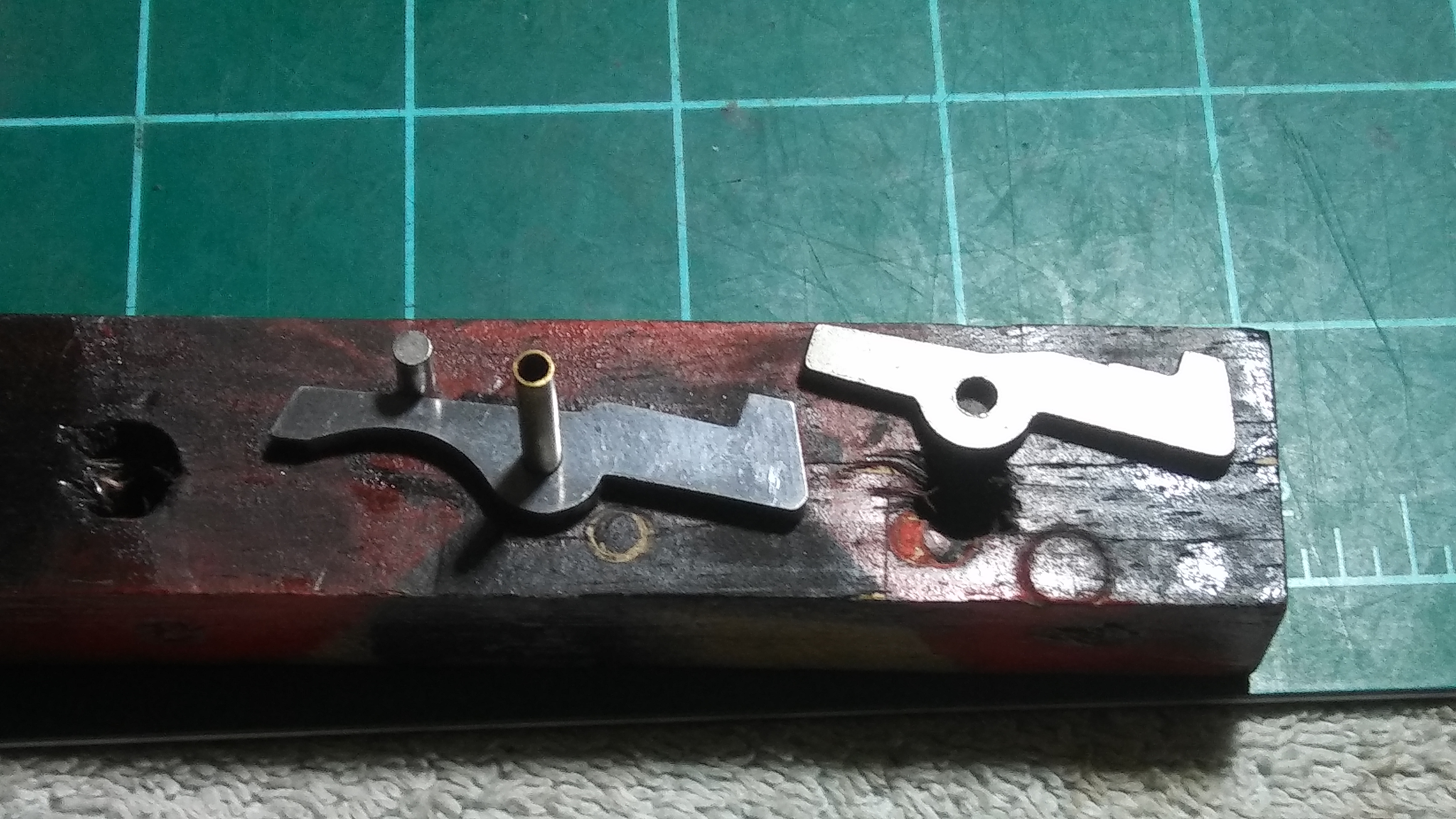

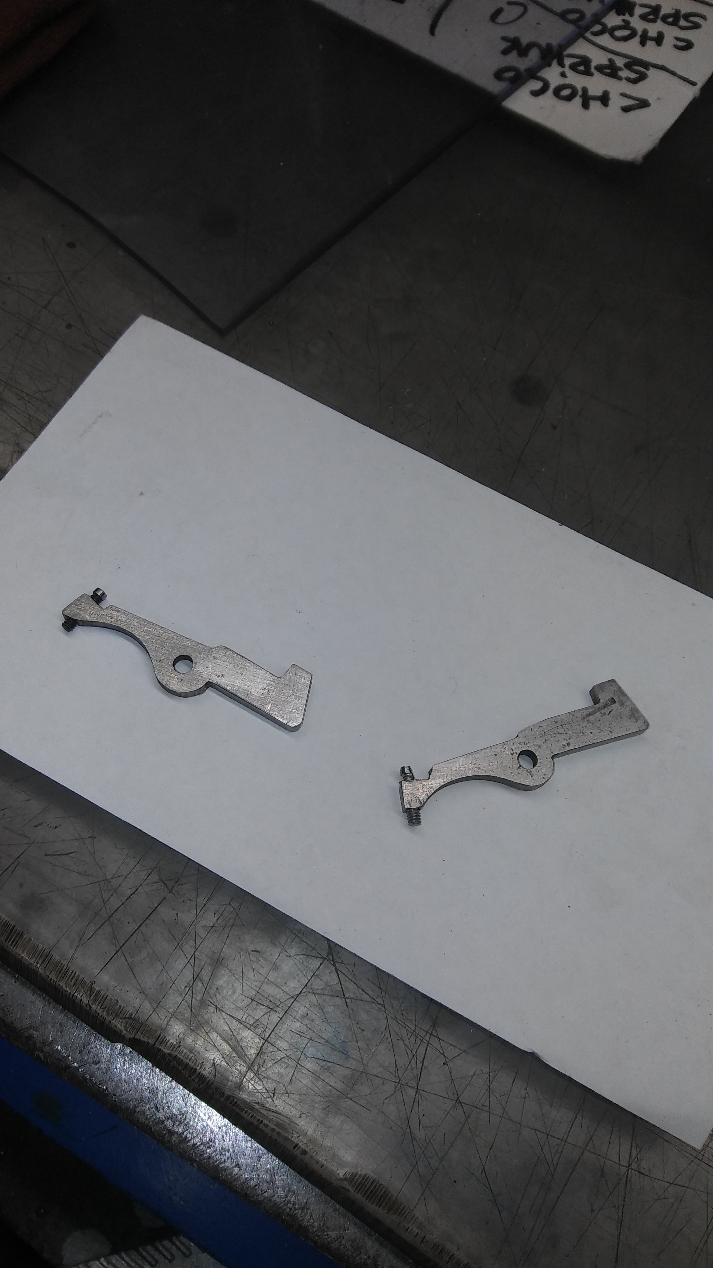

so i have for years told people to take .8mm of the top of the sear and with that the hammer will not need any work go to far and buy a new sear

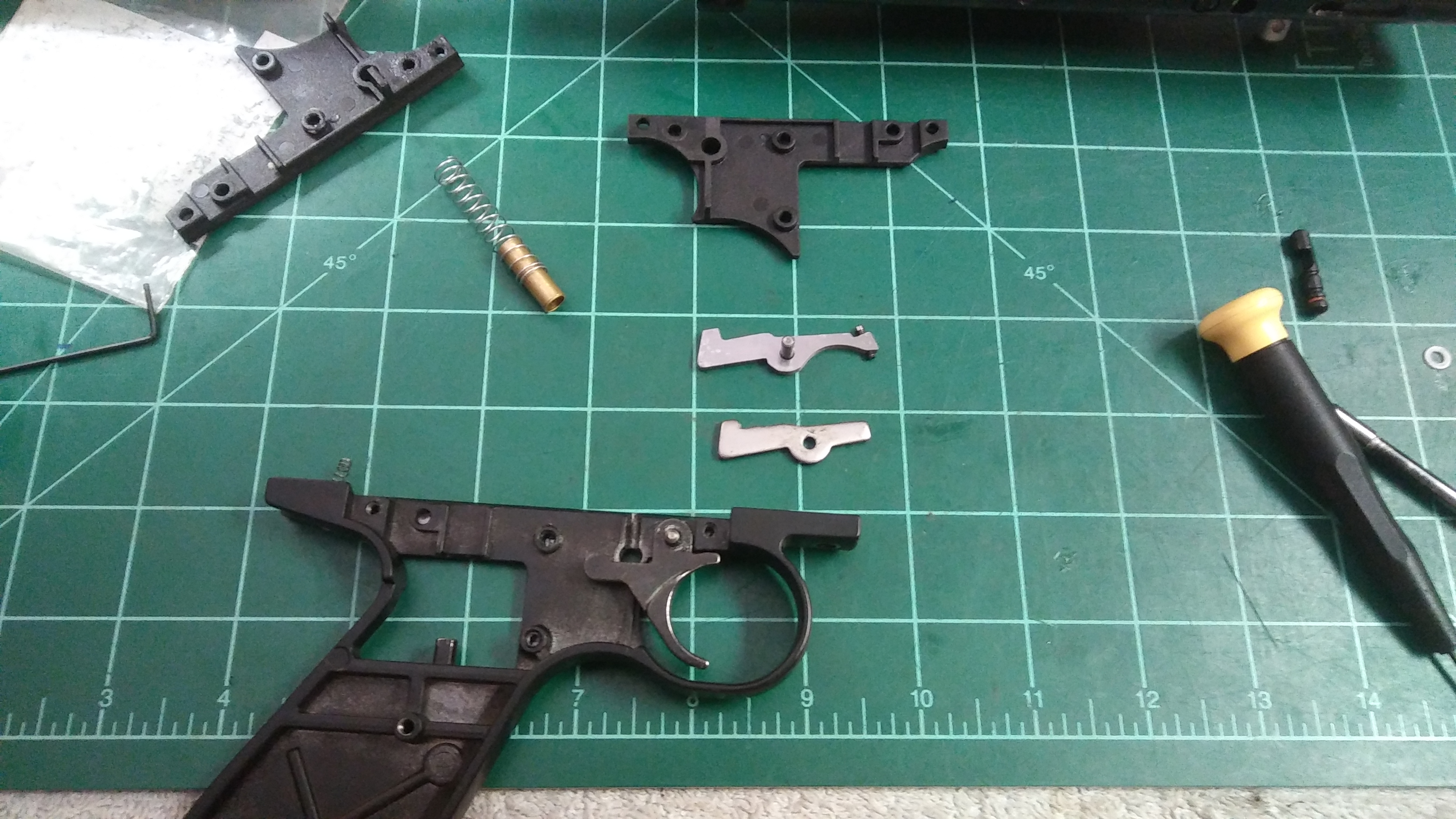

of course, the sear spring they put in the pistol today are far too heavy they have one job hold up the sear and the trigger has to be shimmed and so does the sear
the sears that Crosman use could be wider and wider sear do exist, but they are just cheap stamped steel
i have to say i have all the different trigger from 1720 to Blue Fork to super sear to this and that but Crosman has made no effort to make anything better maybe the ones now made in China have done that
