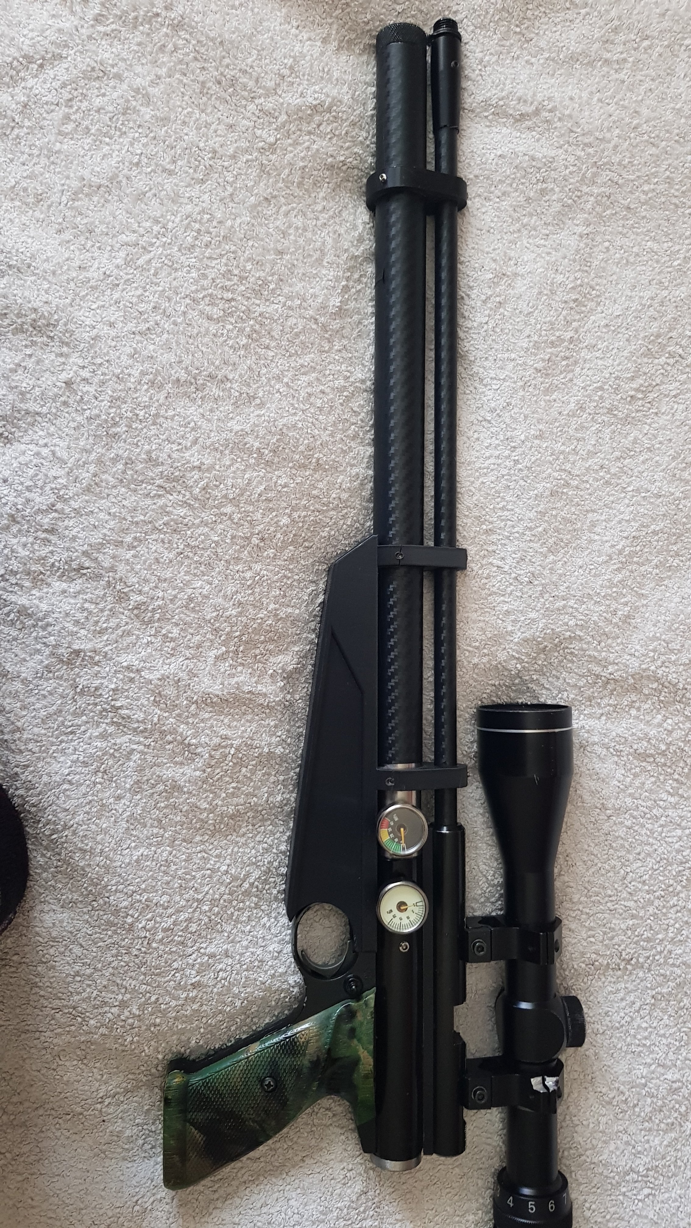

Hi tim
It's a great bit of kit " forget the hipac or drop block.
Regulator is adjustable.
Looks awesome! You wrap that with carbon fiber tape?
How has it been adjusting to cocking the bolt for loading then also cocking the pcp part? Is that annoying or not bad?
Also how high do you fill yours? Just 3,000 psi? Shot count?

Hi tim
One gauge for reg second for air in tube
I believe it's a 3000 psi fill.
Mine loads and fires as a normal crosman does by the side bolt" no rear hammer pull
Yes its carbon wrap

Hi tim
Yes its carbon wrap

Woah that's cool, I thought it had the little ball you pull back to cock the hammer, guess they have different versions.

Nice carbon wrap!

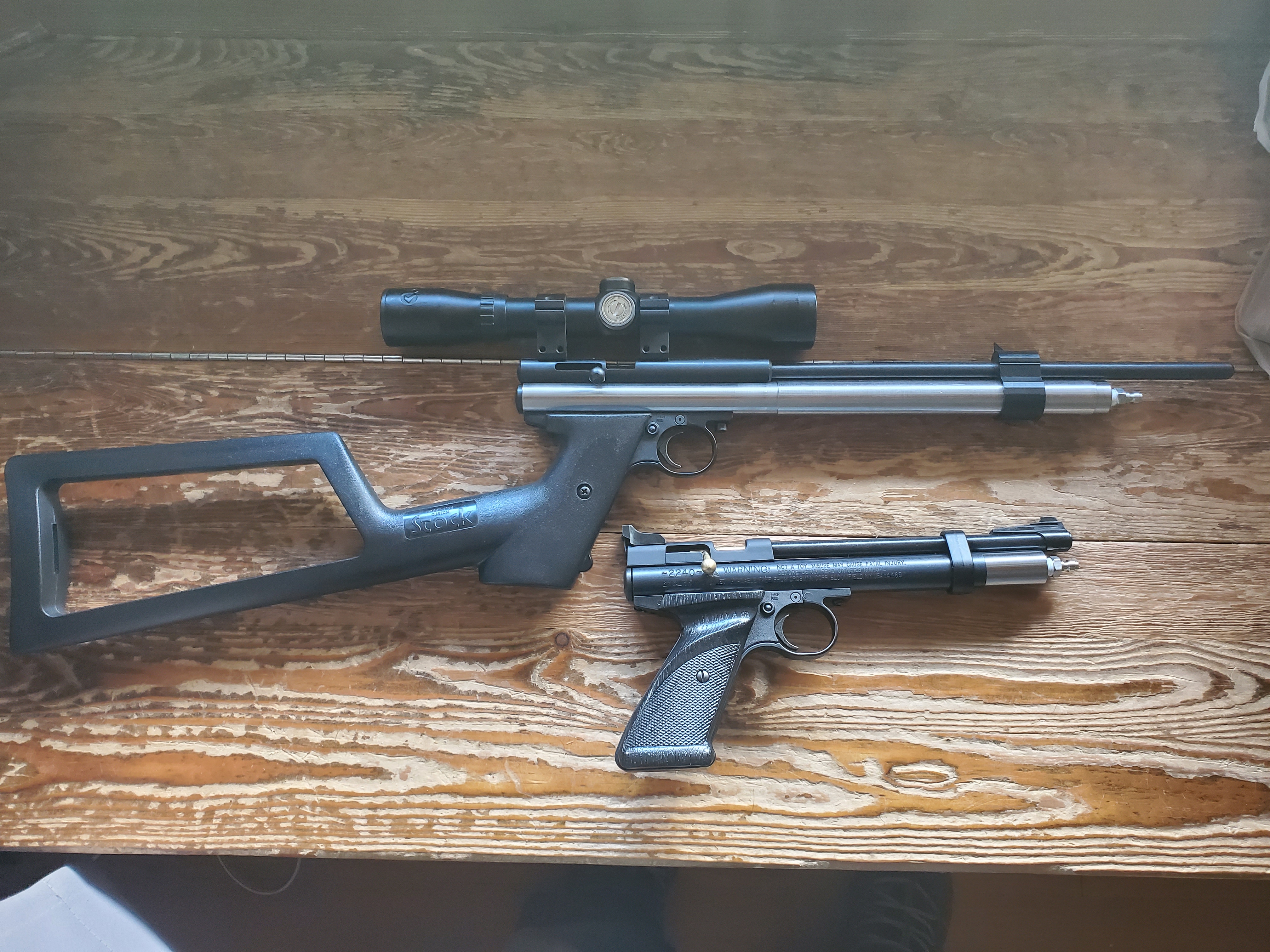

Very similar to the 22xx, I built a 1322 into as small of a pistol as I could while still using a full size moderator, and still doing 650fps. With low noise signature, and high shot count.
I'd like for it to be a hair shorter, but the 230mm airtube was the shortest one to be found. I have a 300mm tube as well, but it is rarely used.
Gun will do 27fpe, with 18gr .22 pellets. In a 7.6" barrel. But I have it regulated to 650fps with 14.3gr pellets. Shot count is up around 100.
This gun is QUITE heavy. But is perfectly balanced, extremely steady, and is exceptionally accurate. Even off-hand.

Indeed. It is very quiet for its size. It looks like the new kits don't drop the tube down as far and require a custom breech in order to use a shroud. And I'm not even sure if the shroud has the cnc baffles like mine came with. The valve looks the same as mine.
The original kit was much longer. As is, mine is about an inch longer than a normal 13xx. But the ones they were selling at the time (and current ones) would have made it about 4" longer. 13xx are already a bit long to begin with. The seller was able to find the shorter airtube for me. So, I had to cut the shroud shorter. Had another member who is no longer with us cut and re-choke/re-crown a LW barrel for me. I had to cut the breech and the original airtube to fit as well. Used a prod trigger group, custom hammer. Overall end product is pretty unique, though. And performs.
But there's also value to be had in something light weight, even if shot count suffers. So I would likely do one of the kits like you posted if I were to do it again.
This gun was more of a concept and challenge. How short can you go and still have all of the features.
As for being a hand cannon, you can fit cothran valves to the 22xx guns. I think 40fpe would be a reasonable expectation, but shot count would be nil. I have one of those valves in a 25 cal pp800, and it gets 50fpe (9" barrel). But shot count is 2.

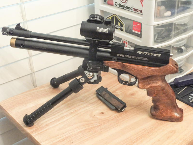

Here's the pp800 btw, it's a very light-weight gun. Pretty sure it weighs less than half of what my 1322 does. But like I said, the valve that's in it is intended for 22xx pistols. So, if you wanted a high-powered hunter, that would be the ticket. But shot count would be very low.
