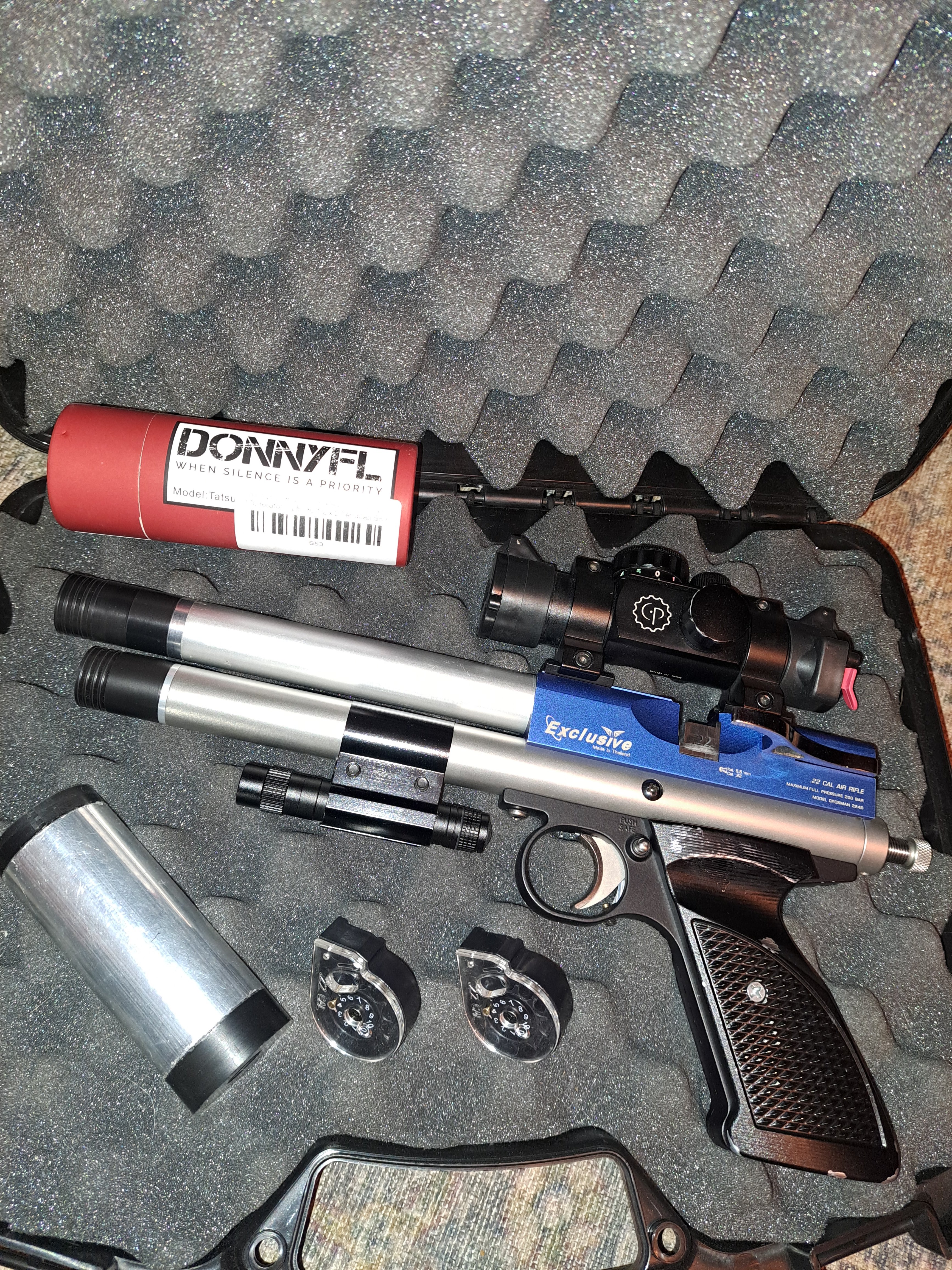

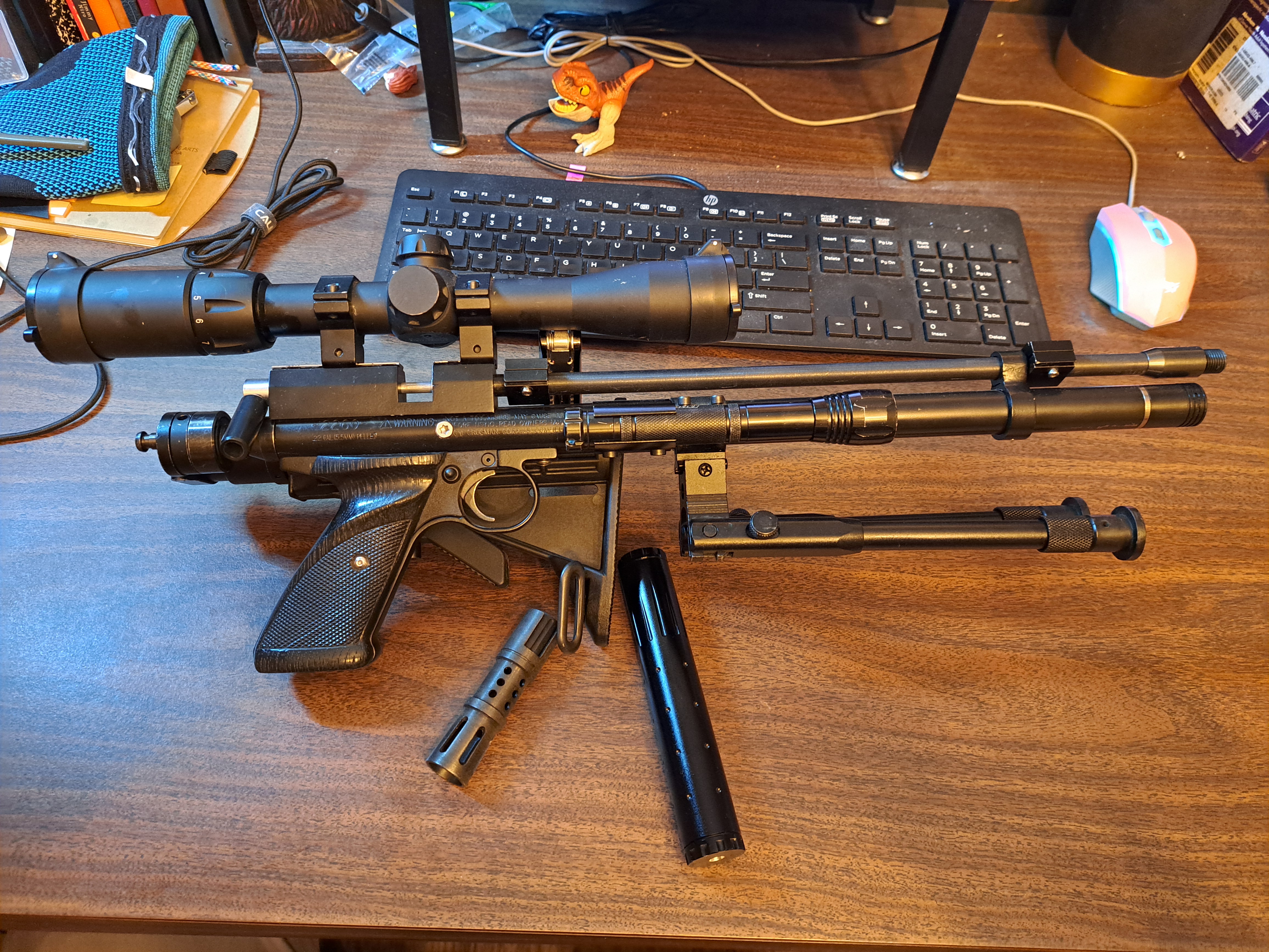

Pretty awesome stuff you've got there @Long_Gun_Dallas ! You know it's serious when you bipod your pistol haha Right now I have a red dot for my 2240 XL but depending on how this conversion goes I may look for a pistol scope. Looks like you have one of each.
I ended up getting the 2240 kit that is the one that @aroundlocks put in post #13 here. I also got the new barrel band since the pcp kit is bigger tube diameter than the CO2 tube so the oem wouldn't work. I wanted to keep the 2240 XL roughly the same size (pistol). Oddly, the ebay listing was like $10 more than the Amazon one but the ebay one claims to arrive a week and a half sooner. But I'll have to see.

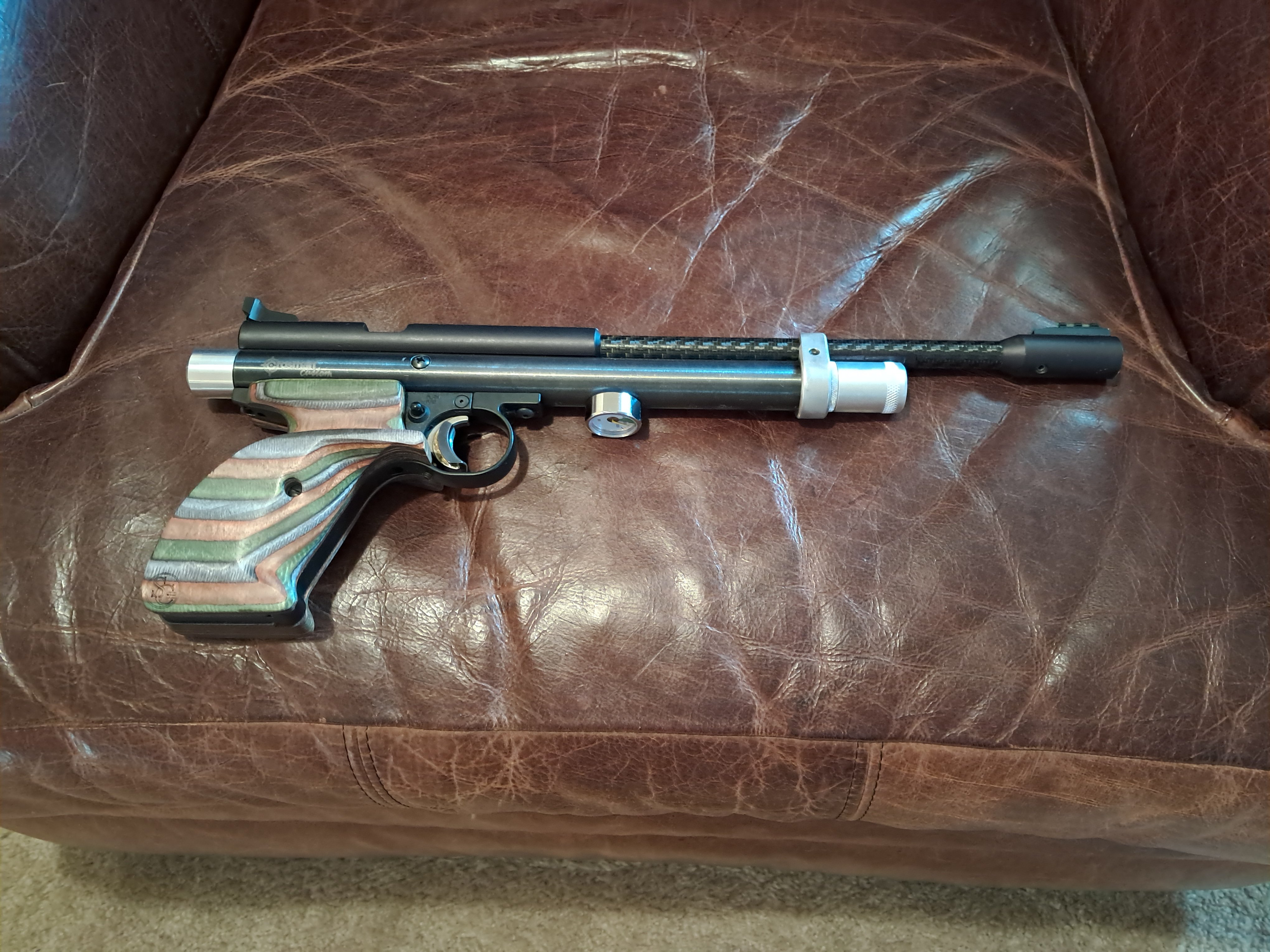

Damn man, wish you had purchased my PCP conversion. IIRC, I get somewhere near 750fps with my 22 caliber 1322 at 2000psi.
That's some great power, are those regulated? How many shots/ fill? Is there smaller one like the 2240? I wanted it to be a pistol still, 10 inch barrel is longest I wanted for that. After that length I'd just make a carbine, but it'd kinda be doubled up since I have a Notos.
9 or 8 good shots at around 16 fpe with the power adjuster cranked, or back it off for a few more shots. It is a hoot to shoot!
16 FPE is impressive with the 10" barrel! Is that with CPHP 14.3 or something heavier? You must have the valve timing down pat because I'd think it'd be hard to get more FPS out of the barrel since the pellet leaves it so quickly.
Also, how loud is it?? Normal 2240 isn't super backyard friendly so I'm guessing that's like a 9mm going off lol
Was that all custom work or did you find anything to convert "off the shelf"? Loving the CF tube for the barrel.
Yep, 14.3 Crosman. That is my first tube/valve pin job. I only have a drill press, so used the back half of a 2240 valve already tapped 8-32 for hi pac use and drilled pilot holes through tube and valve. Works just fine. She isVERY loud, must be shot anywhere but my backyard with the pa cranked. All parts used were collected and purchased over the years.
