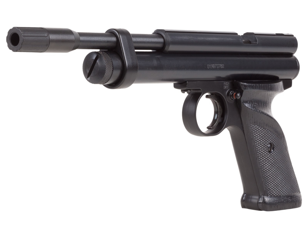

Stumbled across this today on Pyramyd Air’s website. It’s not on Crosman’s website though or anywhere else for that matter. A PA exclusive? Looks interesting.

well if you take a base 2240 and add a long steel breech and then a 1/2-20 adapter in the mix the price is fine or very good but you have no sight and even if you mount the rear LPA sight what are you going to do for a front sight
so is it special in any way, yes and no you can make one yourself
now if it had a 10 inch LW barrel and sights and a 1720 trigger assemble for X amount of money more then you would be talking
it like they had a good idea and someone yelled squirrel

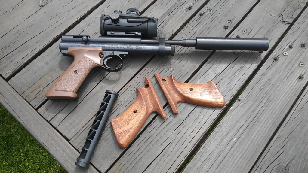

Mine came a few days ago. Has the new style grips, the typical gorilla trigger but seems of pretty good build quality compared to my 2300s. I also got the plastic baffle for a NP2. I had the aluminum tube to complete the can. At the same time I also ordered wood grips off ebay and a super sear. So far so good. I'm sure it will be fun as soon as I finish the grps.

My 2240XL came today and I have to say I'm impressed. Haven't had one in decades. Trigger is heavy, but not awful. Nice consistent (and decent - 500 fps with the Predator GTO leadfree 11.75gr) fps shot to shot. Haven't had a chance to do anything for accuracy yet.
Of course I've already spent more on customizations than the gun already. They'll be coming in the next couple of weeks. Nice wood grips, hammer spring adjuster, some trigger upgrades.
So my one critical comment - the grips look like nothing in the picture. Mine are fluorescent poo brown. I've never seen a nice shiny brown quite like it.

I added a 1701p trigger group and that is probably the best improvement. I wish there were a way to easily install a front sight, but I knew about that going in, so just have a nice red dot and still have a lot of fun with it. A Donny FL moderator quitens it a bit also.

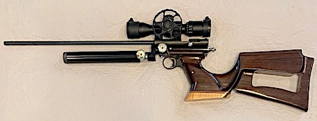

Slightly off topic, but I got my Crosman rifle stock for my 2240xl today...took only one minute to install it. Still waiting for my Red dot sight to come Fedex...should come sometime between Tuesday and Thursday, so I can't tryout my weapon yet.

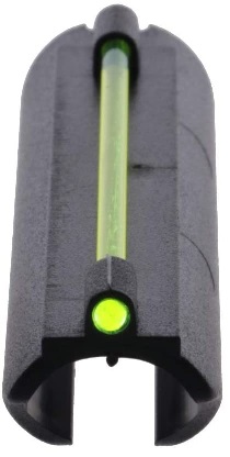

Question : Does anyone have tried a .410 or .12 gauge clip-on sight like this one on a 2240xl, would that works ?
