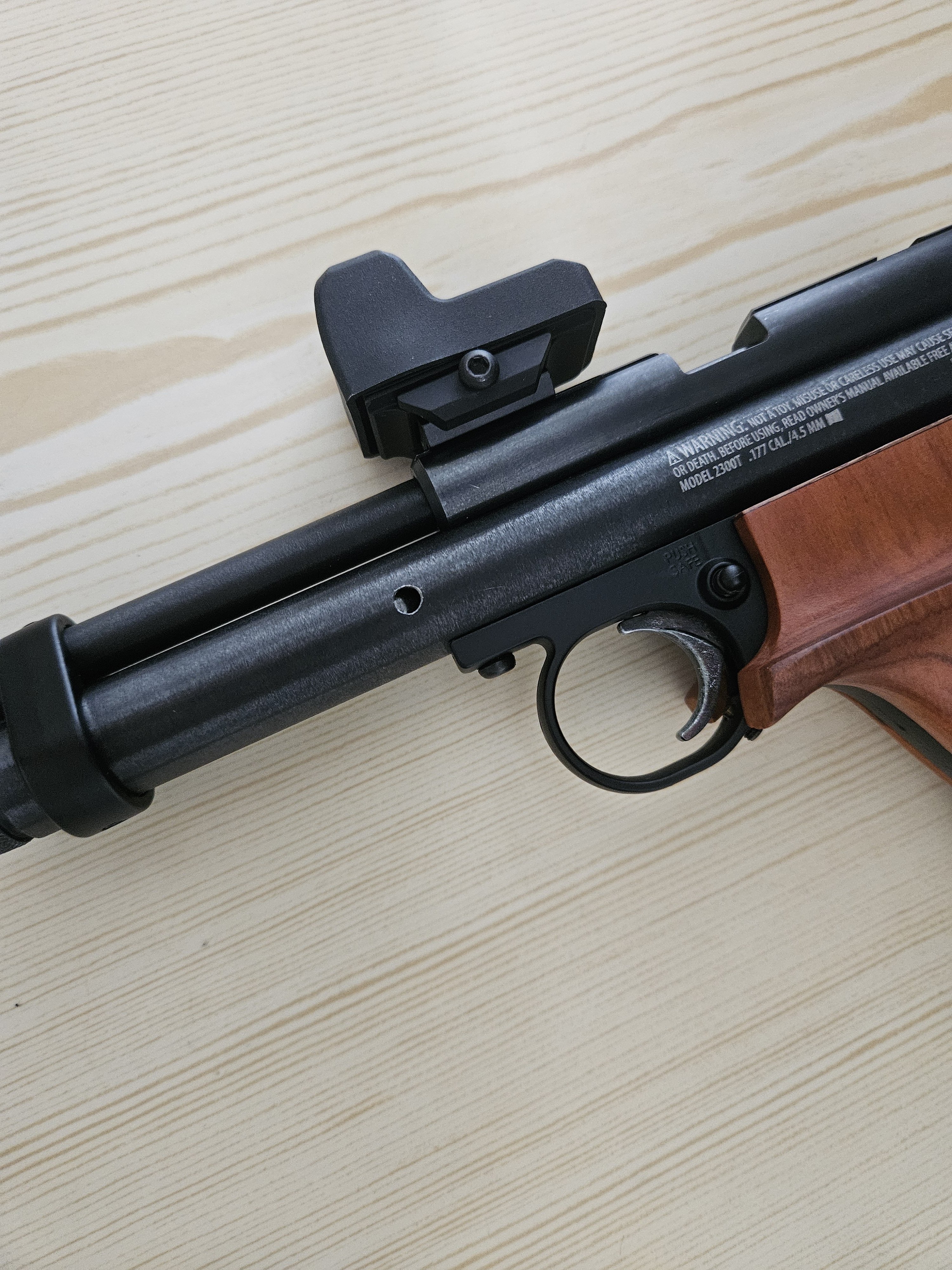

If you're going to drill a hole, make it one that can be reused. I got tired of stuck Co2 cartridges in my 2300T so I drilled a hole in the tube to allow a screwdriver or whatever to pry the cartridge off of the seal.

Luck. I always put a drop of oil on tip of cartridge and still had them stick in two different guns, which I disassembled to remove the cartridge. I polished the tips of the piercing pins on those guns as well as some others I was building up and have not had any further problems. If I do I will probably measure and drill a hole in the side of the tube holding the cartridge so I can reach in and push it loose, like the Diana Airbug which already has that feature built in.

don't drill holes in the tube my God
Mike, just curious as to your objections here. As you surely know, Diana Chasers/Airbugs have this hole already there in the air tube just for this purpose (freeing a stuck cartridge), though it is more elongated than round. Are you concerned about mechanically altering the tube, or is it more about the cosmetics of the drilled hole? Obviously, the hole would have to be very carefully located/drilled but I really don't see the problem in doing so. It seems like a very practical mod to me...but then I'm not the brightest bulb on the tree either:)
Interesting I didn't know the Diana Airbugs have a hole. I'm in the camp of not drilling in the tube why you ask?? For me its just manly cosmetically and also its a way for particles to get inside the tube area. Thats my .02 cents :)
