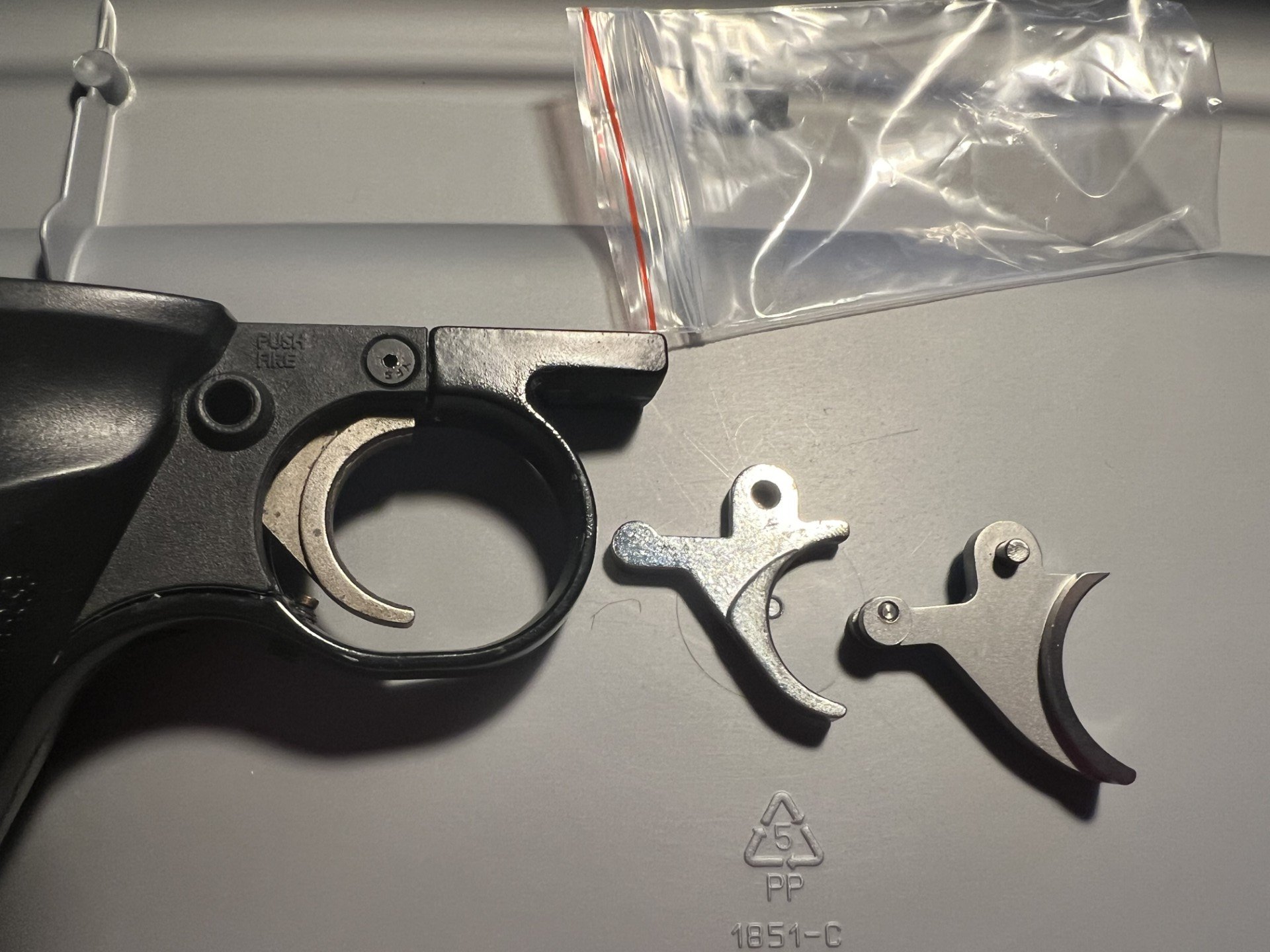

Crosman Crosman 22xx platform, flat or flatter triggers?
but neither the trigger shoes or TKO 1911 style trigger will work in the 1701P grip frame
the 1701P trigger is wider and the trigger is different than the 2240 trigger and all of that was though about in my first post

no i have 3 triggers here one in the 1701p grip frame, one a stock 2240 trigger and a roller trigger from Cothran
you will note how the Cothran trigger is a bit straighter and i do believe he has one for the 1701P but you would need to email him
now the frame dictates the trigger shape but you could add 7 to 10 mm of material to make the 1701P trigger straight and or less deep
a mock up of a piece of plastic or wood as a test would be easy and then a piece of aluminum or steel could follow and a person with a 3D printer could make one very easy
