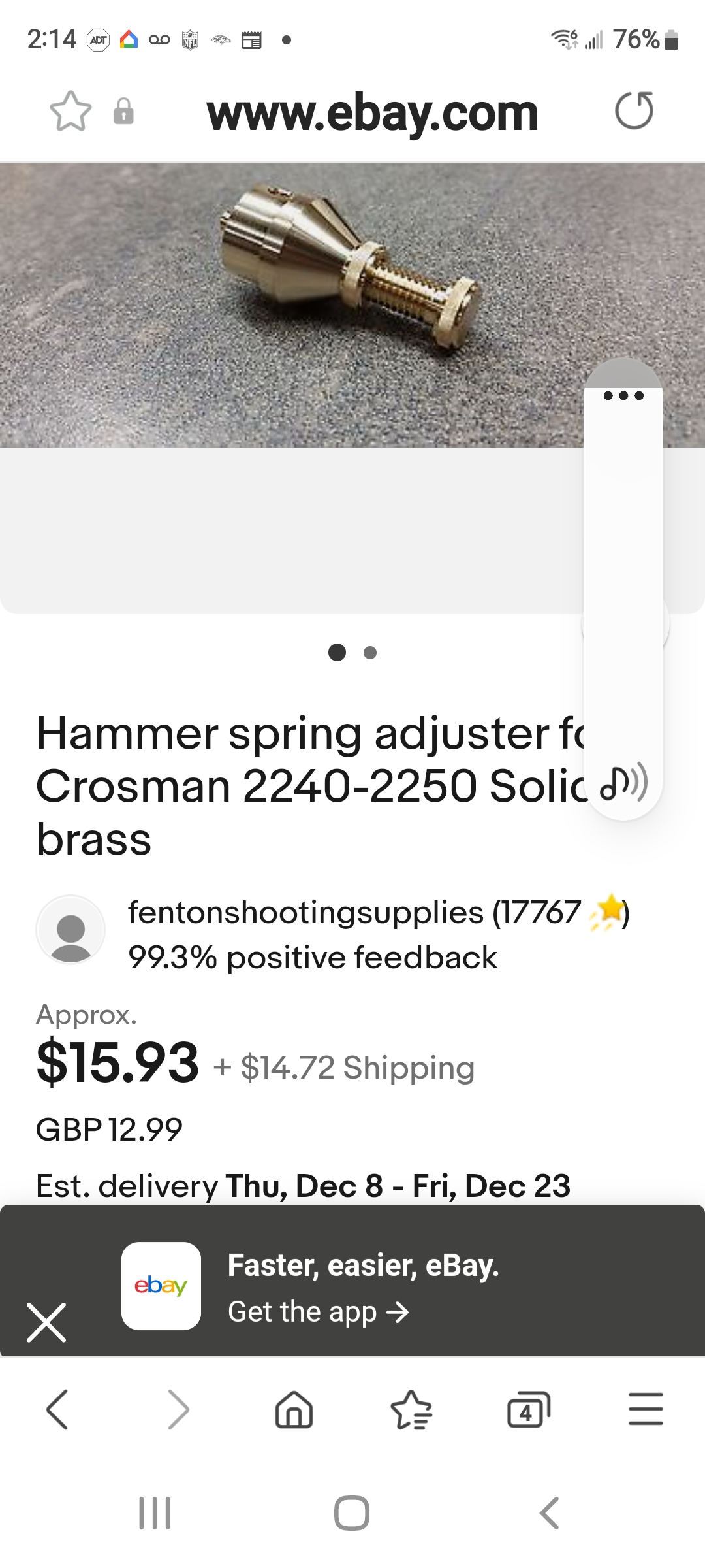

Simply getting the hammer spring tension adjusted properly will go a long way toward quieting the report. Two additional benefits are high shot count and less susceptible to self-cooling that would otherwise cause a declining velocity.
If you want to carry it a step further, make a simple SSG to produce a free flight hammer.
Reactions: maxtrouble
@nervoustrig I read an interesting thread next door about just how over sprung the 2240 is for the barrel length. He was able to back the spring off a lot and conserve CO2 without losing velocity. As I recall he didn’t see significant effects until a 14.5” barrel and beyond, kind of in line with what you’re saying. Haven’t had a chance to test for myself yet but guessing it will be similar with the 2300.
Yes the 2240 is very wasteful of CO2 in stock form. Unlike the 2300, it has no adjuster so the user is on his own to add one or take some other measure like an SSG or bstaley stack. I could be misremembering but I think the adjuster on the 2300 has sufficient range to get to the velocity knee with the short barrel.
Will let you know when I get a chance to test.
