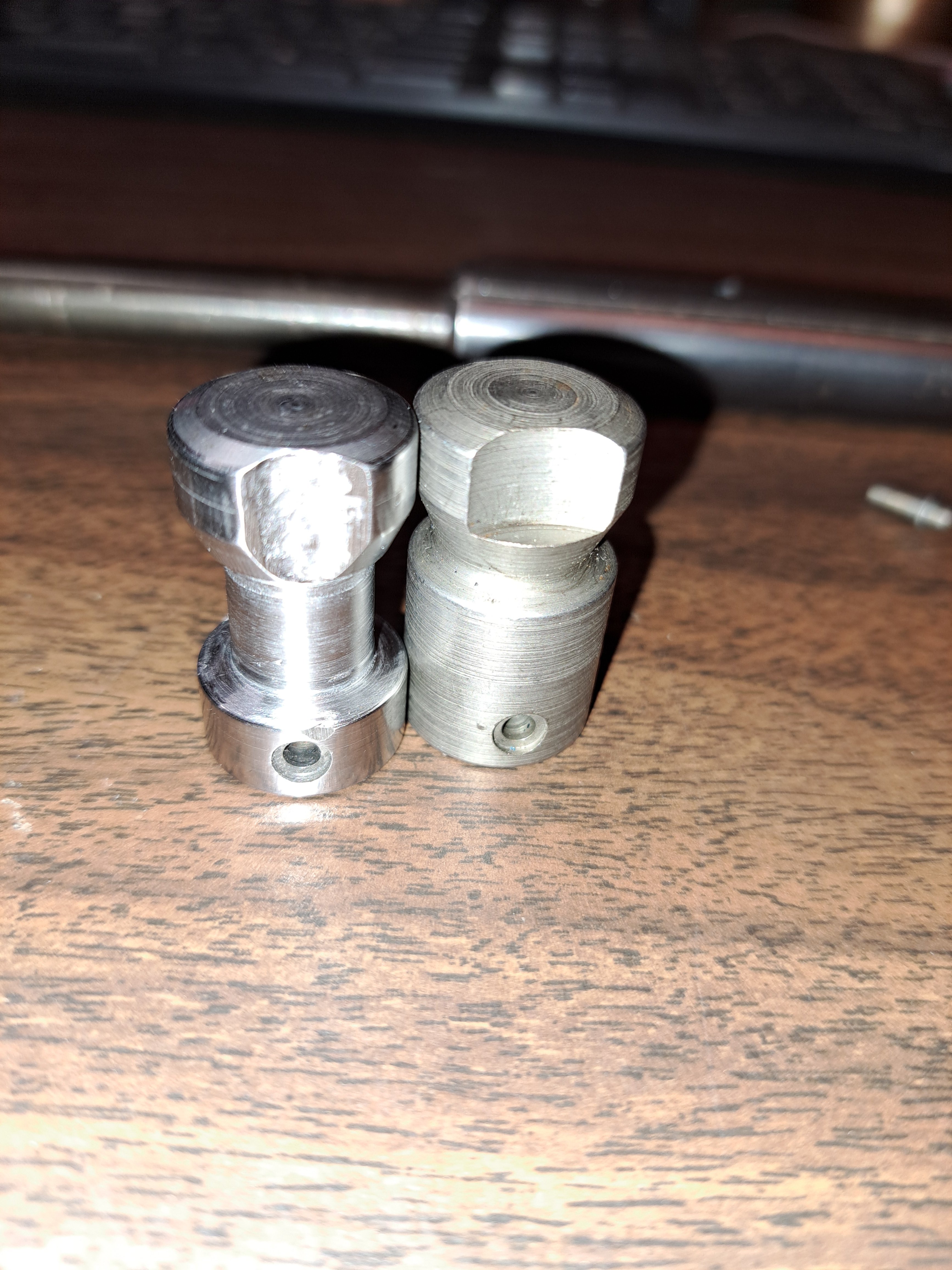

Transfer port goes long end up. I have bought several used and discounted 13xx's with people putting them in upside down and selling them as parts or not working. This will cause a velocity decrease if installed wrong. All my builds have steel breeches. It's the way to go. You can also get small washers for the bolt.

Transfer port goes long end up. I have bought several used and discounted 13xx's with people putting them in upside down and selling them as parts or not working. This will cause a velocity decrease if installed wrong. All my builds have steel breeches. It's the way to go. You can also get small washers for the bolt. View attachment 542445

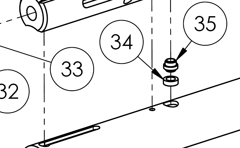

Small washers for the bolt? New to the Crosman game, please explain.
Reactions: airgunner53
Yes, some people sale small washers that go under the tiny 4-48 breech bolt. You can find them in the classified or on ebay. Never used them as I bought aftermarket high strength bolts and turn them to fit the breech. No fear of stripping them. If you use the rear mounted breech bolt you need to use a notched hammer like the 2240.
