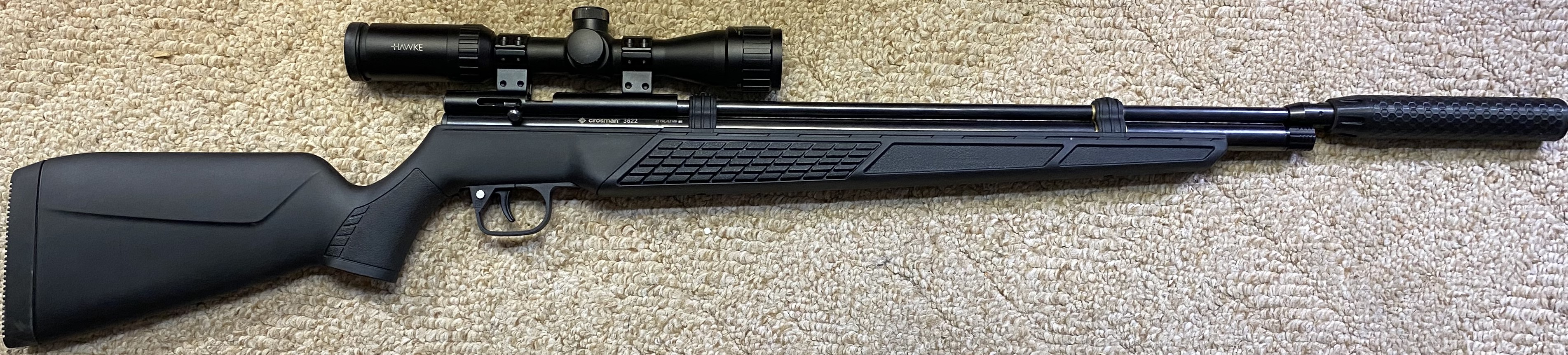

I am very happy with my Crosman 3622. I have worked on the trigger, valve and barrel. I installed a .177" transfer port and bored the valve and barrel to the same size. It gets 20 shots around 18 ft/lbs with 16.01 JTS pellets. The trigger is nice and accuracy is good out to 30 yards, for sure. I pick it up to pest around the house and it is so easy to pump back up. I added a Buck-Rail fill cap, adaptor and modular moderator. Today I ordered a Magnum Air power trigger, just because this gun deserves a metal trigger now. I put brass shims around the barrel bands, and re-crowned the barrel while trying to get accuracy, but I think the JTS pellets might have been all it took. While I am pleased, I am wondering what effect opening up the end of the valve would have. (picture stolen screen shot from Al's Airguns YouTube channel.

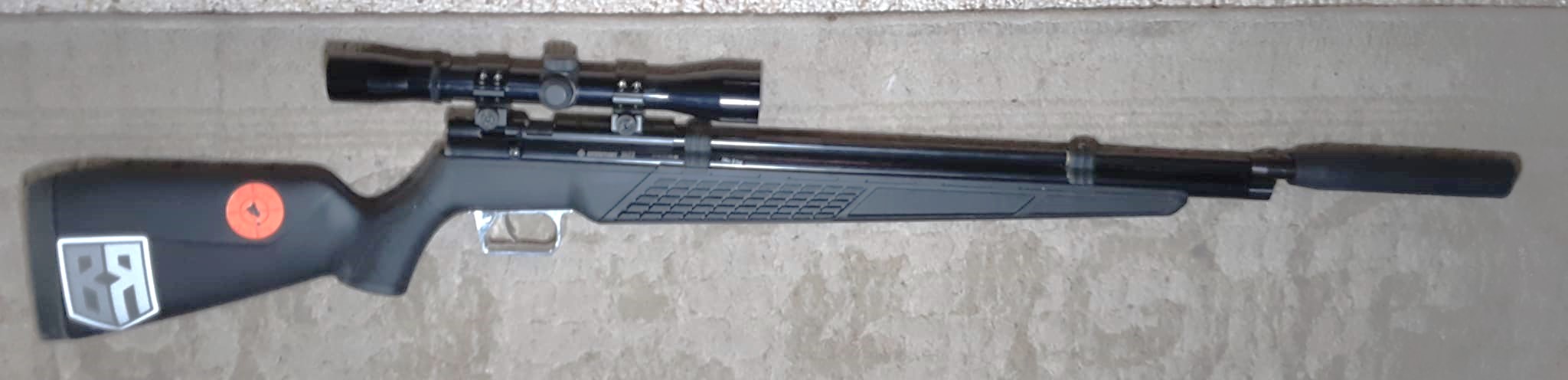

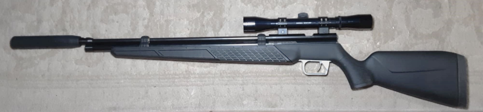

I was able to break into the Bushnell scope and play with the objective lens adjustment. It now focuses well from 15 to 50 yards and is moved to the 3622. Magnum Air Power trigger group installed. I still want to add a third adjustment screw. The weight is now 4lbs. 15.7 oz. with scope, aluminum breech, adaptor and silencer, trigger group and scope.
