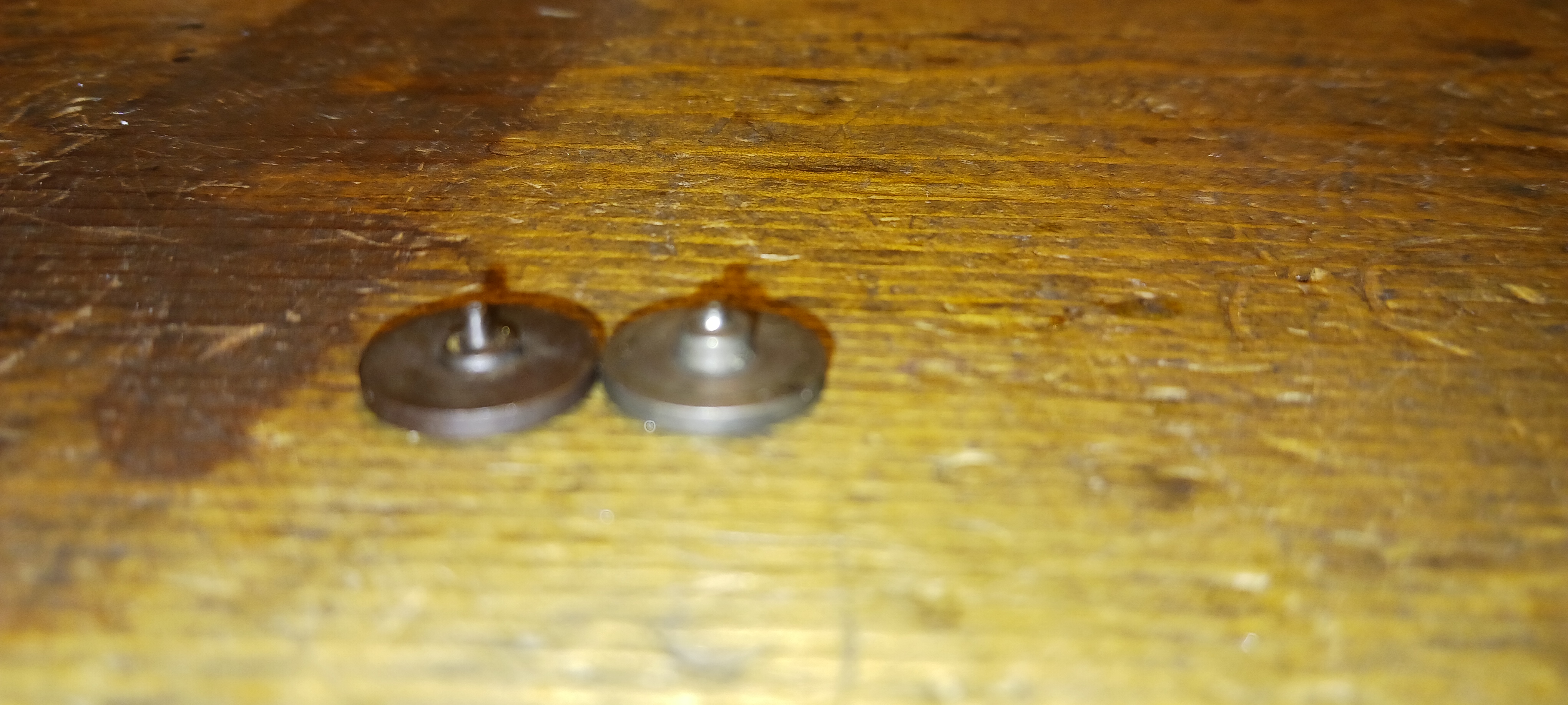

Can not get CO2 capsule to be poked by the newly seated piercing pin .
The seal kit is newly installed.
Any help would be appreciated.
Did you replace the old piercing pin with a new one. The old ones are shorter. The new seal is thicker. Left old right new.
