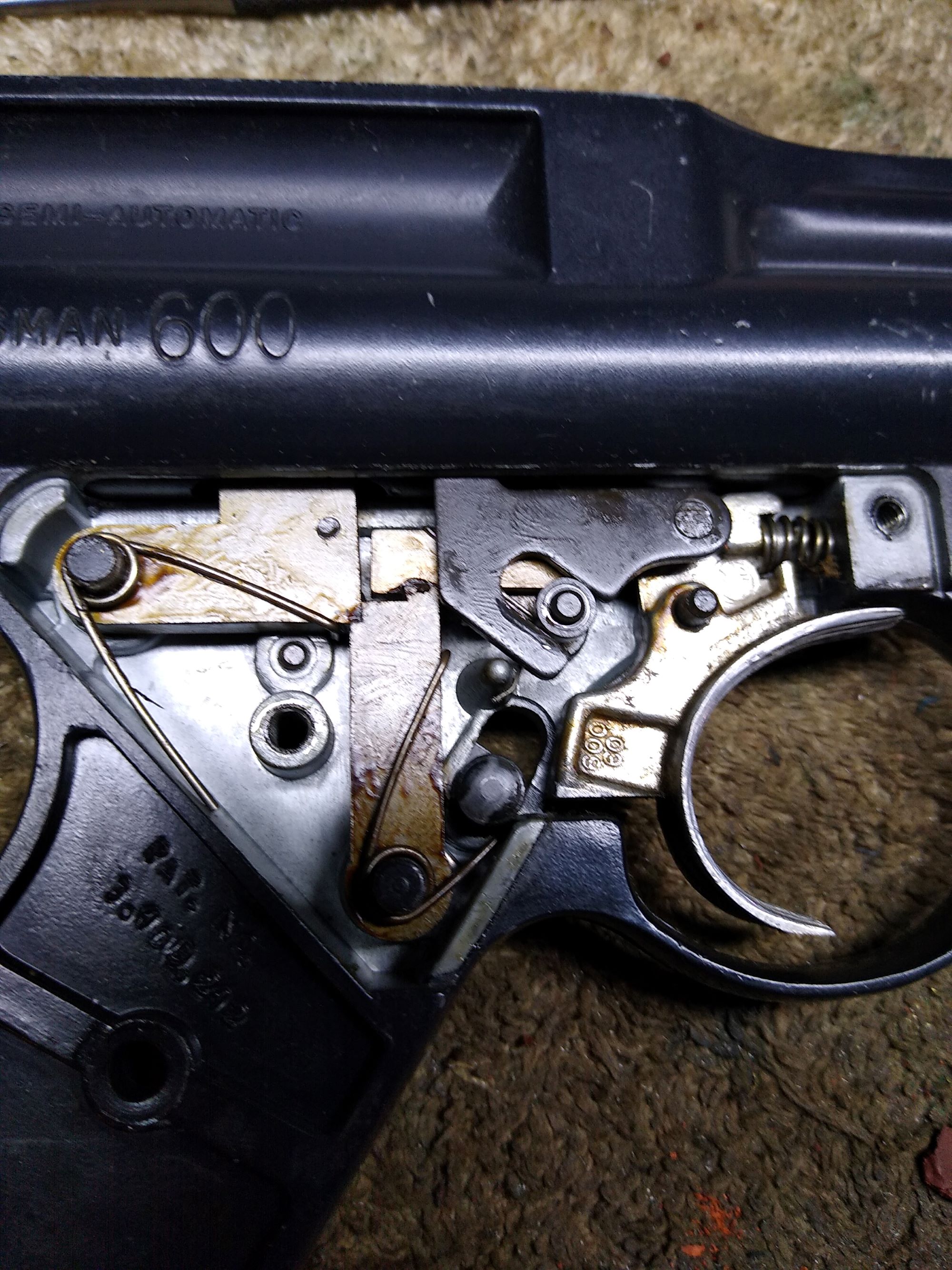

Heres some pictures
Your 600 doesn't have any third variation parts in it. When Crosman adopted the piercing pin tube cap, they added several additional parts in the trigger/sear assembly to prevent the gun from accidently firing while the user was slapping the knob to pierce the CO2 cartridge.
so just a third variation pin for the cartridge...correct?

OP, that is a very nice C600. I don't believe that serial number are an accurate means to to date a 600, but I could be wrong. There were three variations and the first & perhaps second had the "short stroke" safety slot and corresponding notch in the grips. The third variant, and perhaps second has the stop and the stop roller in the trigger group.
very short stroke safety...
