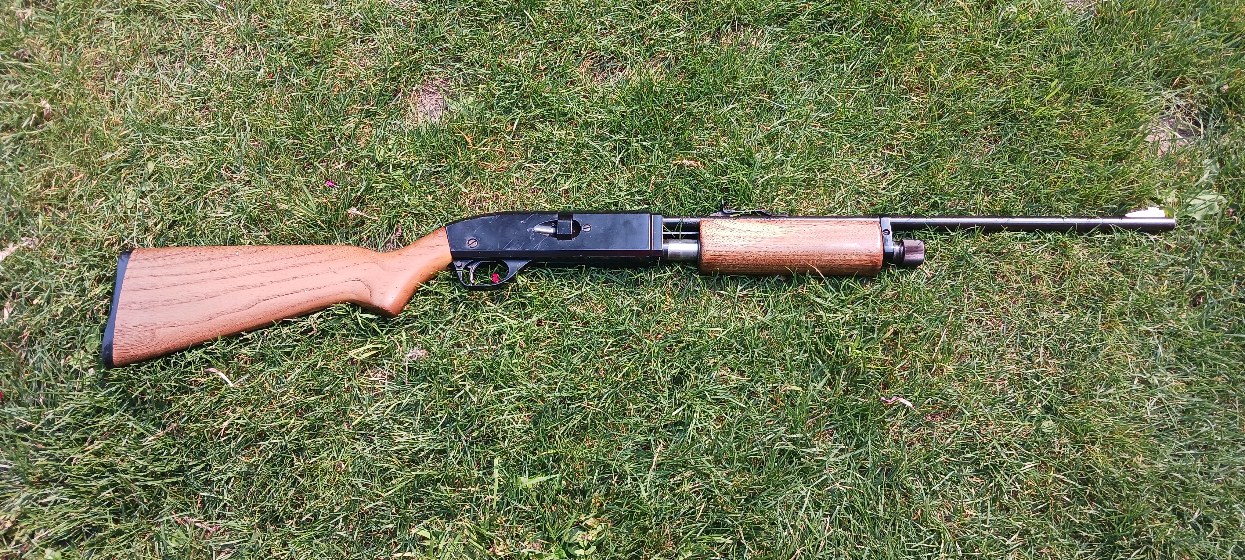

I picked up a Crosman 622 a few weeks ago. Today I cleaned it up. Installed a co2 cartridge, charging it it held. I believe it had already been rebuilt, judging from its condition. So spend some time playing with it at 40 yds. Super fun pump action 6 shot .22

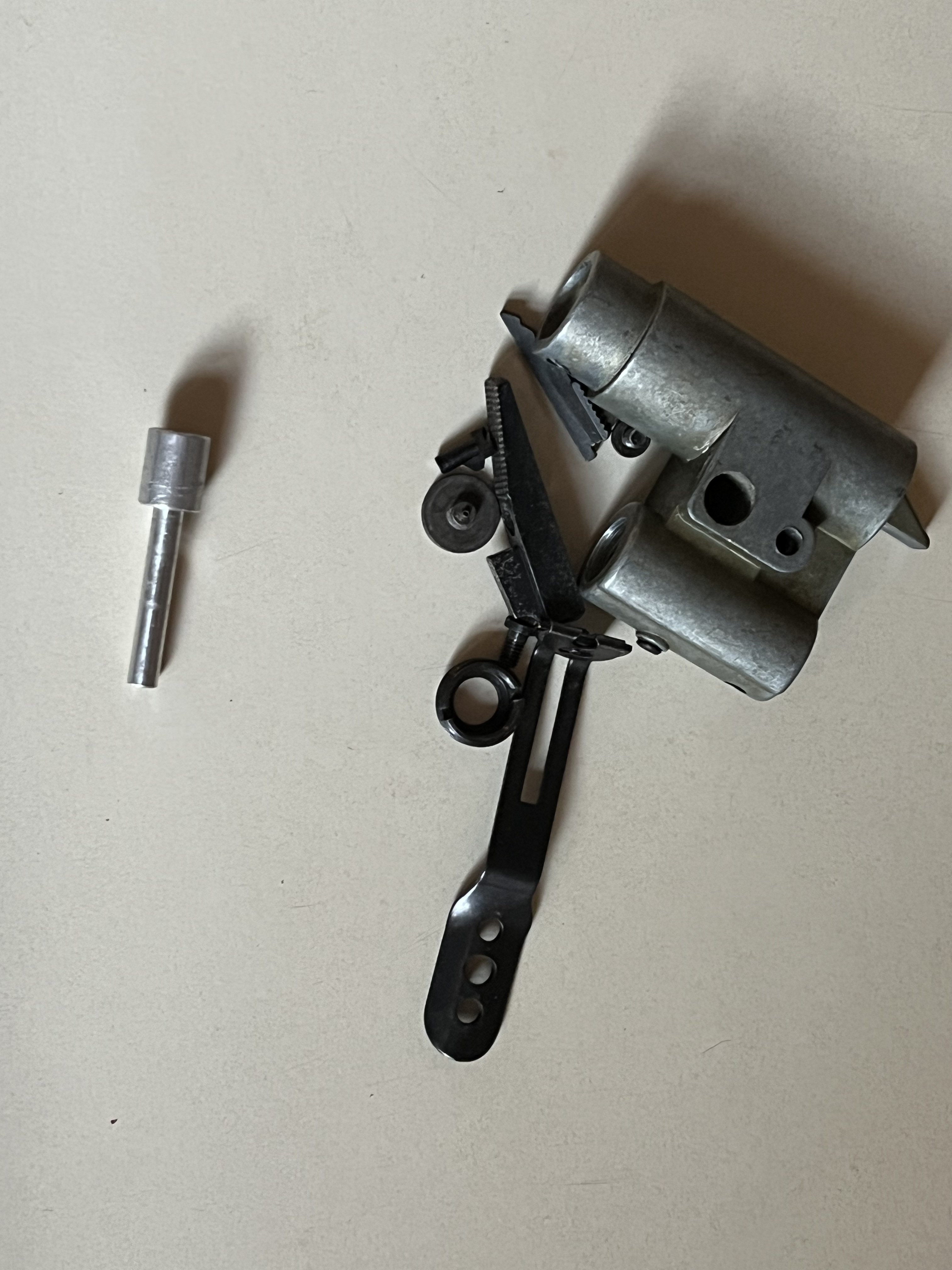

I made a sleeve so I can bulk fill mine. Lotta room for gas in there. Then ground 1/2 the sear away and got a decent trigger. Pinned the valve body and cartridge tube. A necessary modification. It's a fun gun.
Some of them wave warped die cast receiver halves and the barrel wiggles. Magazines are expensive if you find them. Haven't played with mine lately. I have like, 3 and some parts. Good luck putting one together without my home made assembly pin
Yours looks nice.
Aluminum pin keeps things together during assembly
