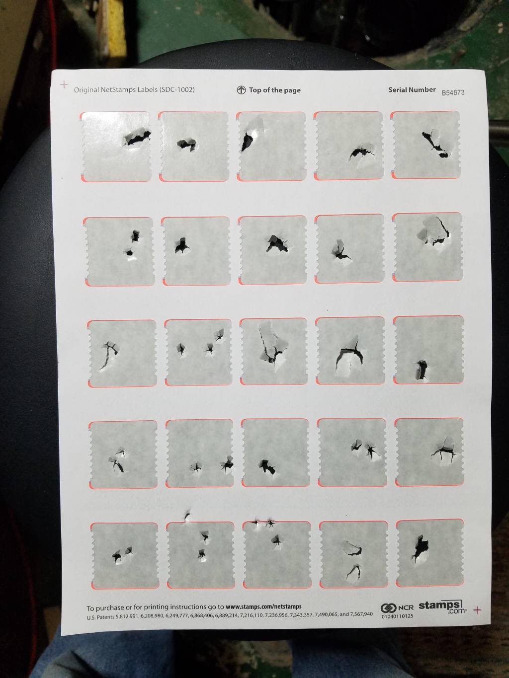

Just picked up this rifle and have put about 300 rds. through it. I cleaned the barrel with felt pellets before shooting it for the first time. Cleaned it again when it didn't group. Tried Crosman Premier 10.5 and regular, H&N Terminator, RWS Meisterkugeln and H&N Barracuda. Same 1 3/4" pattern at 33' regardless of pellet. I really want to like this rifle, what can I do? Costs around $60 shipping to sent the rifle back to the dealer. Is there anything I can check with out taking the gun apart? Thanks for the replies.

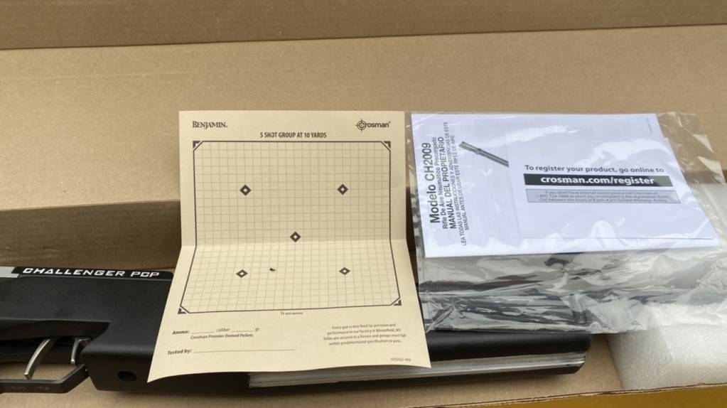

You should get 1 .22 hole at 20 yards with that gun. Clean with patch worm and put 30-40 rounds in to season it. Don’t clean it too often because it’s really not needed. Brown box domed pellet would be most accurate and then 7.4 grain pointed are really accurate out it too. Mine came with this card and it is that accurate.
