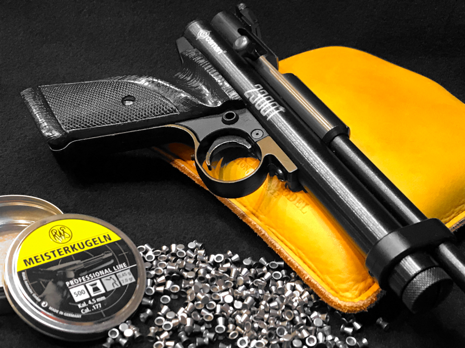

I have a question for the Crosman CO2 pistol owners out there. I have a 2300S that I've shot 1300 pellets, a couple of weeks ago I noticed a very slight ticking/dripping noise coming from the tube there is no issues with the operation of the pistol it shoots very well. To hear the noise you must put the pistols tube up to your ear its that slight. I contacted Crosman and spoke to a tech and he said that's not normal and stated it might be too much oil. I put a drop of Pellgunoil on every cartridge as instructed per the instructions. The tech advised putting oil on every third cartridge. I've done as he recommended and I'm still hearing the sound :unsure:. I don't understand what's causing the sound:unsure: the pistol works fine. I asked the tech what would cause this sound since there is no pressure and he said either too much oil or the spring??:unsure:. Is there still pressure inside the valve after you remove the cartridge? I wouldn't think so.. He said to send it in and they would check it, I really don't what to go through all that especially since the pistol is working fine. So for all you Crosman CO2 pistol especially the 2300S owners out there have you notice this slight sound coming from the tube after removing the cartridge?? You most likely would have to put the tube near your ear to hear it.
When you first remove the cartridge the tick/drip is about every 2 seconds. The crazy part is I would check it hours later and its still doing it however I would say its every 10 seconds and would progressively get longer between the tick/drip noise until it finally stops but can take up to 24 hours and then you don't hear it anymore. I know I'm being anal about it but inquiring minds what to know???:unsure:

The pistol functions perfectly its that little tick noise. If there was a way for me to record it and post it here so that you could hear the sound so you know I'm not hearing things I'd do it.
