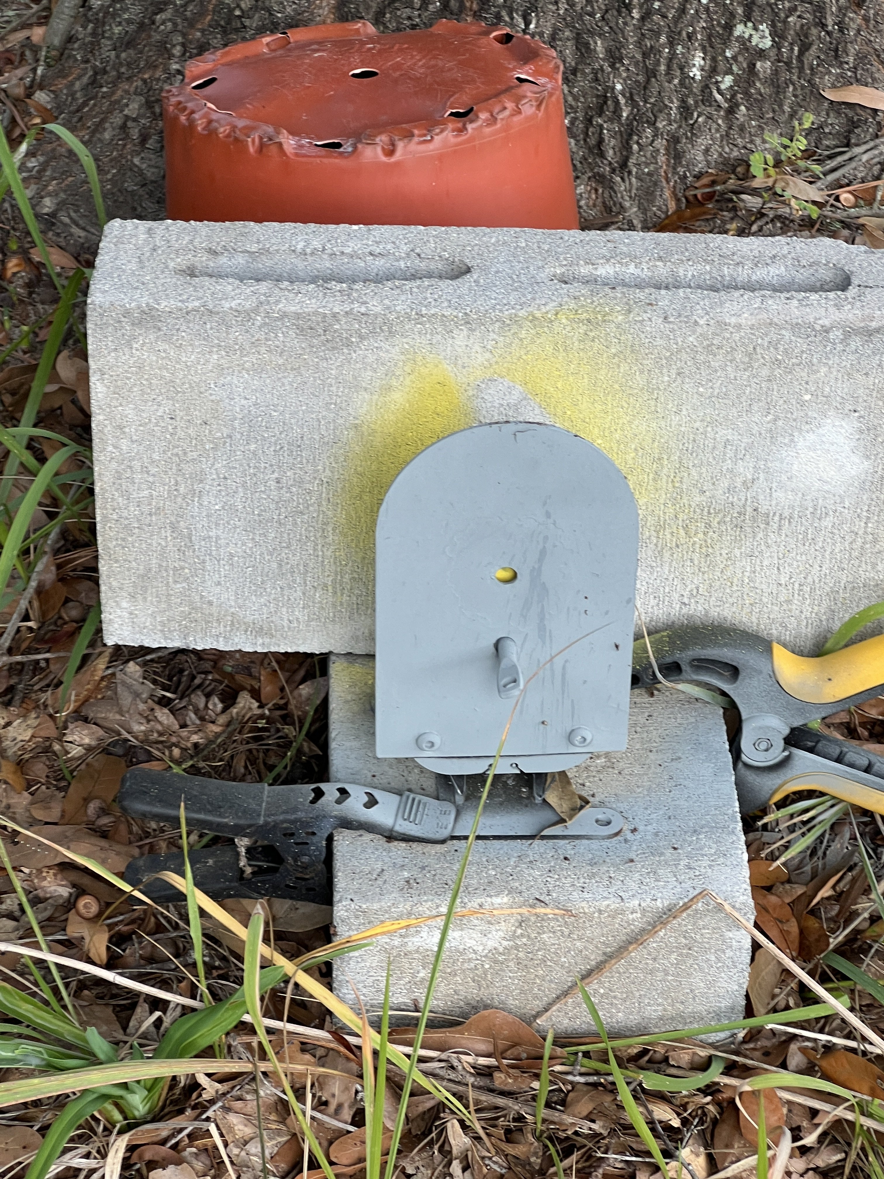

I have many quality target gamo face plates - and the chp's def ding and ping the area around the kz into submission; the smaller the kz the more noticeable as the direct hits are in a very focused way; the pic is a Quality Target Gamo FP
I'll take some pics of what the CPH's do to a gamo paddle as it's really mostly the paddle getting destroyed.

if i wasn't looking at the damage on very new gamo targets, i wouldn't mention it. But it's there. And it showed up immediate to the use of CHP pellets. I like the info for replacement paddles, i use Quality Target faceplates already but didn't know they had paddles.
