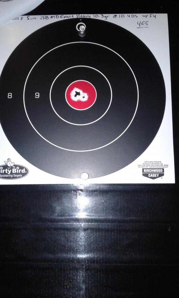

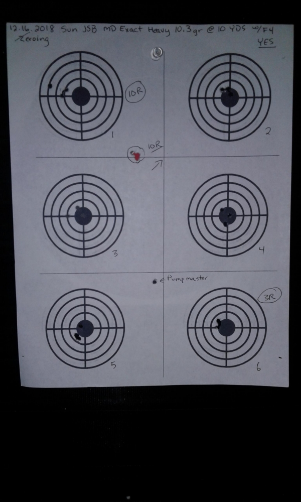

I bought a F4 over a year ago like the OP did. Once "broken-in," I found that H&N FTT's at 4.52mm sizing and also JSB heavies shot excellent through it. Mileage may vary depending on how your barrel is in yours. After 500 shots, the lockup on the barrel went to crap quickly and needed some TLC.
