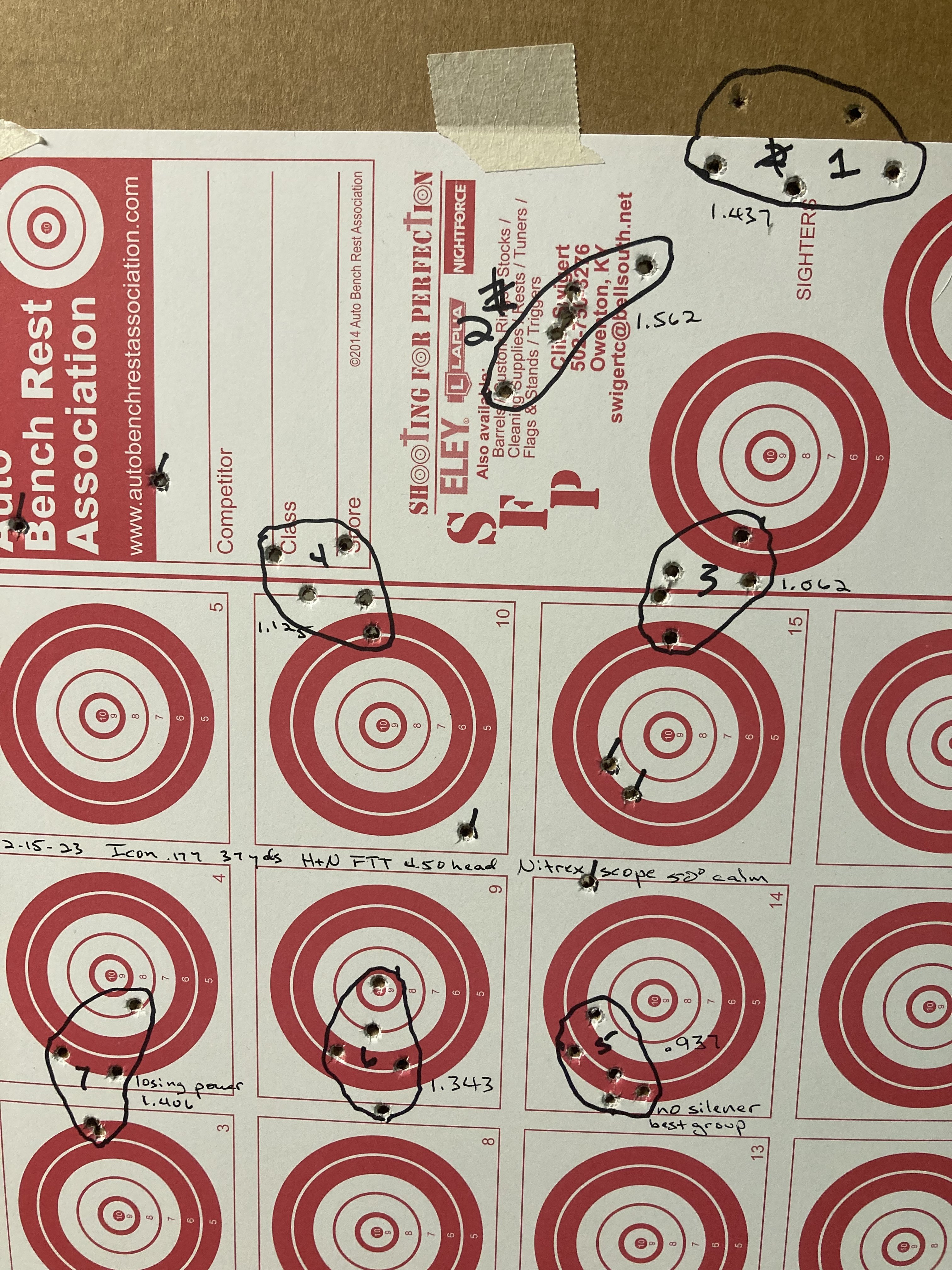

.177 results at 37 yards. 50°, very calm, just slightest bit of breeze - almost perfect conditions. Lousy, but at least consistently lousy. (disregard shots with slash mark - that was from something else) Averaged a hair over 1 1/4” for seven groups. Single best group was #5 at .937” when I took Buck-Rail moderator off to see what effect it may be having on groups. WAY too loud to shoot in my neighborhood without it. Couple other groups were very close to 1 inch, so #5 may have just been a lucky one. By the end of last group, pressure had dropped to a little over 1400 and I could tell pellets were starting to drop. That was actually at 40 shots total. (shot five at prairie dog) Scope/rings combo I have are coming off to be replaced with something else, I was TOTALLY maxed out on elevation and windage to right - not conducive for best scope performance. I also need to do something about a better shooting bench - shooting off a kinda shaky patio table right now. Sorry for the long post, but I have no one else to share this with. I love you guys! *snif*

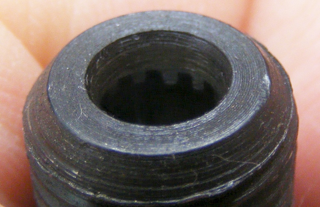

I ordered a .22 cal that I'm planning to do some work on and then give as a gift. When it arrived Thursday, I checked the crown and although the lands are beveled to different lengths:

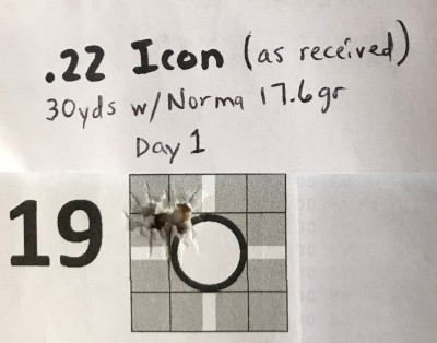

I'm not seeing any pilot damage to the lands further down so that was a pleasant surprise. To get a quick baseline, I cleaned the barrel, mounted a scope, aired it up, and headed outside to test a few different pellets. At 30 yards, CPHP and Daisy hollow points were each printing groups in the 3/4" to 1" range which isn't bad at all for these pellets in a completely stock budget PCP. However when I grabbed the tin of Norma 17.6gr domes, it promptly turned in a group measuring 0.195" CTC, well under MoA:

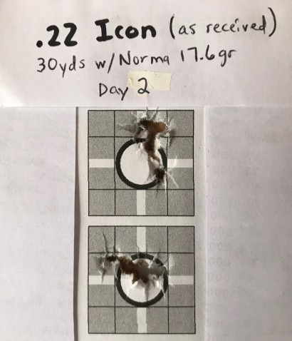

The next day I tried a couple more groups with the Normas. Not as magical as the first (0.490" and 0.460") but still exceeding my expectations for a $130 PCP in OEM form.
