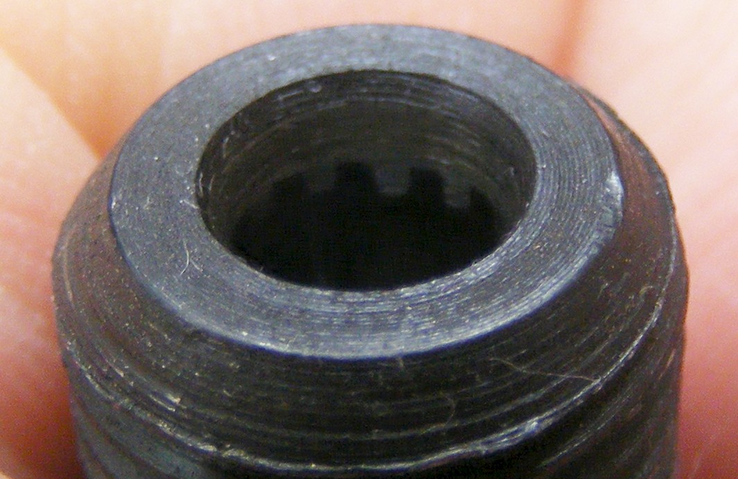

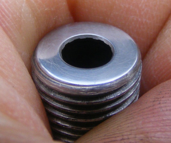

The barrel on my .22 Icon showed good promise so I decided to give it a little attention. First up was to remove the front sight. I was expecting it to put up a fight so I made a simple slide hammer with a scrap of wood. Before warming up the sight to soften it, I gave it a couple of moderate strikes with the slide hammer and it popped right off. Turns out it simply had a brittle adhesive holding it and a flat for indexing.
Starting at the leade, I used a generic Cratex point and wet/dry sandpaper to break the sharp step in the rifling. Then I poured a cast lap and worked the bore. There were two tight zones at approximately 25% and 75% of the way from the breech which took a bit of work to blend out. Here's a pic of the lap after the job was done.
Then it was time to deal with the irregular factory crown
After cutting it back and recrowning:
Then cleaned the bore and reinstalled the barrel and pulled some patches with Johnson's wax. Waited a bit for the solvent to evaporate from the wax, then grabbed the Norma 17.6gr domes to shoot some test groups. It seems to have responded nicely. The first 3 groups at 30 yards measured 0.22", 0.36", and 0.19". Average of 0.257" or 0.82 MoA.
