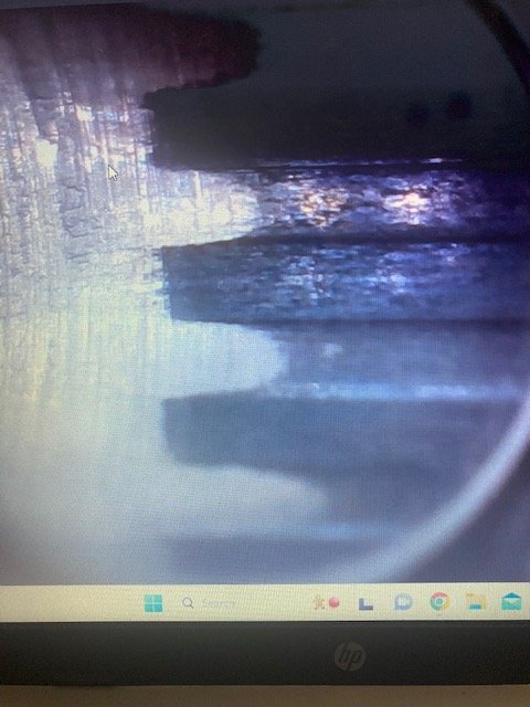

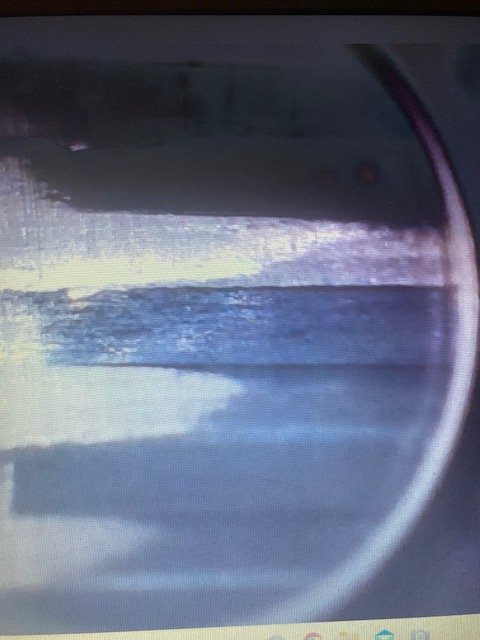

For those who have received theirs already, does it have the scored rifling near the muzzle?
If you can comment, please indicate whether 177 or 22.
A couple of borescope pics of .22 I got today, sorry about picture quality. Remains to be seen how well it will shoot - I've seen barrels that look like railroad
tracks shoot lights out.

Awesome, thanks for the borescope photos. Are both of these where the rifling transitions to the crown? Image 2 looks better suited to be the leade, given the shallow angle bevel on the lands. However if we are looking at the crown, the irregular length of the bevels would compel me to chop and recrown. The good news is I’m not seeing any scoring on the lands which means not so much material has to be removed that it would adversely affect the threaded stub.

So the pictures didn't look pretty or smooth to me but I don't know what I"m looking at/for. Could you show me what a good bore would look like.
I would, if I had anything with a pretty bore, lol. Seriously, these bore scopes will make you think “How in the heck does this thing even shoot!?!” I have an ancient Mossberg .22lr with a bore that looks like moon craters - and it will honestly shoot 3/8” groups at 50 yards consistently. Sometimes better if I have my tongue sticking out of my mouth in juuust the right position.
lol good to know i dont need to fixate on this!
