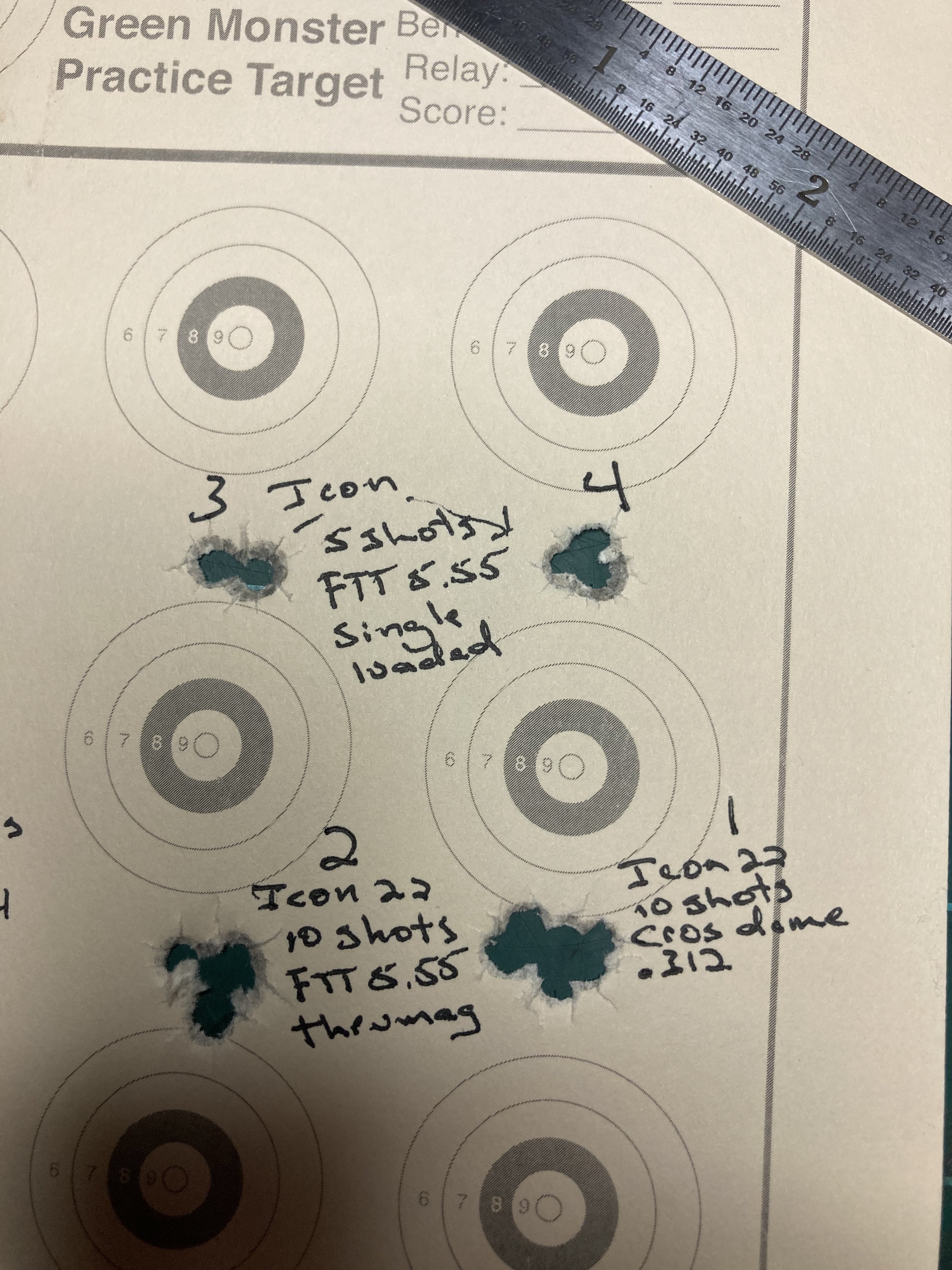

First let it be said I'm no paper target shooter. 50 yards. I was really working hard on the trigger pull getting it half way and then finishing.
Well I keep having shots after 25 start going north and sporadic. I know it's a 30 shot capacity but maybe I need to stop at 25. I'm not yet convinced shots 1-10 are much good either. 30 shots and gun is sitting at 2000 psi.
It seems shots 10-20 are the best.
There are 4 holes at top clustered that was 20-25. Then Going down to next target blamo this is shots 26-30
It seems shots 10-20 are the best. View attachment 414723

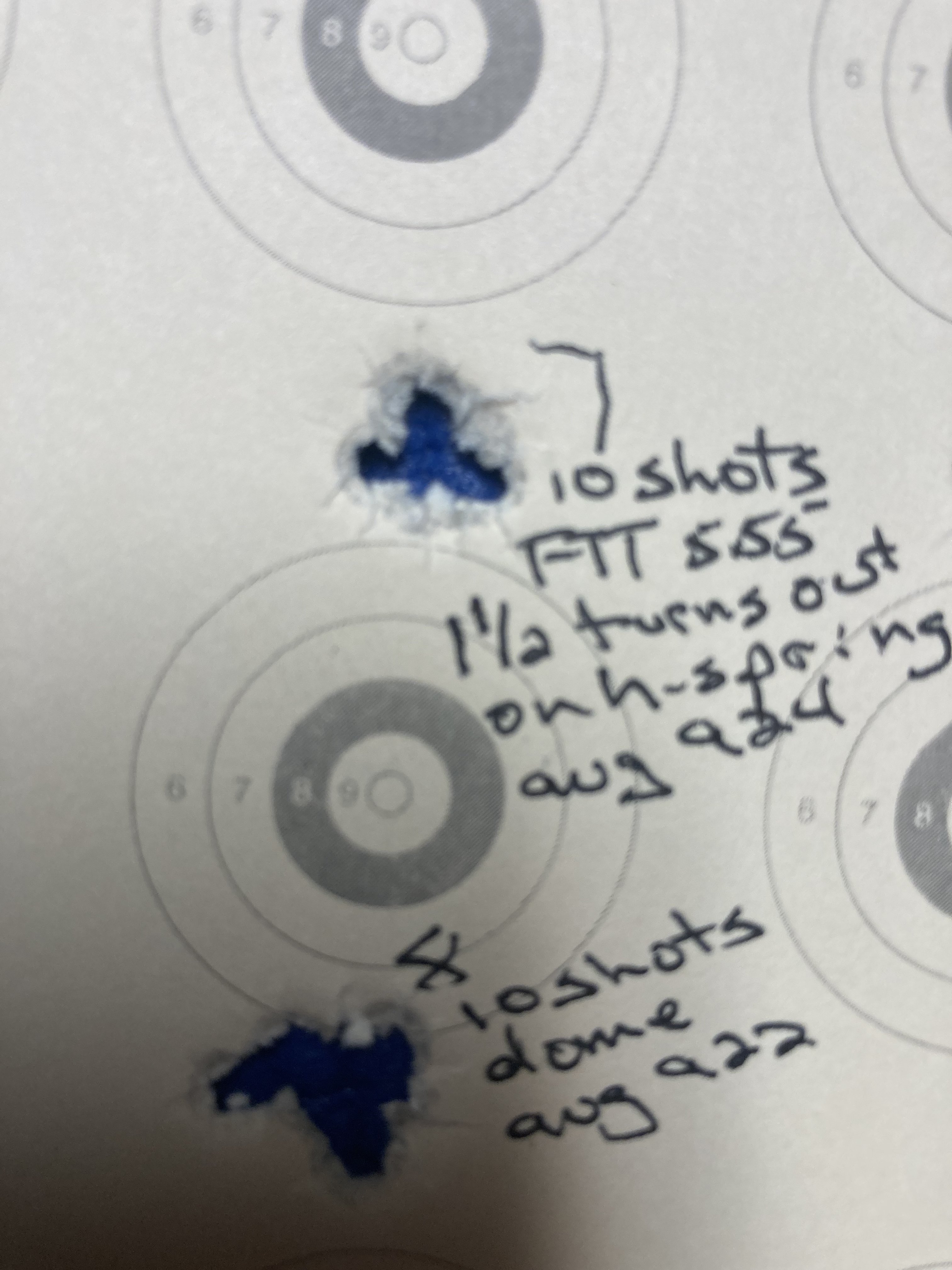

Good call on the FTT 5.55 head! On group #3, when I started single loading vs using the magazines, the first three shots were exactly in the same hole! I even stopped and checked my bore to make sure pellets came out! Sweet!

Why, 50 yards of course! Or was it 100? 🤔. Just kidding, this was from the comfort and convenience of my basement, with a very stable setup and no weather to deal with. Big scope set on 15X. End of my bench to target measures 33 feet.
How fast is it shooting the FTT's?
Right now, after turning hammer spring back 1 1/2 turns thanks to @squakers advice, they are averaging 924 fps with an extreme spread of 45 fps on a fresh 2800 PSI fill. This is the 10 shot group I chronographed to get those numbers. I know nothing about how to tune these things, so it’s a real learning curve for me. Taking lots of notes as I go, and hope to understand them when I’m done. lol.
