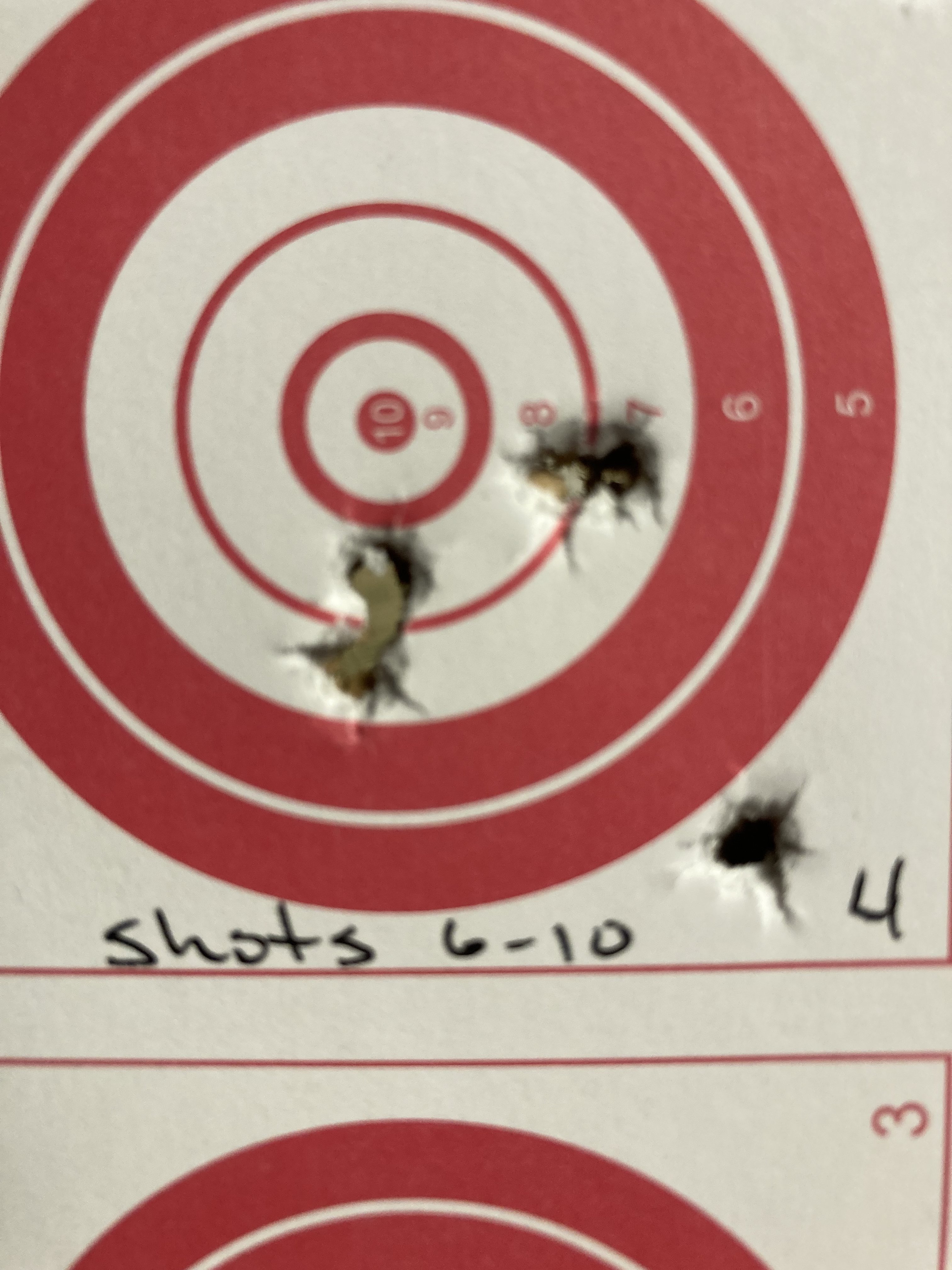

Top left group looks great. When I did shoot mine outside (37 yards), I fired two groups with the Crosman hollow points and quickly switched to the domes. Seemed like the HPs were very erratic - at least for me. The H&Ns load very smoothly through magazine. I know what you mean about single loading, I actually use two fingers (one on each side of rifle) to load singly. Going to keep playing with tune and try and determine if I’ve lost any accuracy. Would like to get accurate shot count a little higher, seems like about 20-25 really good shots before they start dropping a little

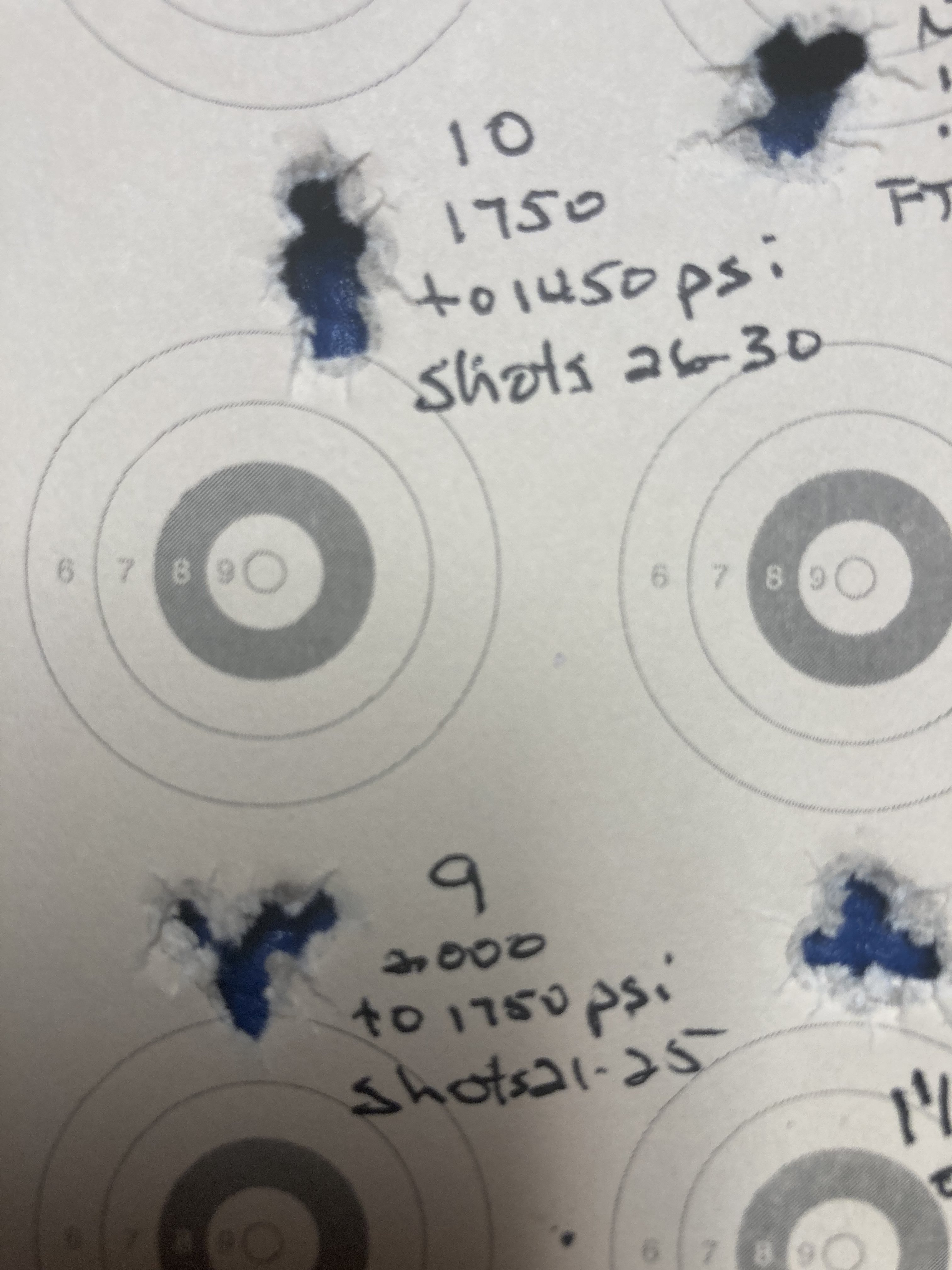

Looks like maybe 25 accurate shots. After dinner *urp*, fired two more five shot groups starting at 2000 psi. #9 is hitting at same elevation as when I started at 2800 psi. (it’s a lousy group because I was watching chronograph instead of aiming right) #10 started at 1750 and ended at 1450 psi. I concentrated on target and you can definitely see vertical stringing.

Haven’t seen any print higher, only dropping when pressure reaches a certain point. Really need to get it outside, hard to tell a whole lot from short distance in basement - 11 yds.
Here’s the only time i shot it outside so far, at 37 yards, after rough zeroing in of scope. By group #3, pressure had dropped and you can tell elevation was falling. Breeze had picked up from left to right also. #2 was looking pretty until one went waaay out in left field. Also can’t explain the real low one in #1. These were Crosman domes, and sometimes they’ll do that. (could have been me also)

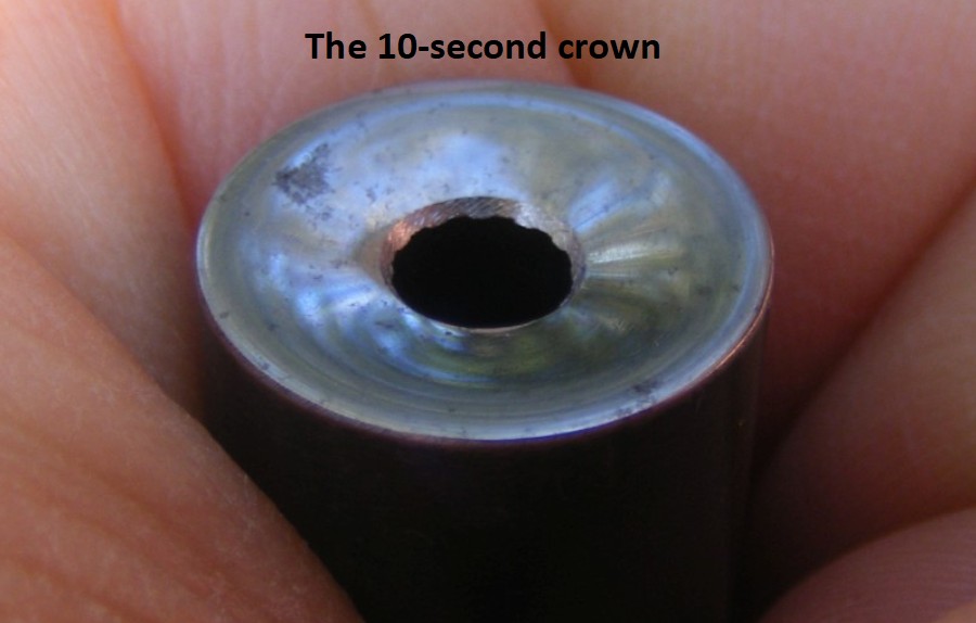

Just wanted to share this real quick...
GTA member K.O. got a photo of the crown on his .22 cal Crosman Icon:
And that got me to thinking, what kind of cost:benefit analysis can possibly justify the factory using this atrocious crowning technique?
I clamped a barrel to my bench and imposed a 10 second limit on myself to crown it. Three (3) seconds with a carbide burr, followed by 7 seconds with a diamond ball.
One try. No practice. No retakes. I'm sure a capable manufacturing engineer could optimize it down to 5 seconds. So when we look at rifling wiped out at the muzzle, the only logical explanation for it is sheer apathy and indifference to quality control.
Nice job!
I was getting only OK groups from my .177 ICON, so I recrowned the barrel today and they did tighten up a bit.
Still only able to shoot at 10m, once the contractors are gone I can shoots at 25m.
