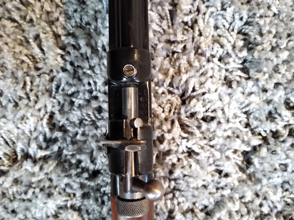

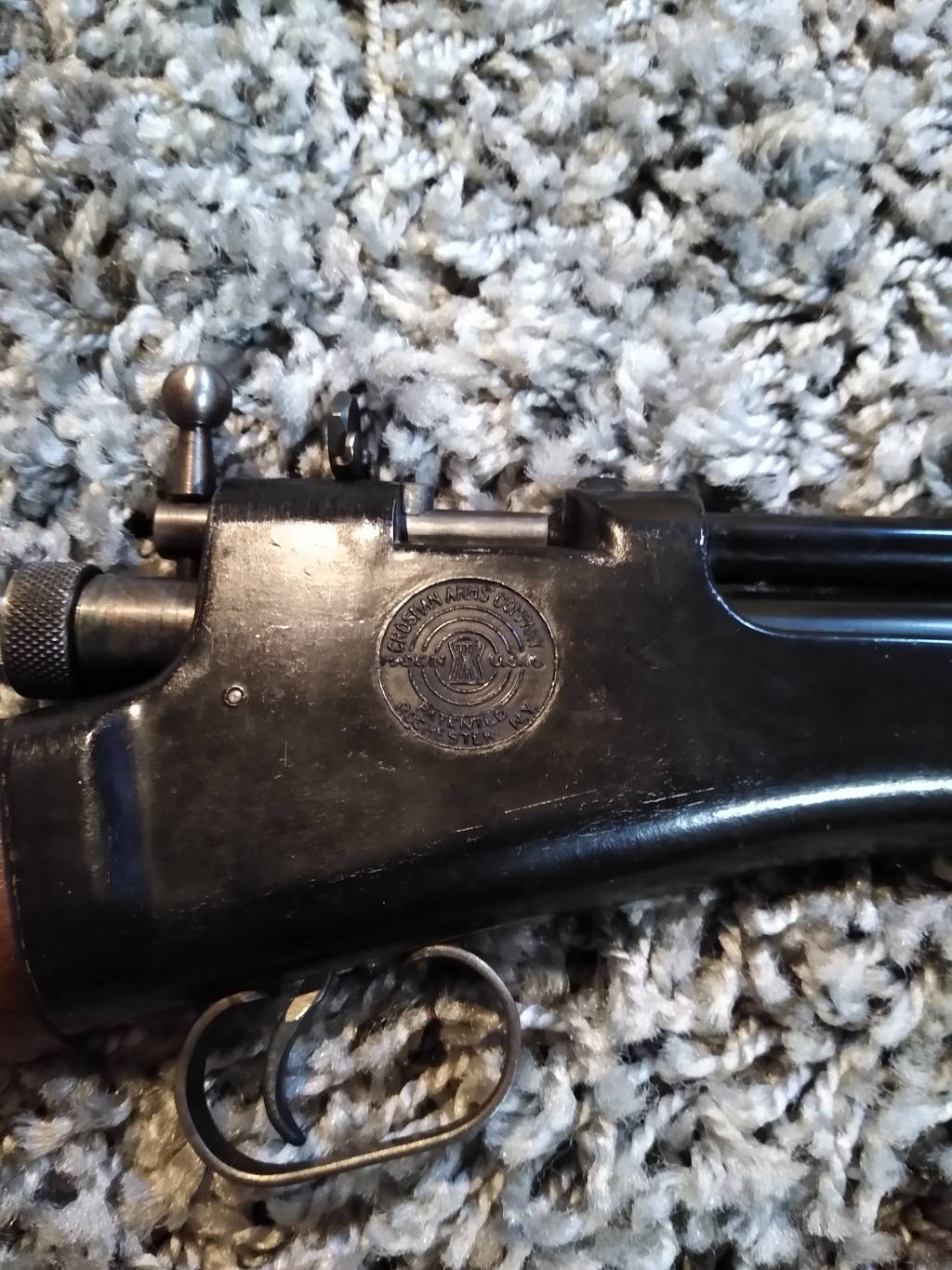

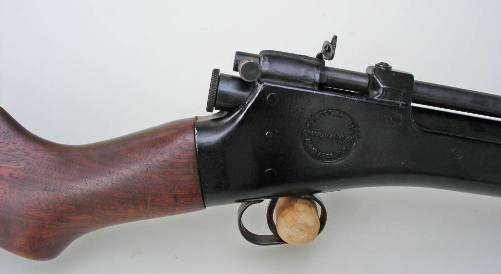

Howdy folks, Kevin here from Michigan. I recently inherited a Crosman model 101 air rifle from my grandpa. I have ordered a rebuild kit from Baker Airguns that should arrive in a few days.
I know very little about air rifles. I've shot this one about 50 times before it started leaking air out of the end of the barrel. Hence the pending rebuild.
What I could really use it help identifying when this thing was made. Based on my grandpa's life, I'd guess he bought in highschool (1931-1935), but I don't really know. Could anyone here help me figure it out?

That rifle is in fine condition!
I'm no expert, but from the looks of the knurled cocking knob it's probably an earlier one. If I remember right I think the later ones had a grooved cocking knob. They're nice guns, I had one for quite a few years before I passed it on to a buddy. The barrels are brass so be careful if you decide to clean the bore. A pull through like the patch worn would be ok.

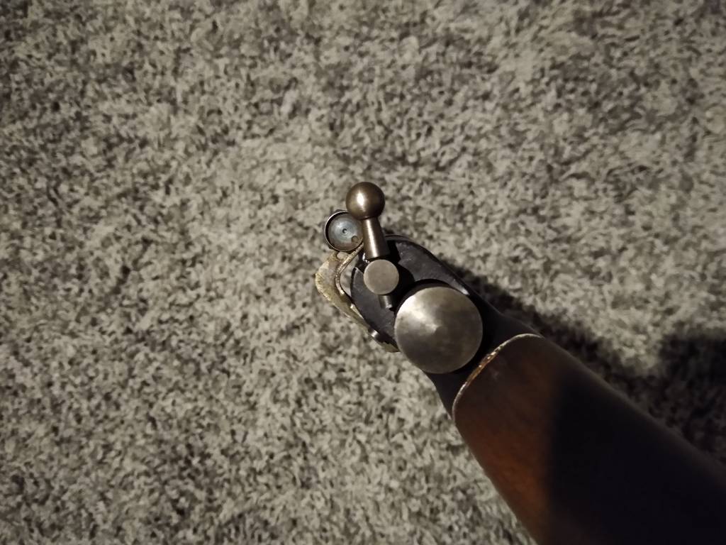

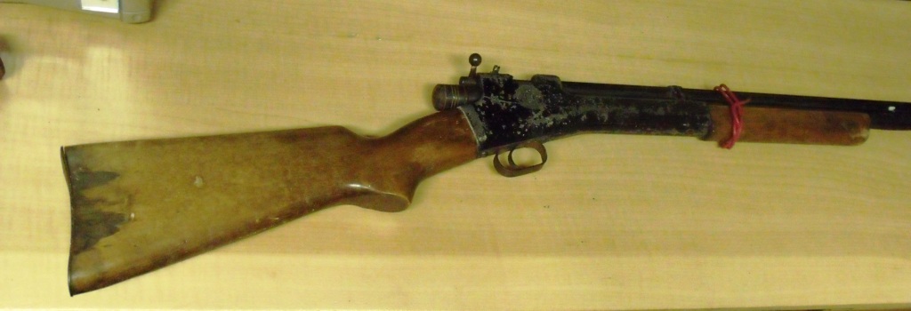

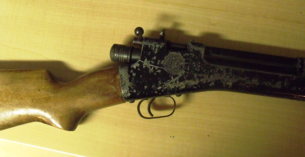

I just did a Google search "Crosman 101 History" and got lots of info. Here are a couple pics of mine-the wire wrap was to hold the pump arm up, the leaf spring that held it broke and replacements are unobtainium. Notice the grooved cocking knob.
3rd variant pre-1949. Looks like its in good condition. Has the large knurled knob, so it's probably an earlier 3rd variant. Later models had the 5 ring or diablo knobs. Post 1949 variants had the nicer sight and a clip at the back of the receiver.

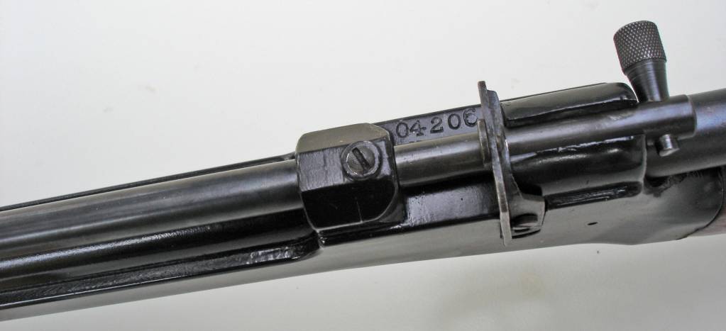

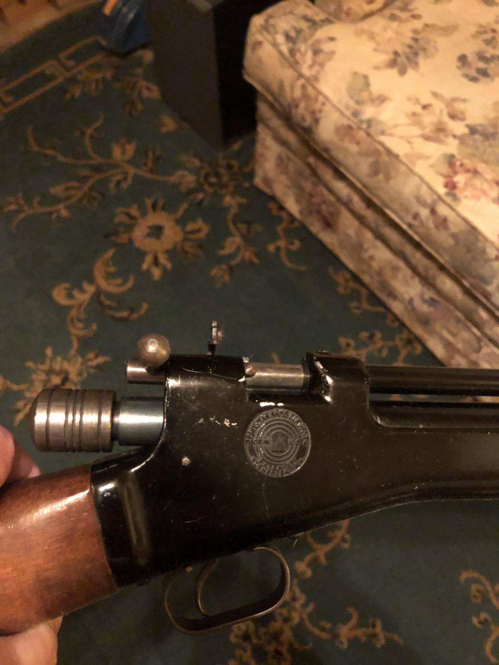

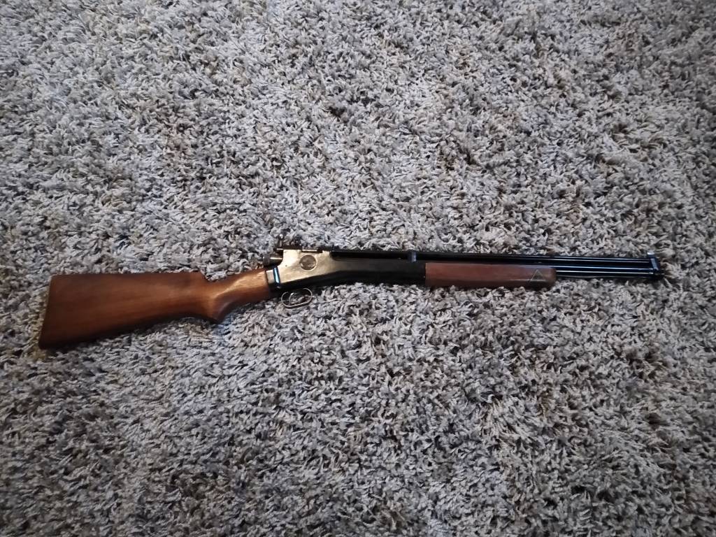

 I have a 101 also and looks Just slightly different than yours. I did a lot of research on that particular gun and found out that some of them are hard to date because they used random parts sometimes. They said in the same year you might get a gun with a brass barrel or a steel barrel. And then sometimes they would run out Of parts and use older model parts from previous years. The real early ones have a patent date on the side. Also the early ones had walnut stocks.I can’t exactly date mine but do know that it was made in the late 40s. Also certain years have different cocking knobs on them. And also the Peepsight were different on different years. Yours Has a different cocking knob than mine.Mines never been worked on and I believe it’s a little low on power.But here’s a picture of mine that was made in the late 40s And has the steel barrel. I was wondering if yours was steel or brass.
