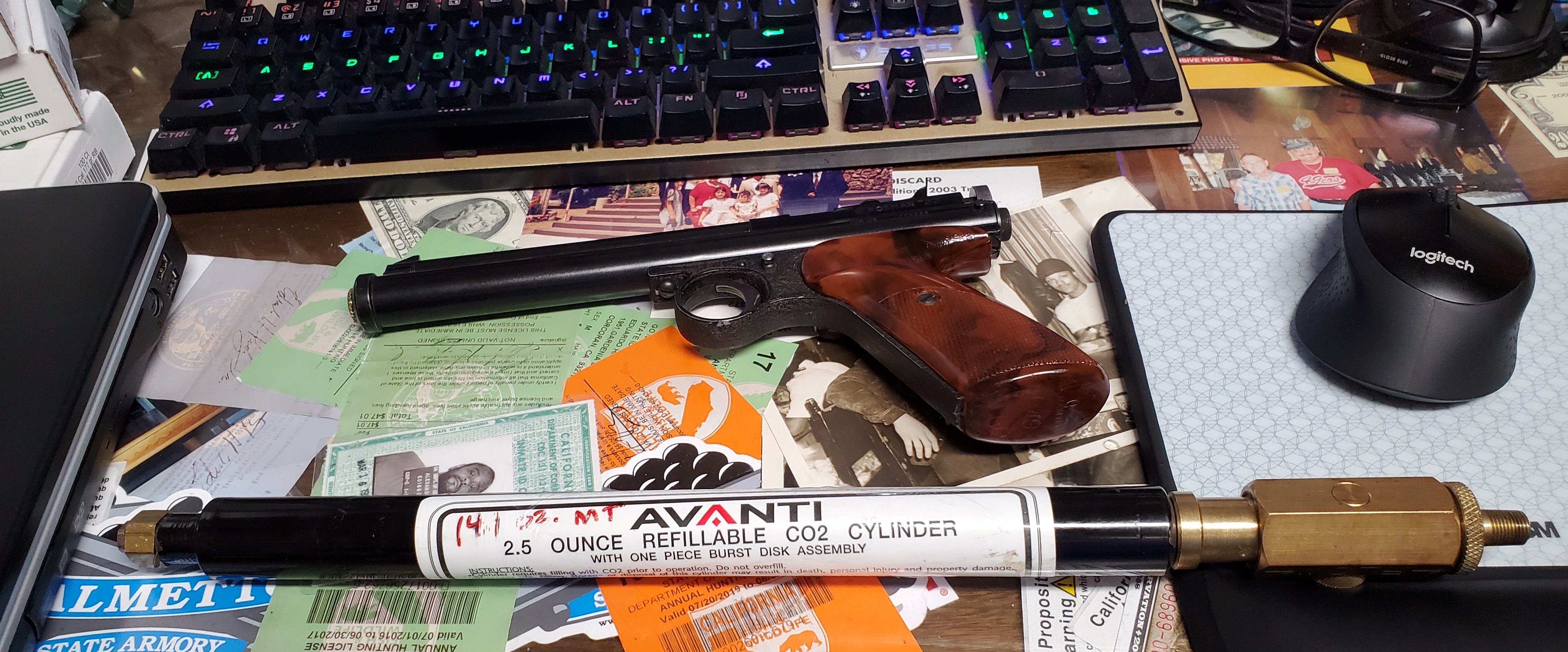

You will need a paintball co2 tank and an adapter. The tank you can get online or at a local sporting goods store. See if you have a paintball or airsoft shop buy you so you can get it filled.

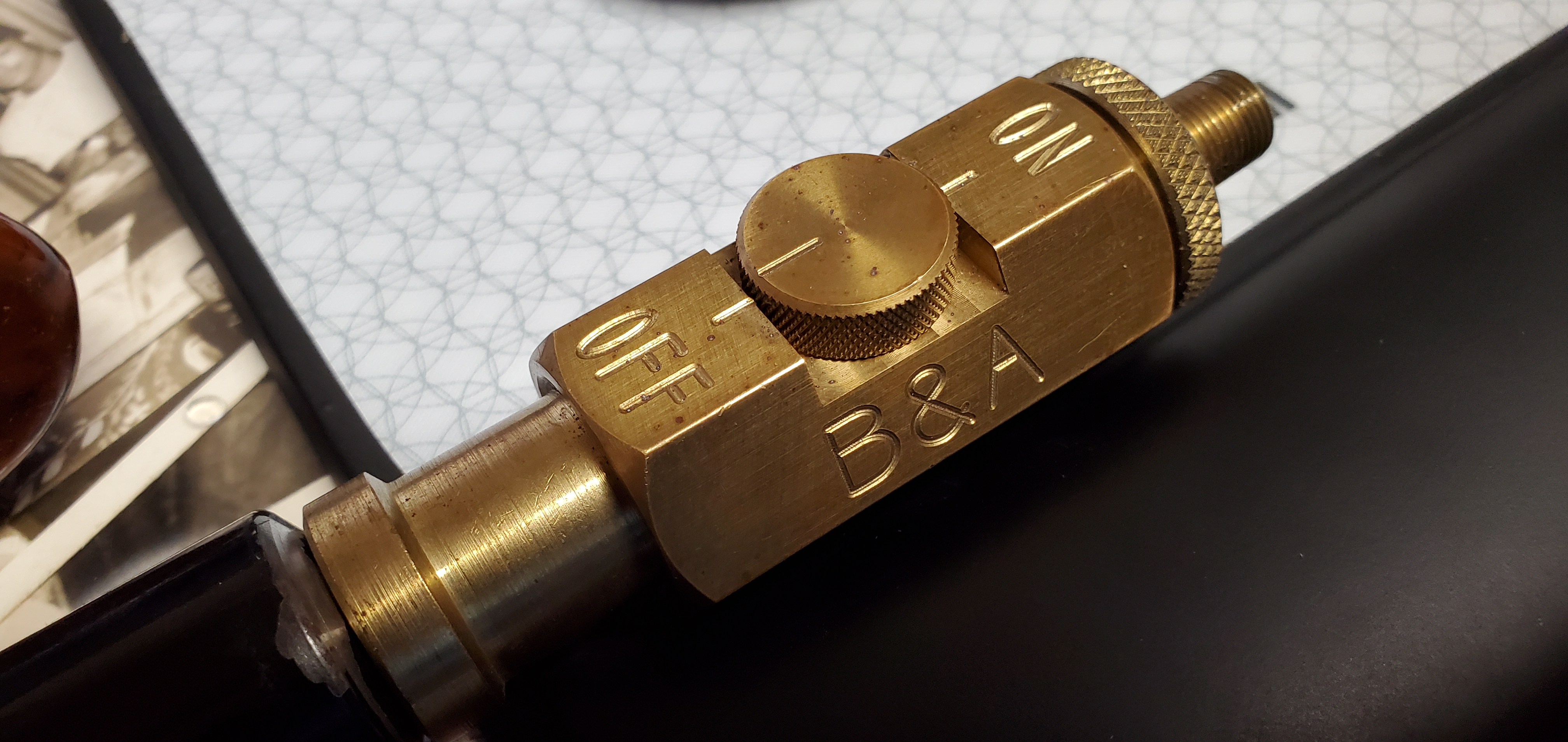

The adapter you can get from Mac1. I think it is this one I am linking but you can call Tim and he will sort you out. Ask him about a tank also.

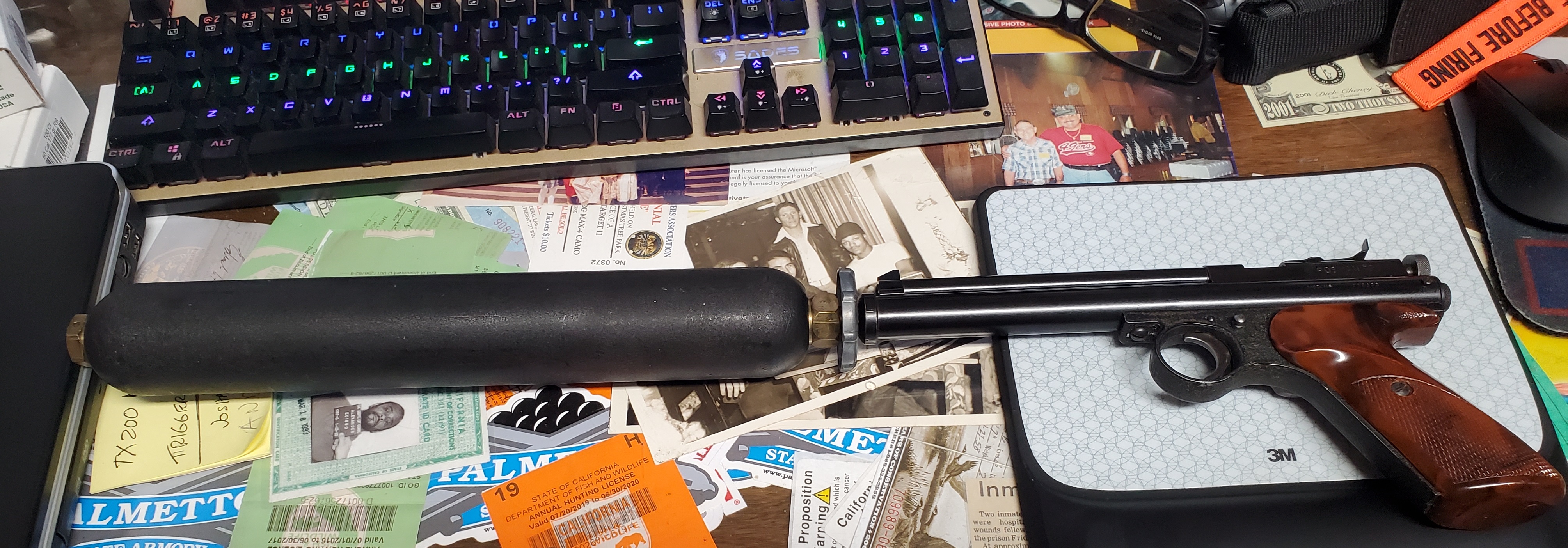

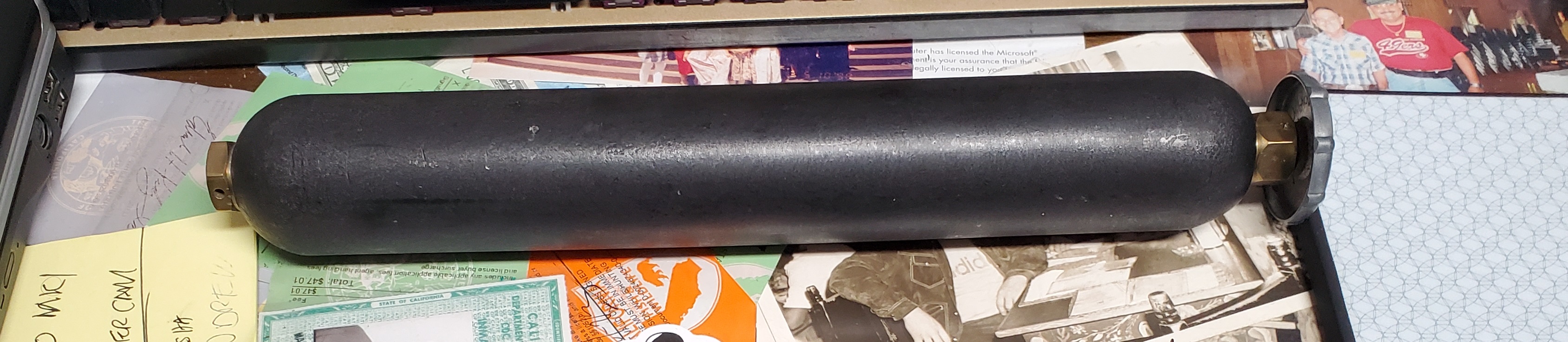

FYI here's my set up:
Adapters for standard CO2 Paintball bottles: here and here
