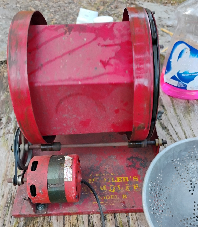

Mr. Mcnasty- I've got a Thumlers and an old Lortone just like yours. The Thumlers is for brass polishing and turns at a different speed than the Lortone designed for stones.
Firewalker - Do you know what speed yours rotates? Is it designed for brass prep or rock tumbling?
I THINK the brass tumblers turn twice as fast as the rock tumblers. I need to go plug them in and refresh my memory which one turns faster.

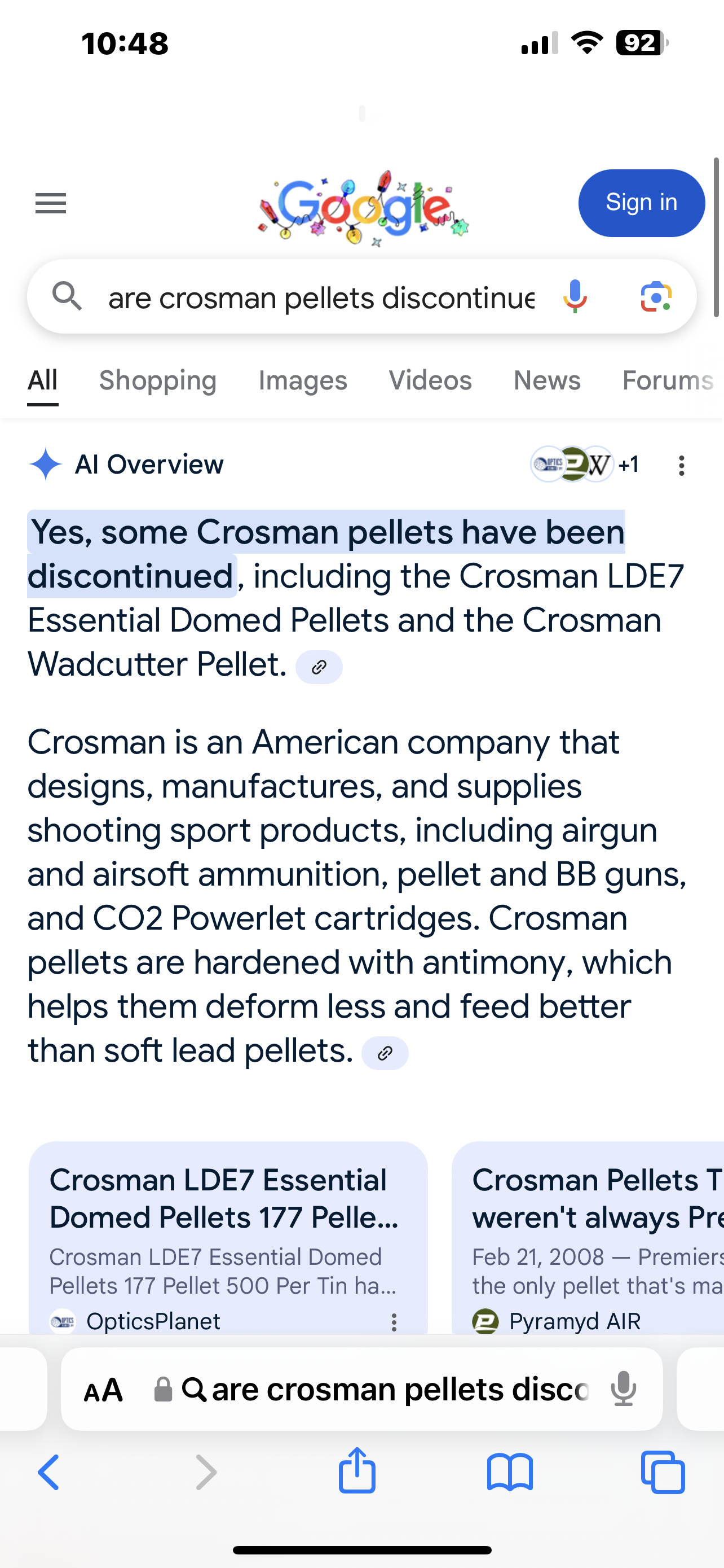

Better stock up. I’ve heard Crosman pellets are being discontinued.
Reactions: Bedrock Bob
Heresy! Blasphemy! It's the fake news media manipulating us!
Really?
I hope it's not true.
I wonder which pellet Walmart will carry? Sportsman's Warehouse? Crosmans are the only thing you can buy here without ordering....
The Norma Golden Trophy are clean and shoot dandy. Almost as cheap as Crosmans. They size a bit smaller but they are consistent. They come in an 800 count pack if you can find them. I'd shoot the heck out of those pellets if I couldn't get Crosmans.
Those wadcutters and the "essentials" are not something I use so I suppose I don't have to rend my clothes and cut off my dreadlocks yet.
The response was AI generated. I won't believe it until Alex Jones tells me if it's true or not...

The Rebel 15 barrels are identical to the Thumblers Tumblers 15#.
The Lortone 15# as well. I use Thumlers liners and gaskets and they fit (almost) perfectly.
The only difference in my machine is the rotational speed. The Thumlers (for polishing brass) turns at a different speed than the Lortone (for tumbling rocks).
Reactions: Hateful McNasty
Good to know
Ya I've read on the speed thing as well
I've had mine for like 30 ++ years or something. Only thing to go bad so far ( knock on wood ) is the drive belt .. I use the extra canister oil filter gaskets that fit my tractor ... Just right don't stress or break easy too .. like made for it ..lol

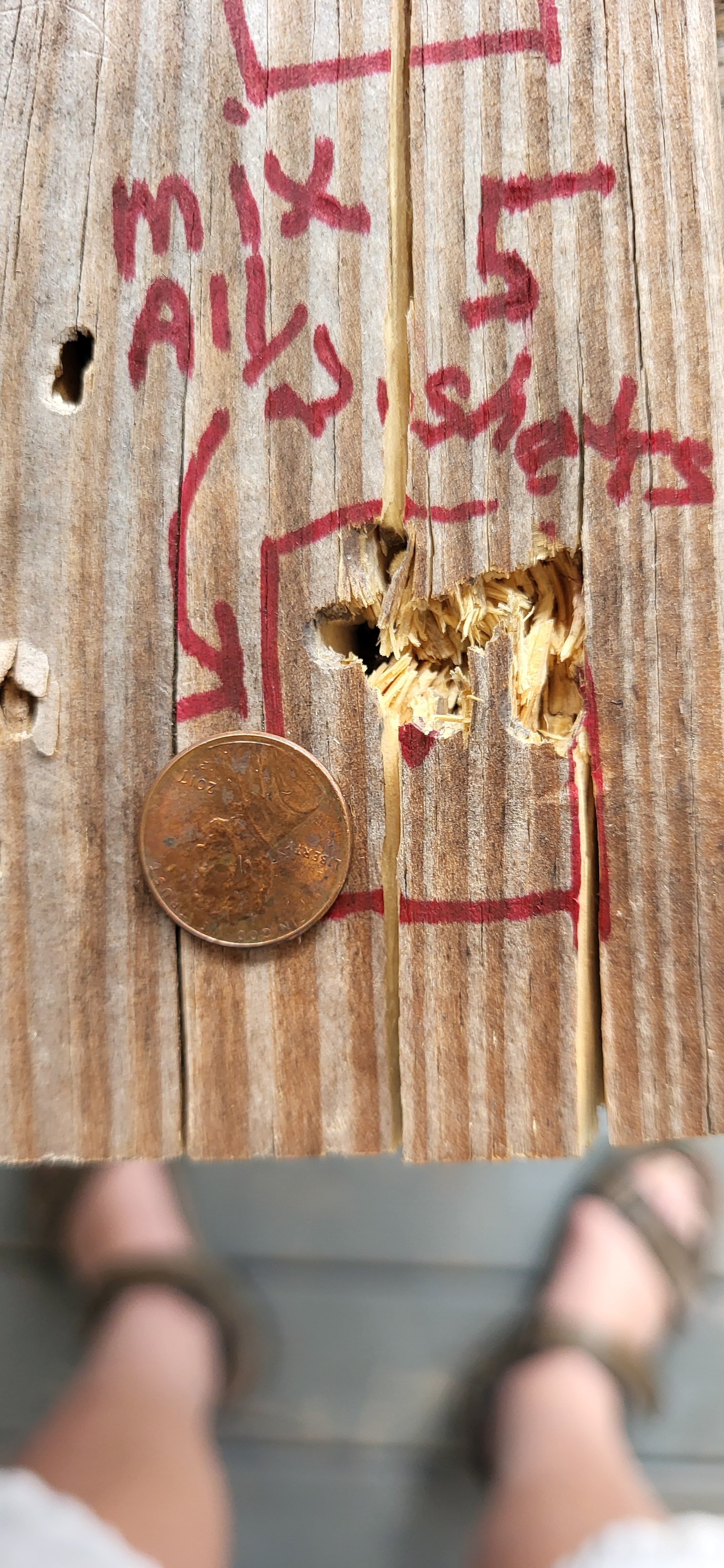

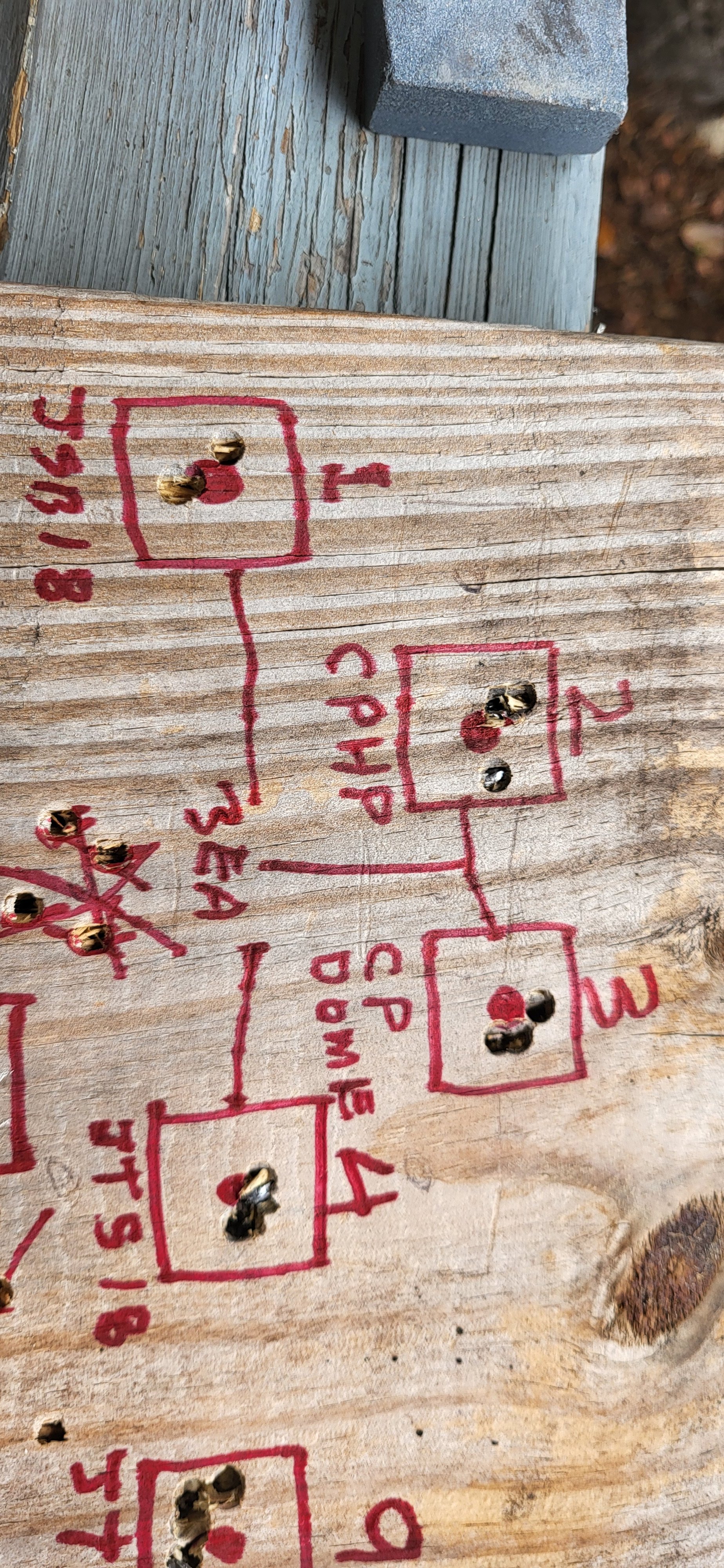

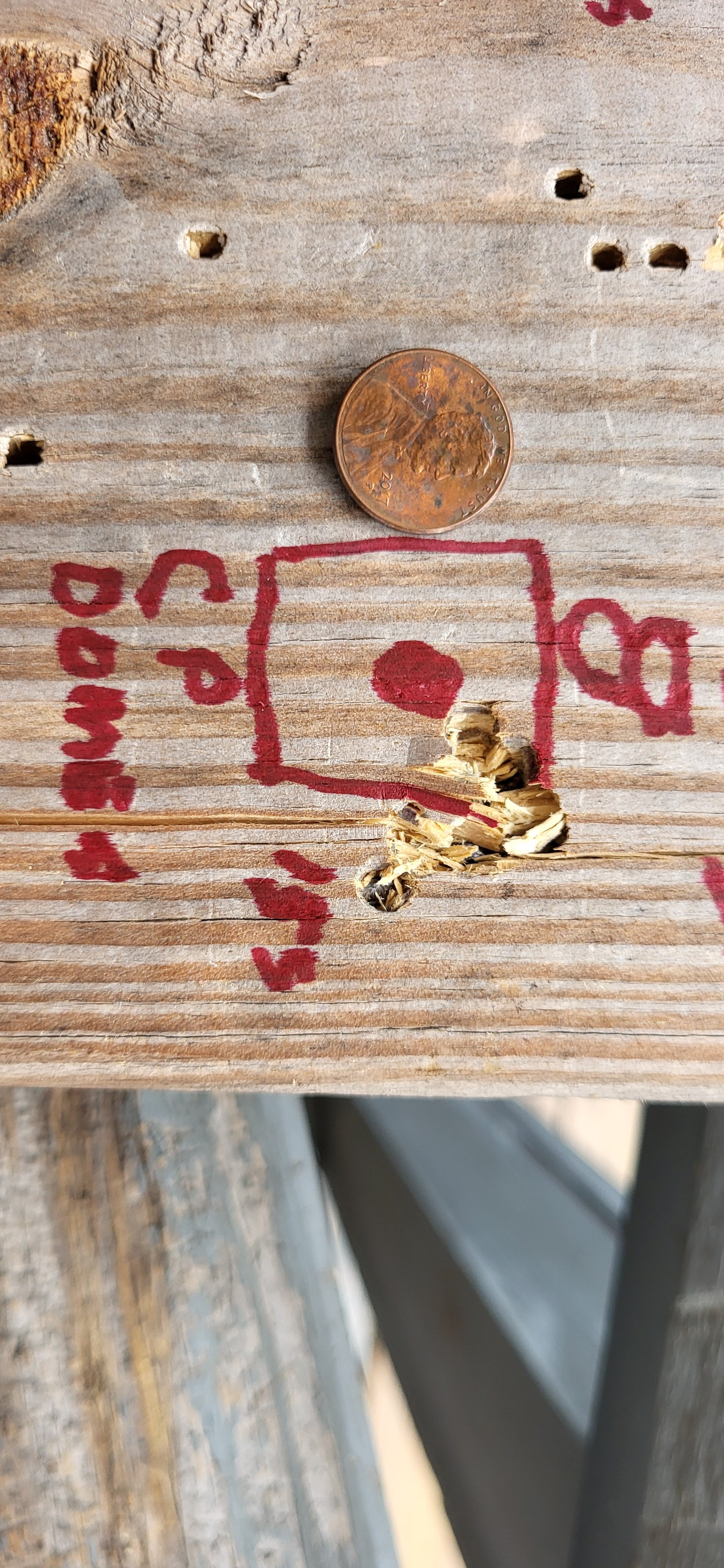

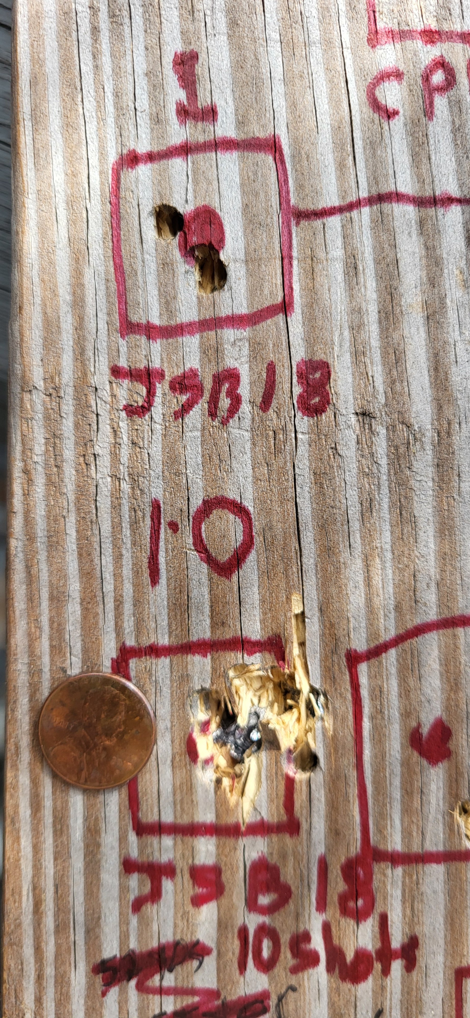

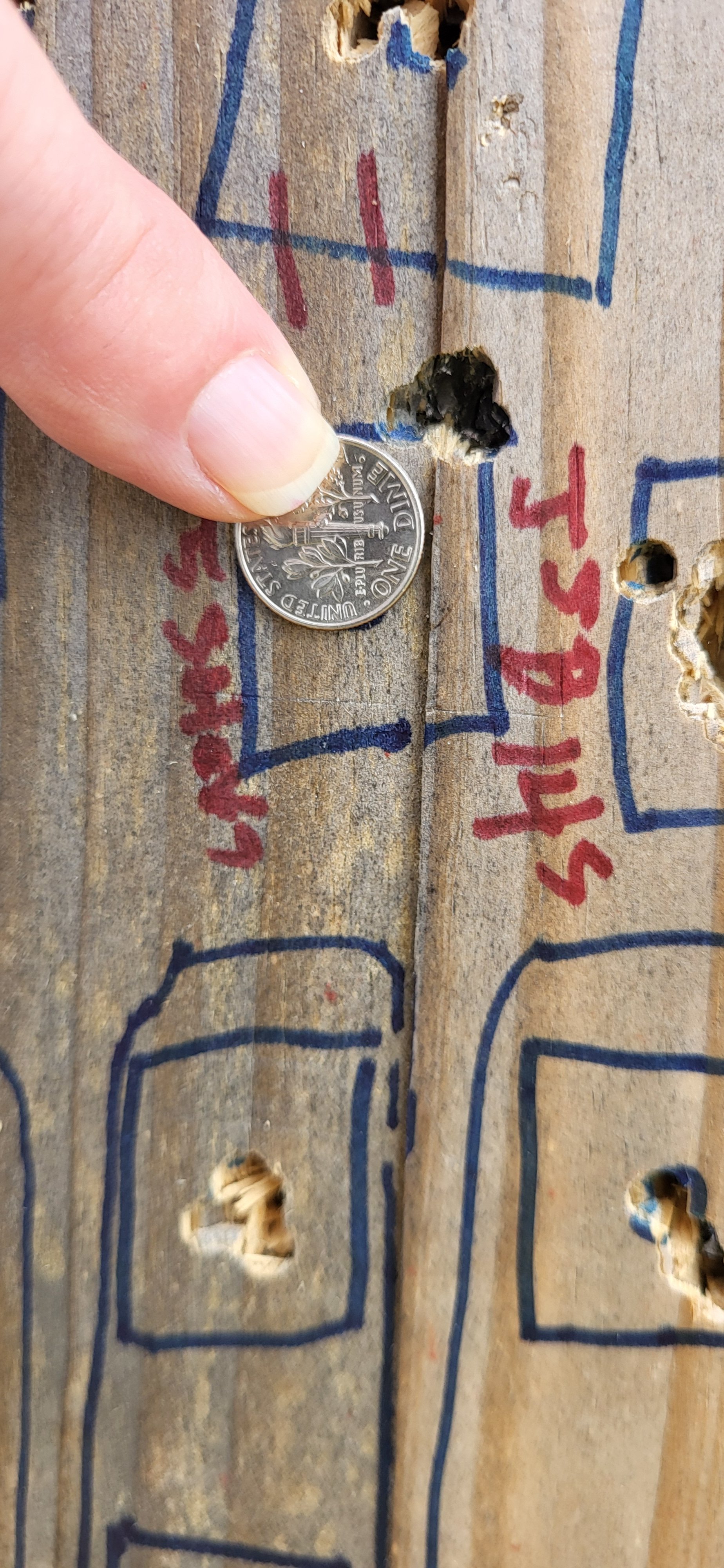

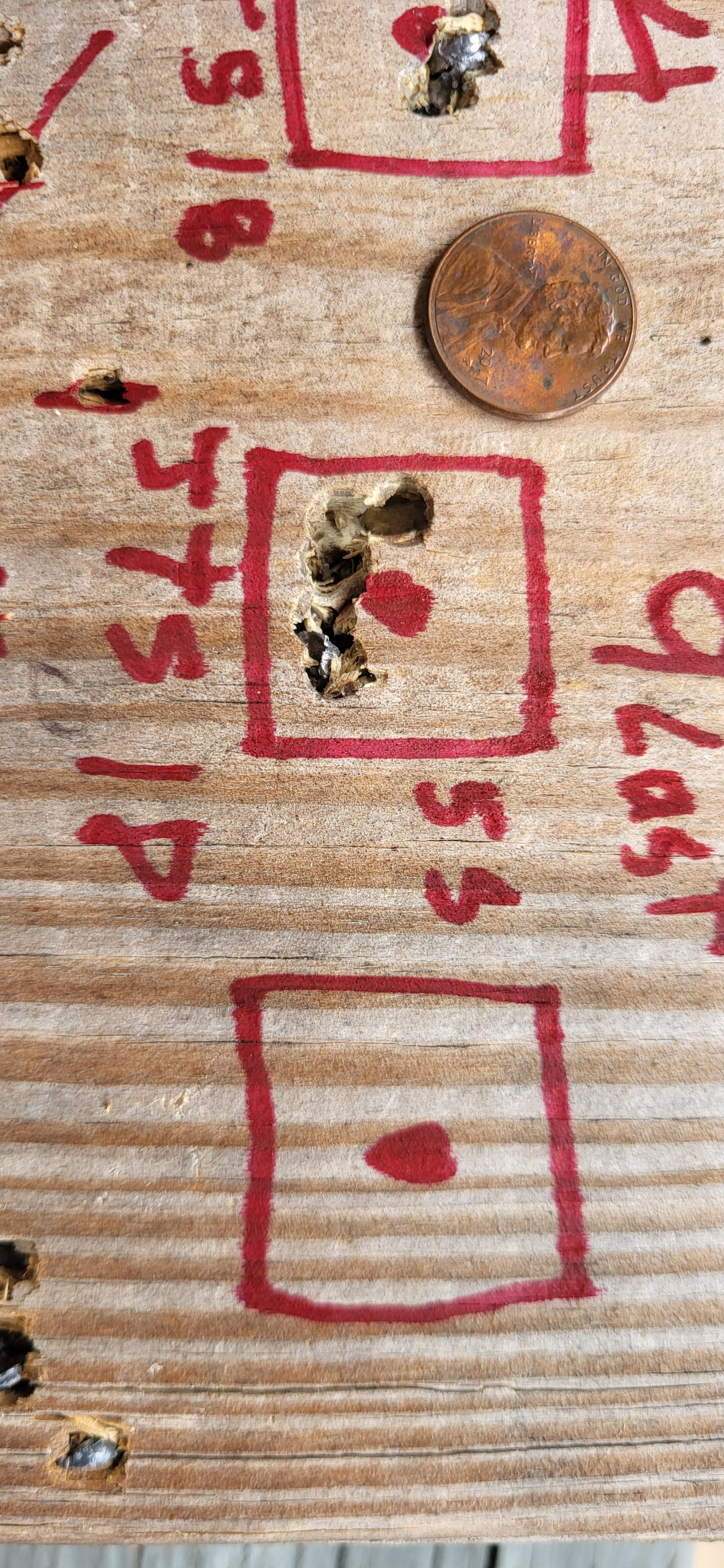

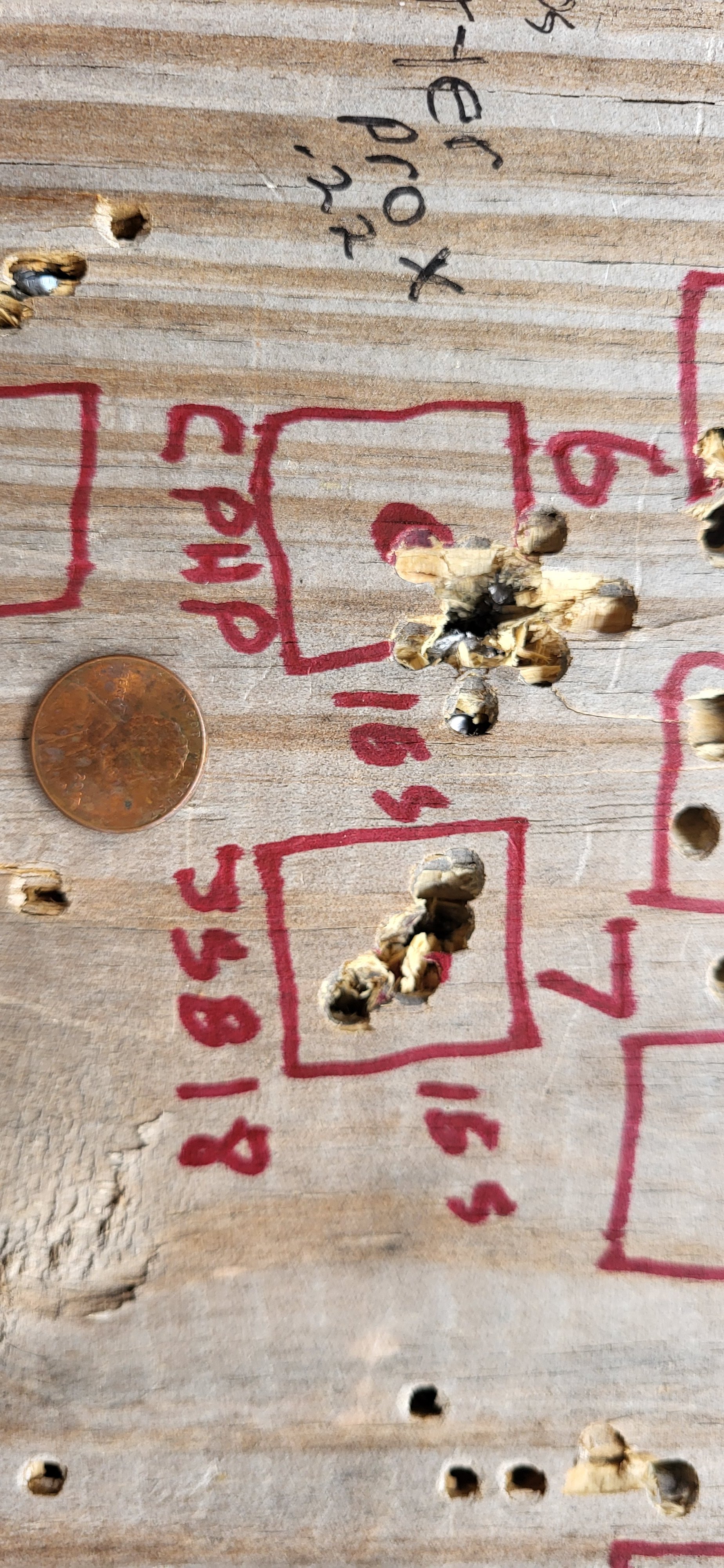

Member fullpower, I did this test just for you...Consider the results. Question; do Crosman pellets mess up the bore of a airgun? Testing JSB 18's, CPHP's, CP domes, JTS 18's, and last and final group JSB 14.35's.
All shot at 34 measured yards off my knee nonbenched with a Taipan Mutant standard shooting JSB 18's at 890 fps. Barrel wasn't cleaned for test...infact it already had all these pellets shot through it for days before. Some wind.
Group 1 to 4 three shots each but not JSB 14.35's. Only last group for them...I forgot I had 'em.
Group 5 is 3 each shot back to back at same point of aim. 12 shots.
Group 6 and 7 15 each CPHP''s and JSB 18's.
Group 8 is 15 CP domes.
Group 9 is JTS 18's, (not last group 11 is.)
Group 10 JSB 18's, same as group 1, was some wind with this one.
Group 11. JSB 14.35's, after all those different pellets in different numbers and orders, best group of the test. How fitting!
I only use MP5 or equivalent and Bounty paper towels to clean my barrels...then not much.
I shoot a lot, I shoot often. Crosman pellets aren't the best but they have their place.
I've shot dump truck loads of them...I never worried about anything except running out of them!

RM100Guy, Now that is a serious comparison test. Thanks for taking the time to document this and some really good shooting there and no bench rest. . I like the fact that the only thing you worry about is run-in* out of them ha!
