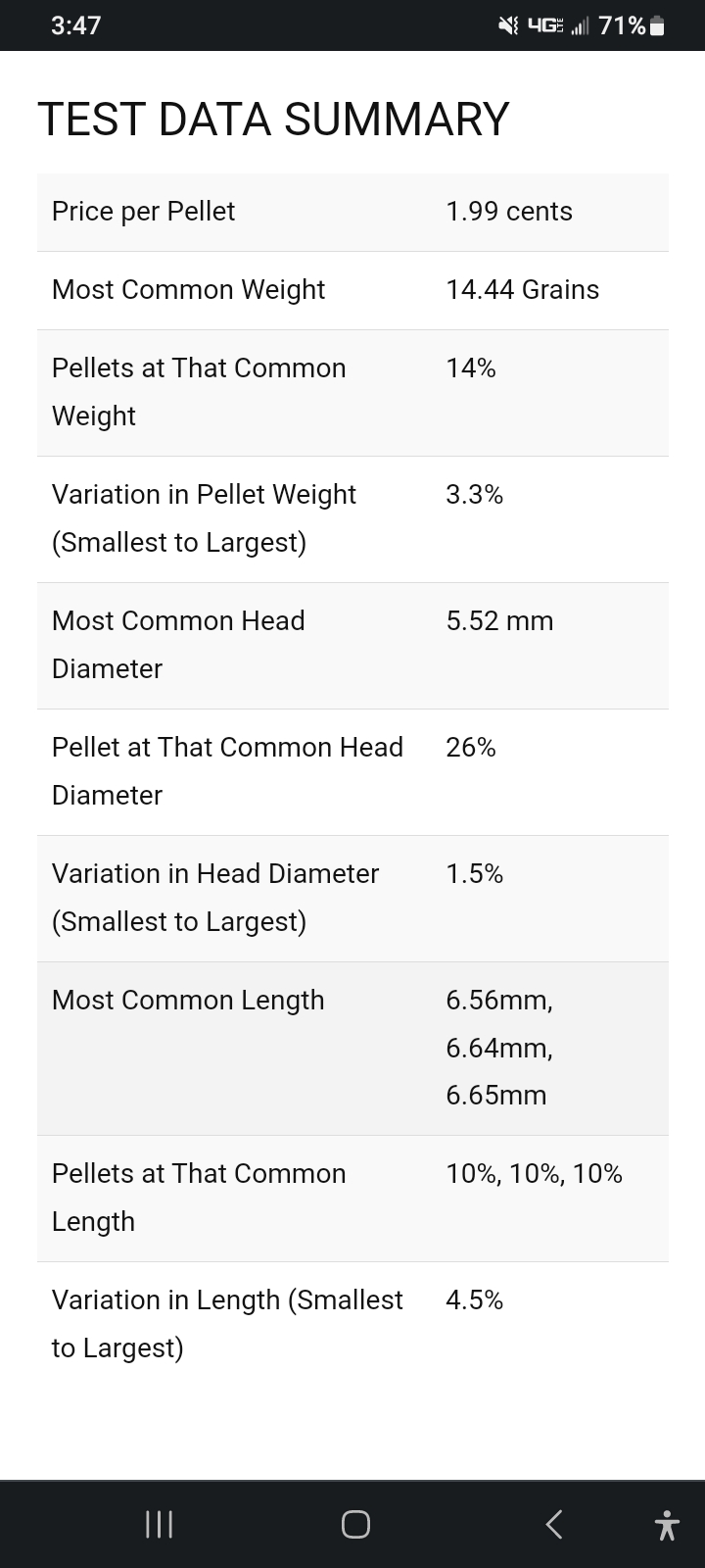

Dont know if you looked at this for a compair. I would but numbers give me a headache 🤤.
Heck you come closer to the 14.3 then they did .. time for 3 Bayer now..lol
Found the summary 🥴
