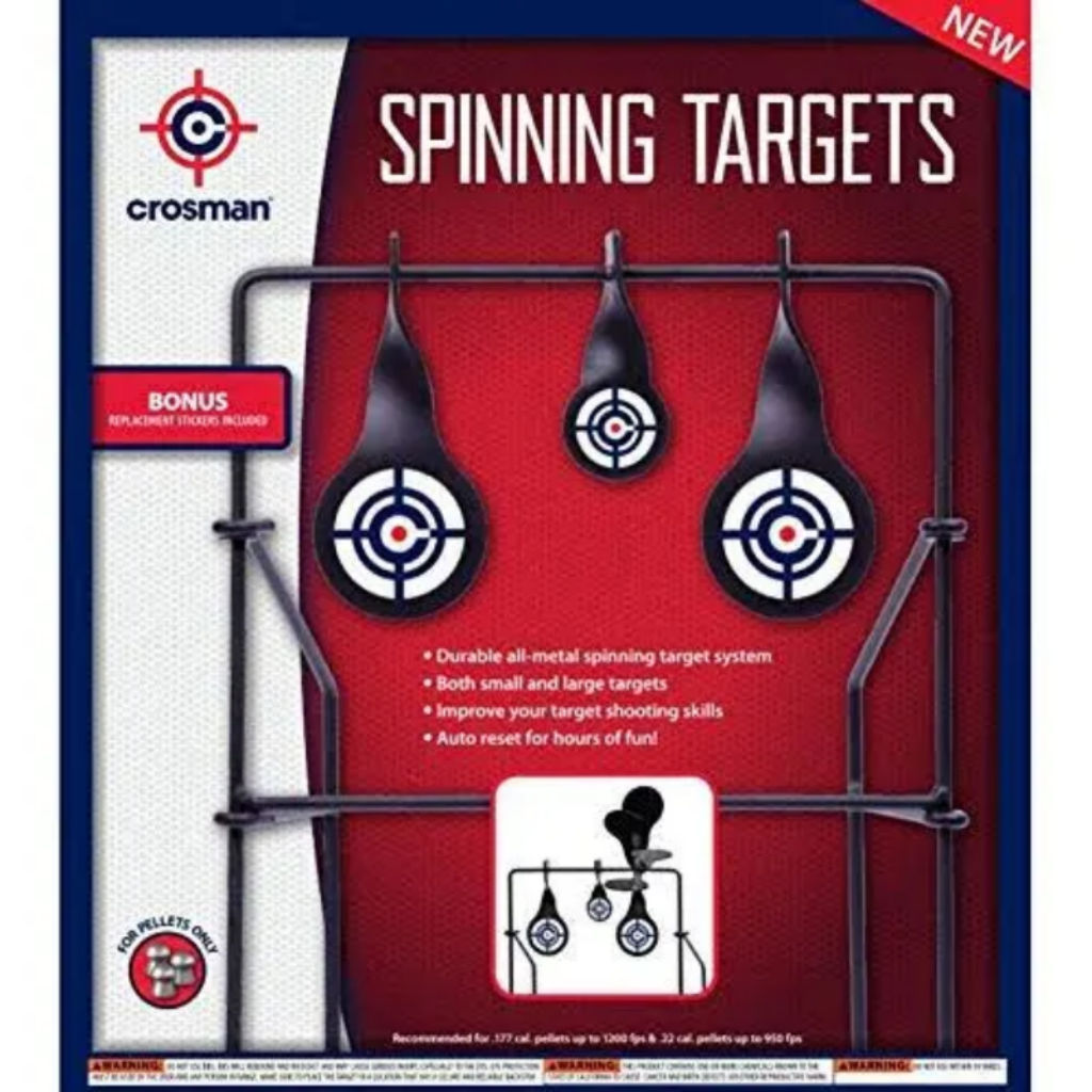

My favorite targets are these inexpensive Crosman steel spinners. They are much heavier steel and they hold up to 25 caliber and 40 foot pounds no problem:
I have multiple sets and place them at whatever range I want to practice at or collect trajectory information for my range card and use cheap white spray paint to renew the surfaces. When I want to confirm the trajectory for a new setup, I have a set of four or five and I place them at every 5 yards to collect my trajectory / holdover data and coordinate that with results from my ballistics app such as Strelok Pro.
Warning: Steel spinner targets such as these that use a paddle that has a half twist to allow it to hang on a cross rod WILL cause sideways ricochets if a shot hits the twisted area and gets redirected!
I like to place mine at the base of a tree that is wider than the spinner set, to intercept misses or ricochets.
Hope this helps. GL,

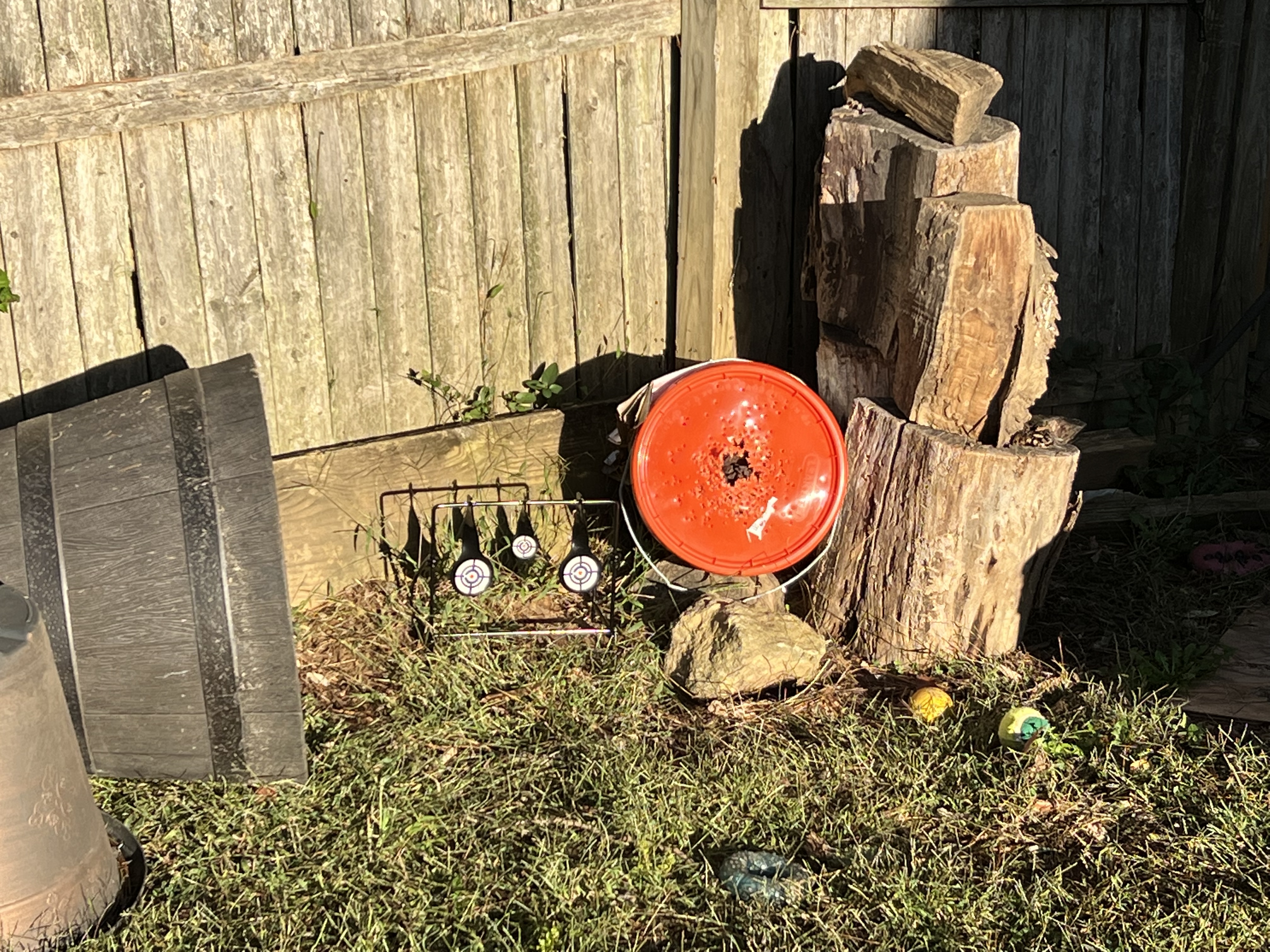

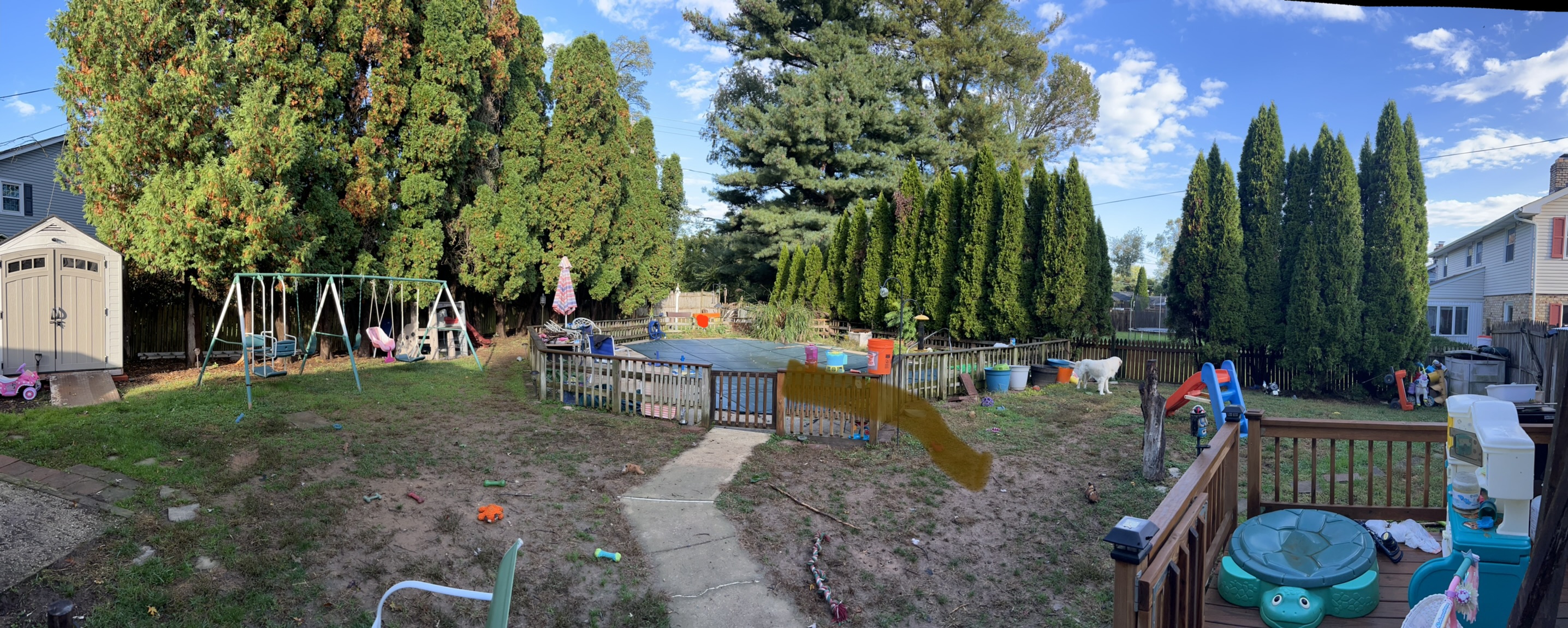

That helps a great deal. After seen your photos sorry for saying gamo but the ones you use are what I got from Walmart for 11 bucks. I was thinking of placing logs on each side to prevent fragments flying off behind it is a field. Even though the would have to come off prefect to get a neighbors house because they are forward some n would not be at the sides of the target

Okay great, glad I could help you. Yes I got mine at Walmart as well, very inexpensive for buying multiple sets and they do seem to hold up to the weather for a few years. Sometimes you have to spin them around a little and lubricate the hinges to keep them swinging freely, as some rust can form inside the little tube that slides on the axle.
The cool thing about these is that you can paint both sides and simply flip them around 180° for fresh surfaces instead of carrying the spray paint can with you every time. Sometimes I place multiple sets at my zero distances because I will sometimes do a lot of shooting while testing or sighting in and don't want to have to keep walking down range to spray the targets.
It sounds like you are saying that the neighbor's houses are forward of the target which helps a great deal. I think it's unlikely that a pellet will be thrown forward because they tend to deform and deflect to the side or down or even slightly upward and go down range. A three-sided backstop is a reasonable precaution. And yes I have used cut logs stood on end to form a backstop. Stagger the logs a little bit so that there are no gaps.

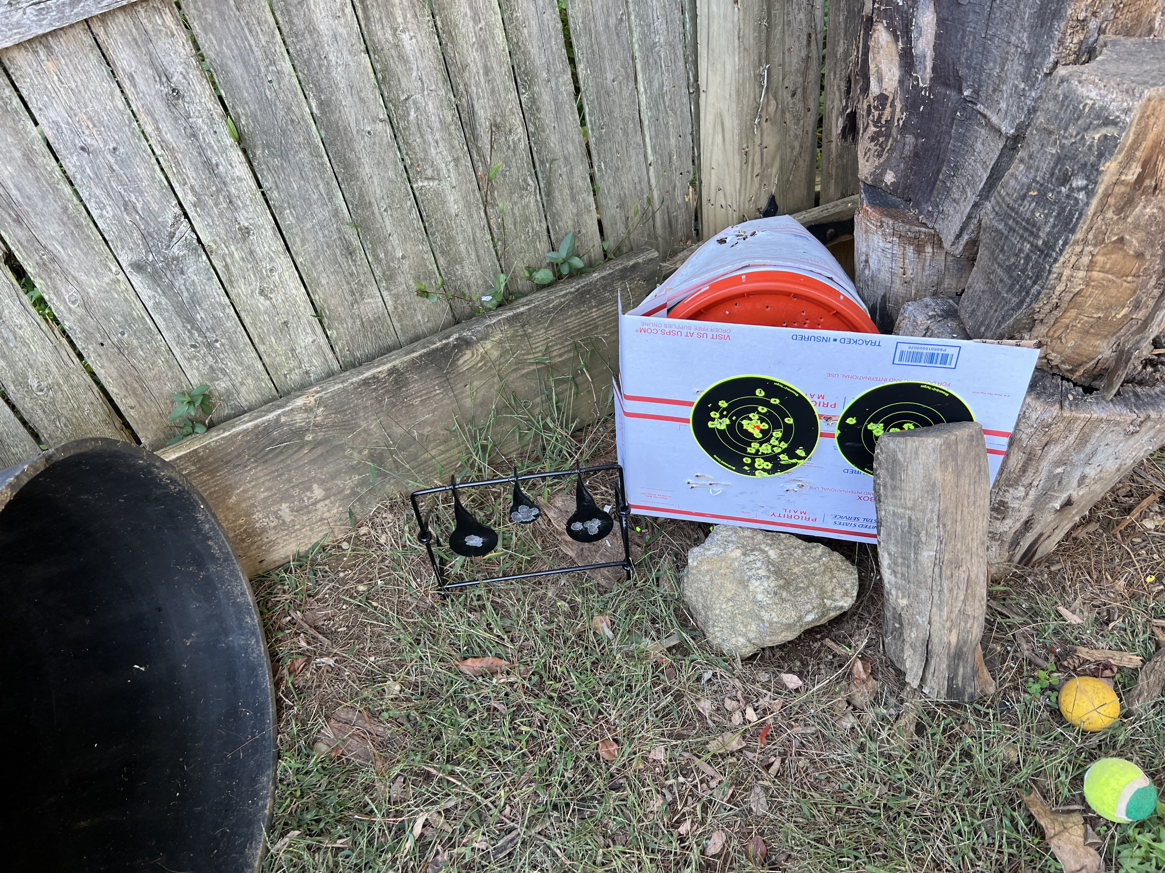

My 25 caliber Avenger bulged the back side of the Crosman spinners. It is tuned to shoot 25.4 grain FX at about 930 fps. I made my own "know your limits" target using brackets from Target Forge for the frame (with conduit) and spinners made of washers welded together and welded to 1/4 inch steel rod. Wasn't hard to make but you need a welder. I just used flux core wire in my mig and I'm not a good welder so the welds are ugly but it works. You can also get all the parts from Target Forge or others.
I put 2x2 concrete pavers behind the spinners. The only "spinner" that I get richoshays from is a golf ball (target forge offers a wire bracket for them). Hits to the spinner go down but if I miss I hit the pavers. They are cratered and will need replacement eventually but it will take a bunch of hits to get there. When the pellet hits the paver it splatters and the fragments won't go far.
My Avenger will shoot through 3/4 plywood, my other PCPs will go through 1/2 inch. I did not put wood behind the spinners because it would degrade quicker.
So had a little bit of fun this morning spinners work great. Saw lead fragments around but not a lot. Just hoping the dogs don’t try to dig stuff up they r a pain. Crosman hollow points worked great but the piranha are trash. They would not shoot a group to save my life. They where never even shot at the spinners because where all over the paper. Spinners held up good!
