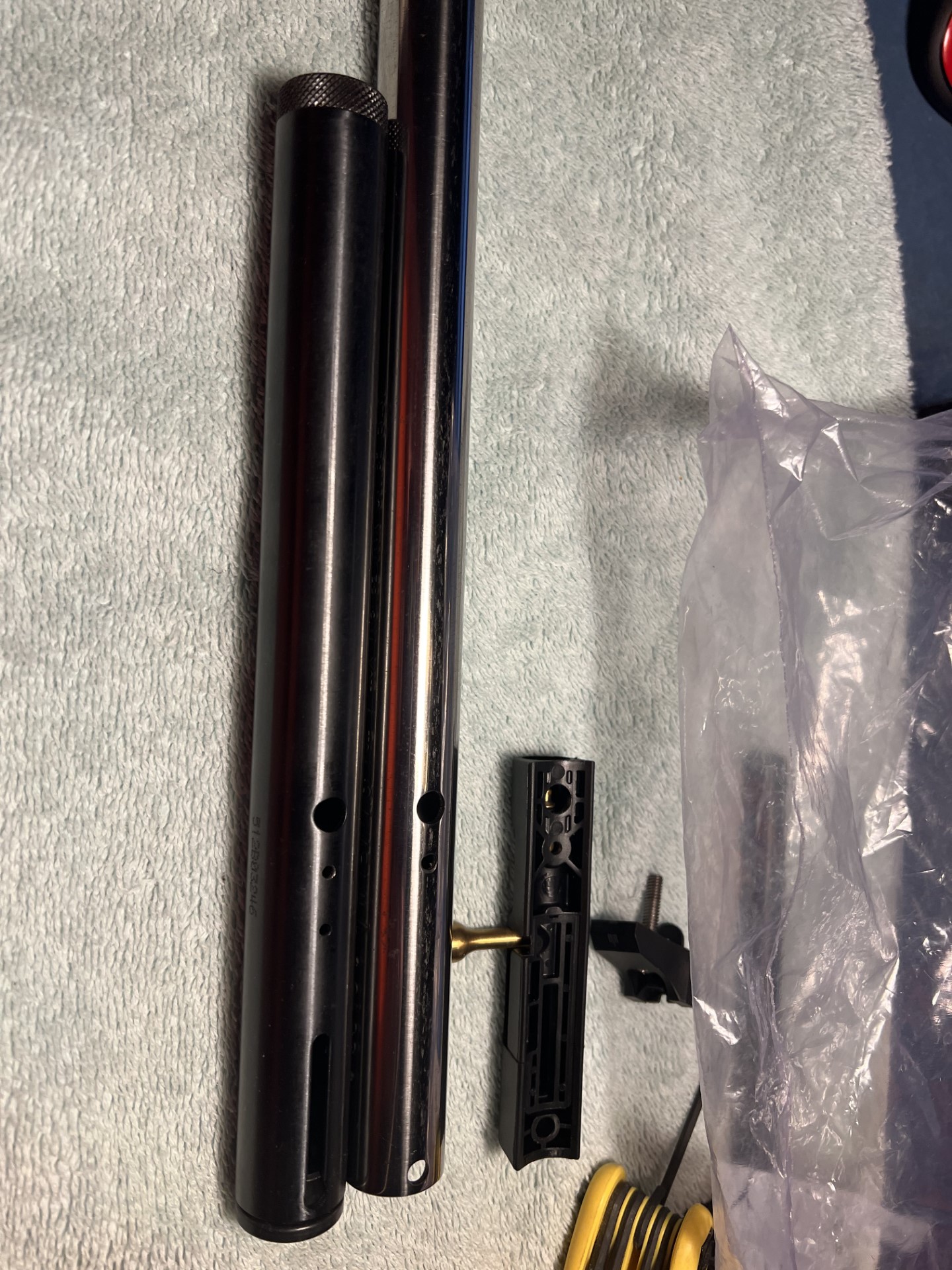

you can see in this picture the breech side of the tube line up but the 250 tube doesn't have the slot cut because it has the pull back hammer
the valve in the 250 looks to be much bigger
