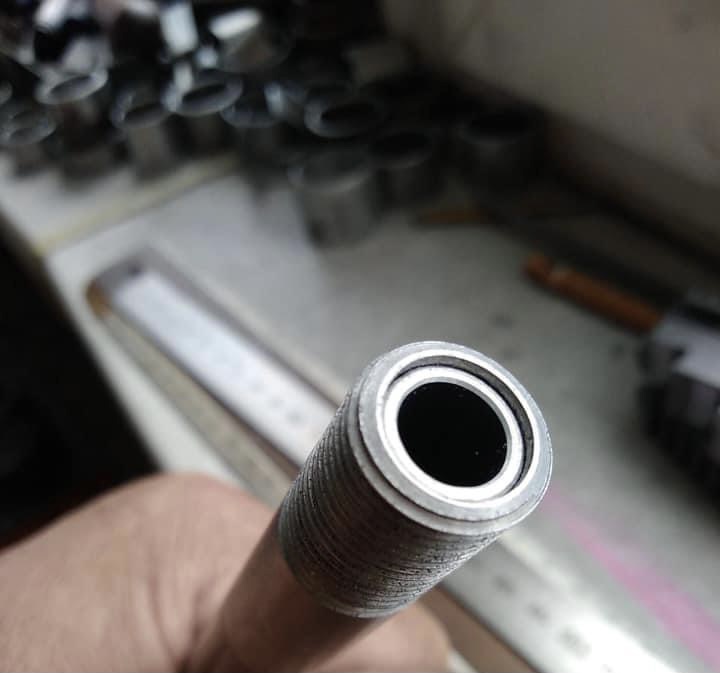

How about a better Pic please?? Maybe pull the barrel out of the gun and get some good pics of the "Business End" of the barrel..
Tom
What's to see? Looks like an FX assembly with the transfer port taken off...................

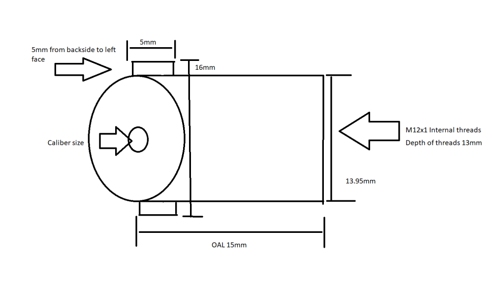

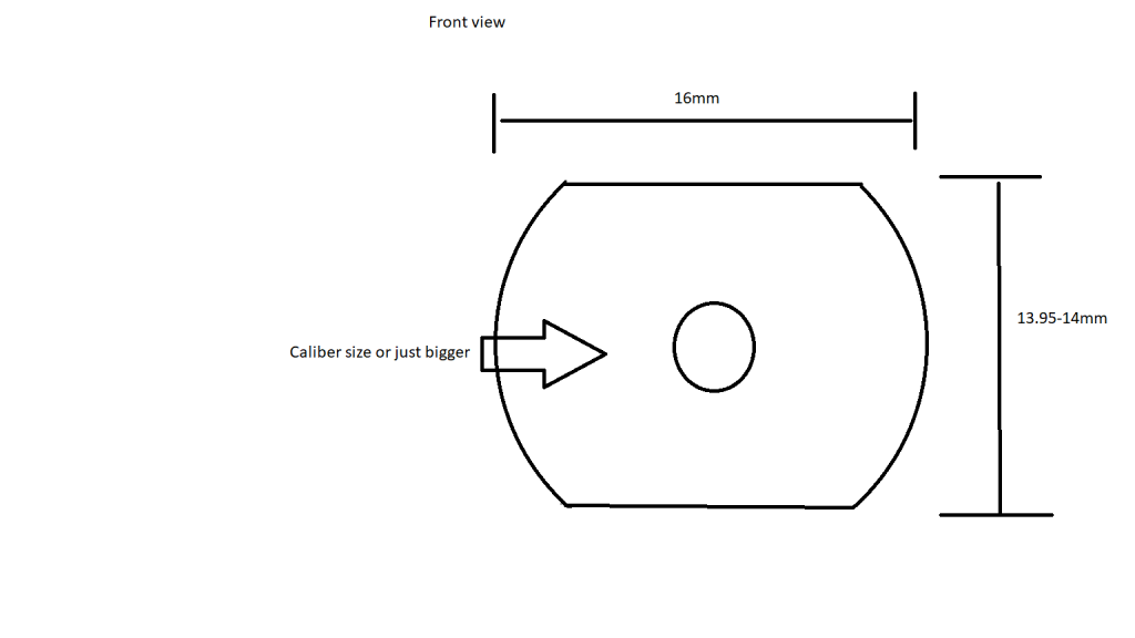

Yeah the perfect thing would be a part that that is m12x1 internal threads, screws onto the threads of the fx part. And is smooth outer like you said 13.95mm diameter then at the end has a 5mmx16mm shoulder on it (to do what the circlip type thing does on the edgun barrel) then the hole for the pellet to go through make it just bigger than caliber size so it supports the back of the liner.
I'll draw it out with my crude skills tomorrow it'll make sense when you see it.
Could do flats on the 16x5mm area.

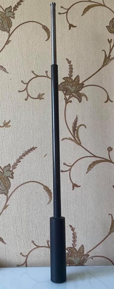

I just couldn’t help myself . Got a 530mm Kral barrel on the way. I’ll try to keep it as long as possible and add a fake shroud on it for esthetics. The barrel was 89$ CAD and readily available. This should give a decent shot increase in velocity over the 350mm. Hopefully I don’t have to change out the jets every time and can get a good balance with what I’m using now.

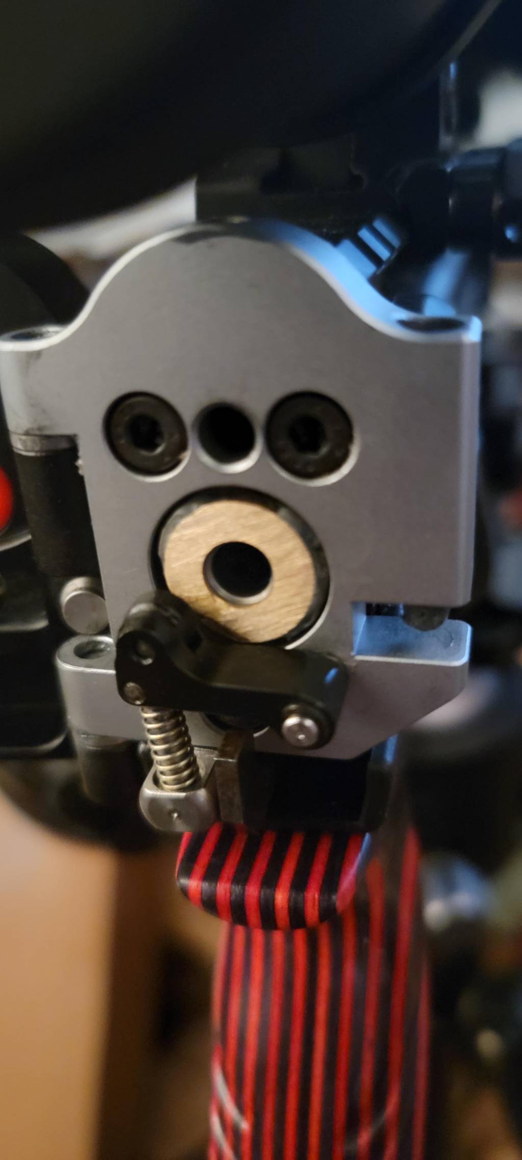

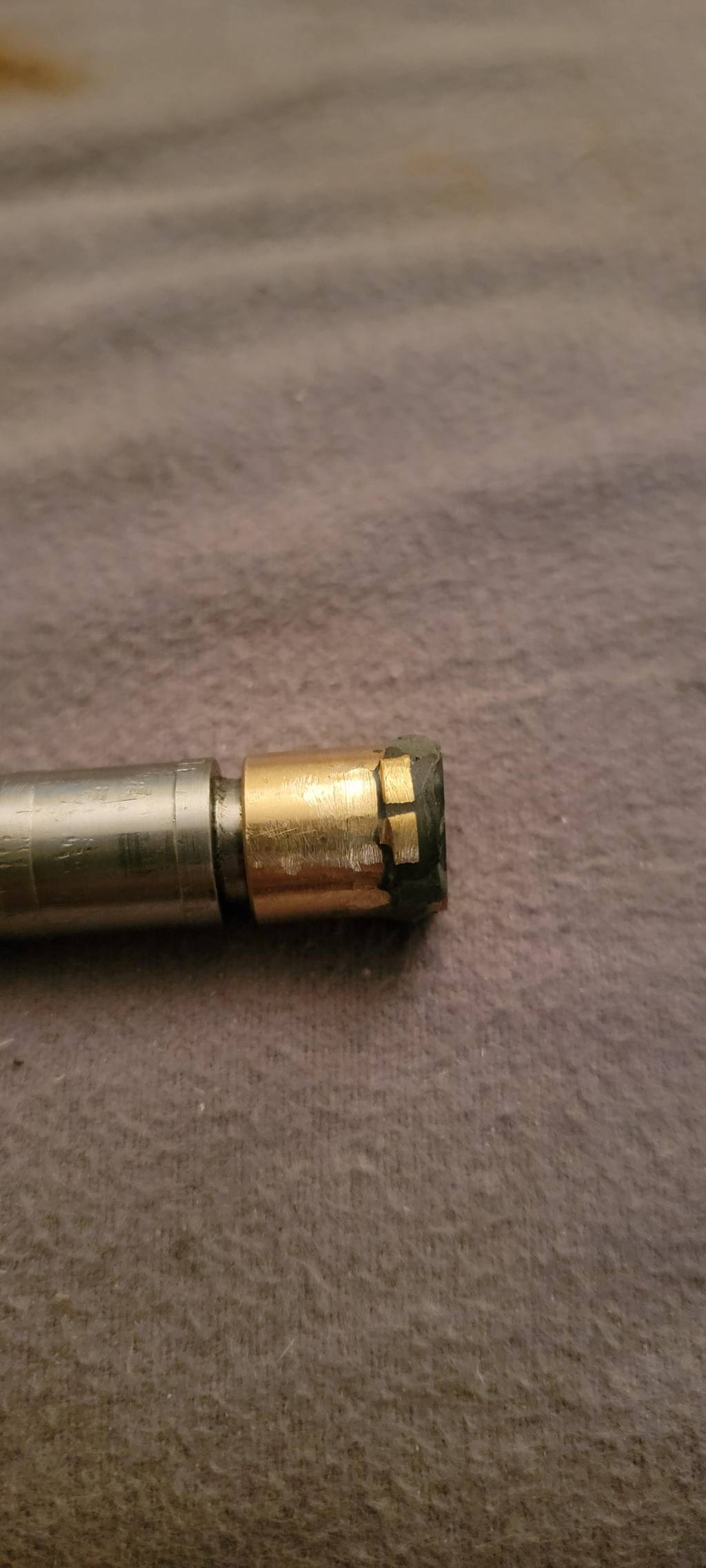

Ok well because the way the leshiy 2 works without a transfer port or probe it needs to use that shoulder to brace the barrel in addition to the 4 screws. The screws will hold it but I don't want to crank down on them so the barrel won't slide.
So need to mimic that circlip type thing the Edgun barrels use to sit against that shoulder in the block.
I chopped up a spare fx brass TP and JB welded some pieces of brass on the sides to sit against the shoulder. Crude yes! Functional yes! haha don't judge me.
But what really needs to be made is this part I badly drew up on the PC. Someone who is good at fusion 360 can whip this up pretty fast all the dimensions are there, and I think out of ABS or a good strength plastic would do the trick. Remember there's 4 screws in addition to this shoulder.
Part has flats to get an adjustable wrench onto and to slide past the roller bearing if coming in from the breech end.

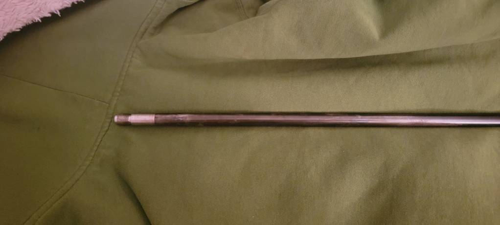

I have a custom .30cal 600mm barrel with a STX heavy liner and it performs really well. I would love to get one in .25 500mm.

I’ve had the barrel since the beginning of July, it was made by a very talented guy I know on Facebook who I previously purchased a polygonal .25 .450mm.I haven’t done a lot of shooting with the barrel and It has only been with slugs due to the pellet shortage.(NSA, Varmint Knockers and FX Hybrid)out to about 75 yards but the performance is really good.I don’t believe there’s any issues shooting through the FX liners. We just need to remember the L2 does not have a competition trigger so you really have to have good trigger control to get good groups.
