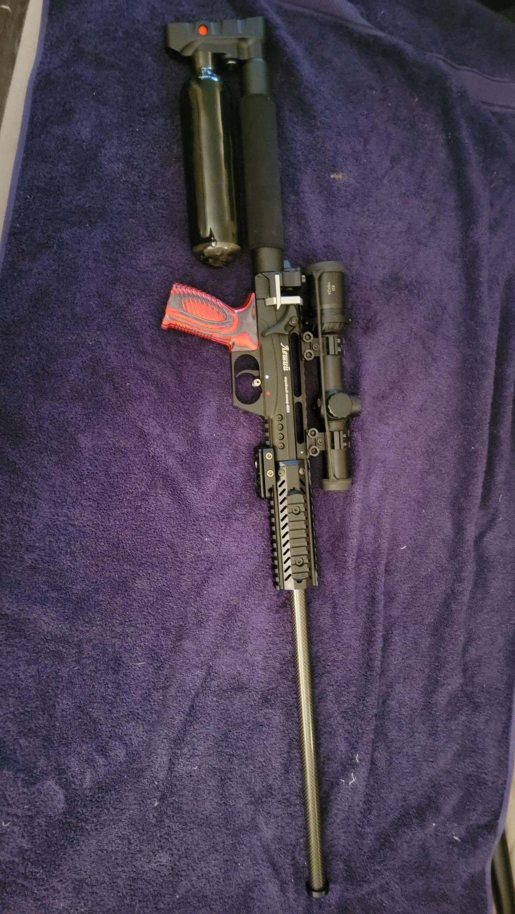

Wow that’s a long barrel. Have you checked over a chrony to see what the increase in velocity is ? It’s got to be good for at least 150fps at the same reg setting . I put a 530mm and thought is was long for the factory hand guard.
700mm .30 with a 20x14mm cf sleeve haha.
I’m gonna get the 30cal adapter and either run my 500 or 600 barrel. I might see if I can leave it shrouded with the fx mod.
I’m pushing 22 cal hades at 890ish, what velocity is that that 700mm 30cal pushing 44.75?
Nice, I’m wanting to hit about 70fpe with just adjusting the reg. So it will probably be doable! Easy swap for a winter coyote setup, if I can get 8 shots I will be good to go.

A bit of testing last night, raised the reg to 145 bar or so. And swapped the jets, but was only getting about 750fps. Baffled for a minute then realized I put 2, 1.3mm jets in heh.
Degassed and put in 2, .2mm jets in and voila 975fps. Very impressed for such a relatively low reg pressure. It's got looots more in it.
Maybe once I get the repr reg I'll tinker a bit more but definitely a good start.
