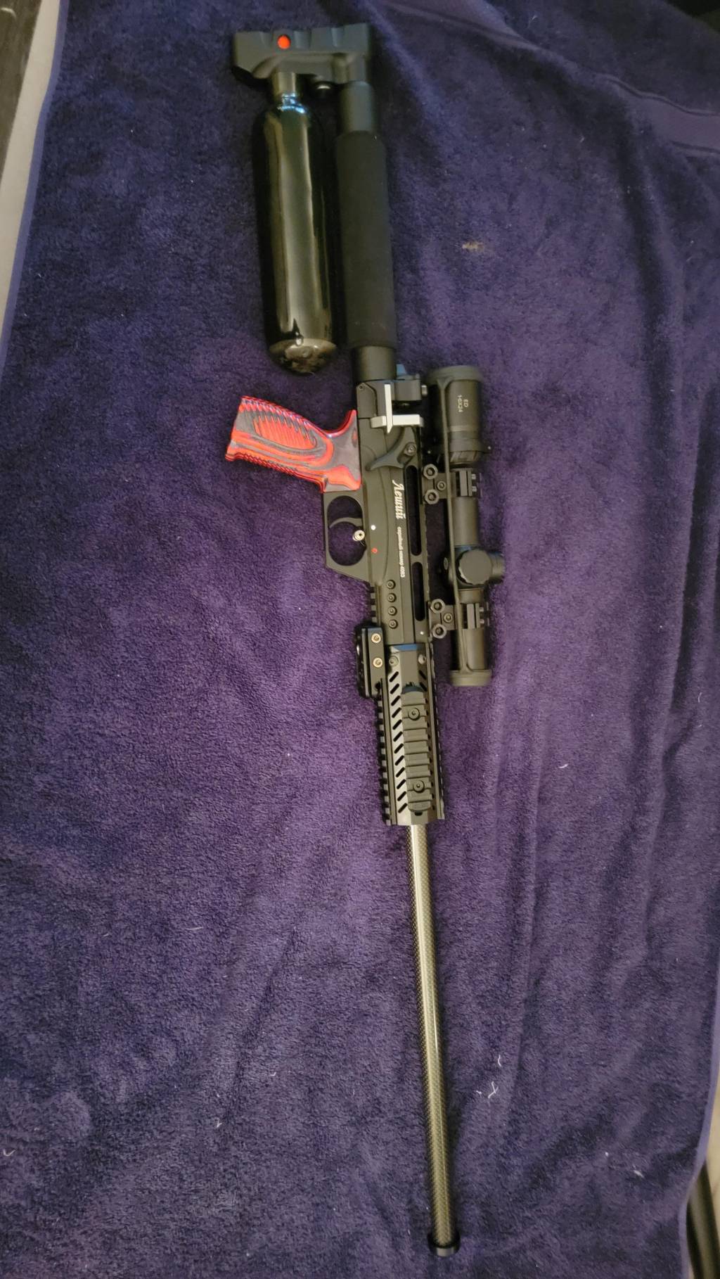

Last week I just replaced my .25 cal 700mm STX-A with a Superior Heavy. You giving me some ideas now :)
A problem I am seeing already how to support that long liner...a longer handguard maybe.
The handguard doesn't support the barrel at all, I used 20x14mm (3mm wall) CF then tensioned with the FX thread protector. I have some other ones coming won't look so goofy.
I threw on the .22 500mm setup and got 58fpe with JSB Beast. Not too far off 900fps.
I have that heavy liner too haven't shot it much yet.
Even with a 700mm it's a full 5 inches shorter than a Red Wolf HP with a 4 inch longer barrel.
Aliexpress.........
The 14mm ID was OK to slide on?
On my older 500 and 600mm barrel houses I had to open up the ID a little bit. On the 700 it slid right on.
To open it up I taped a piece of 80grit sand paper onto a 1/2" dowel and put it in a drill and ran it back and forth. Only took a few mins. Wear a good quality mask you don't want to breathe that dust.
I got 58fpe with the 500mm .22 and was curious what it would make with the 700mm .22. Both with beasts, got 100fps and 12fpe more with the 700mm so 70fpe in .22. I've kept track of how much I've adjusted the reg from factory and figure I'm between 145-150 bar.

You don't have to shorten it, OAL is 40 inches with a 700mm. That's 5 inches shorter than a red wolf with 5 more inches of barrel.
Looks long in the pic a page or two back but it's not bad and probably the same weight as with the 350mm edgun barrel. Even with a CF sleeve on it. (It's rigid)
