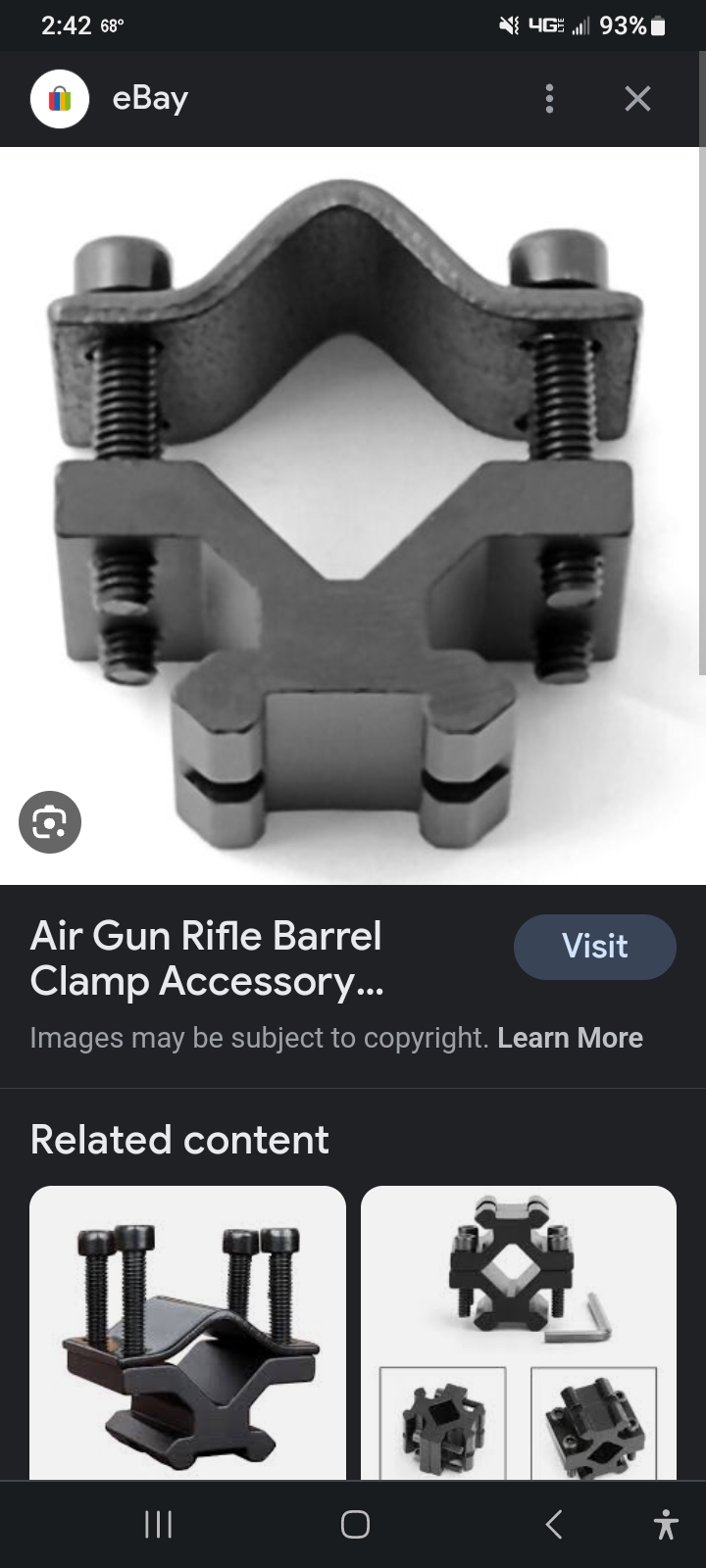

Why don't you go to Lowes or whatever hardware, get a dowel of similar size as the barrel. Mark where the sight line and sight picture needs to be on your existing rail clamps. Clamp the sight rails you have to the dowel (cut down into small pieces) and then drill thru the middle of the clamps where you need sight picture.
Of course it's entirely possible this may not work if you have to drill thru the bolts on the clamps.

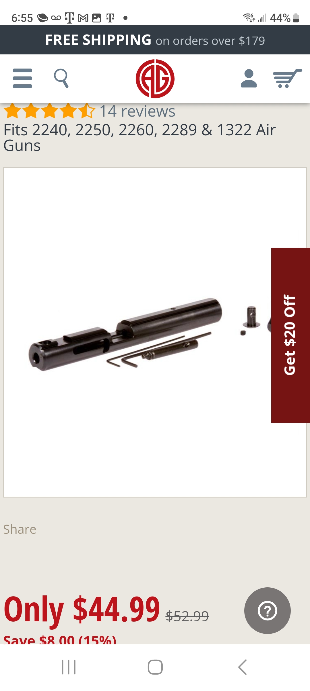

Also consider replacing plastic breech with steel one. Improve accuracy and tons of mounting options.

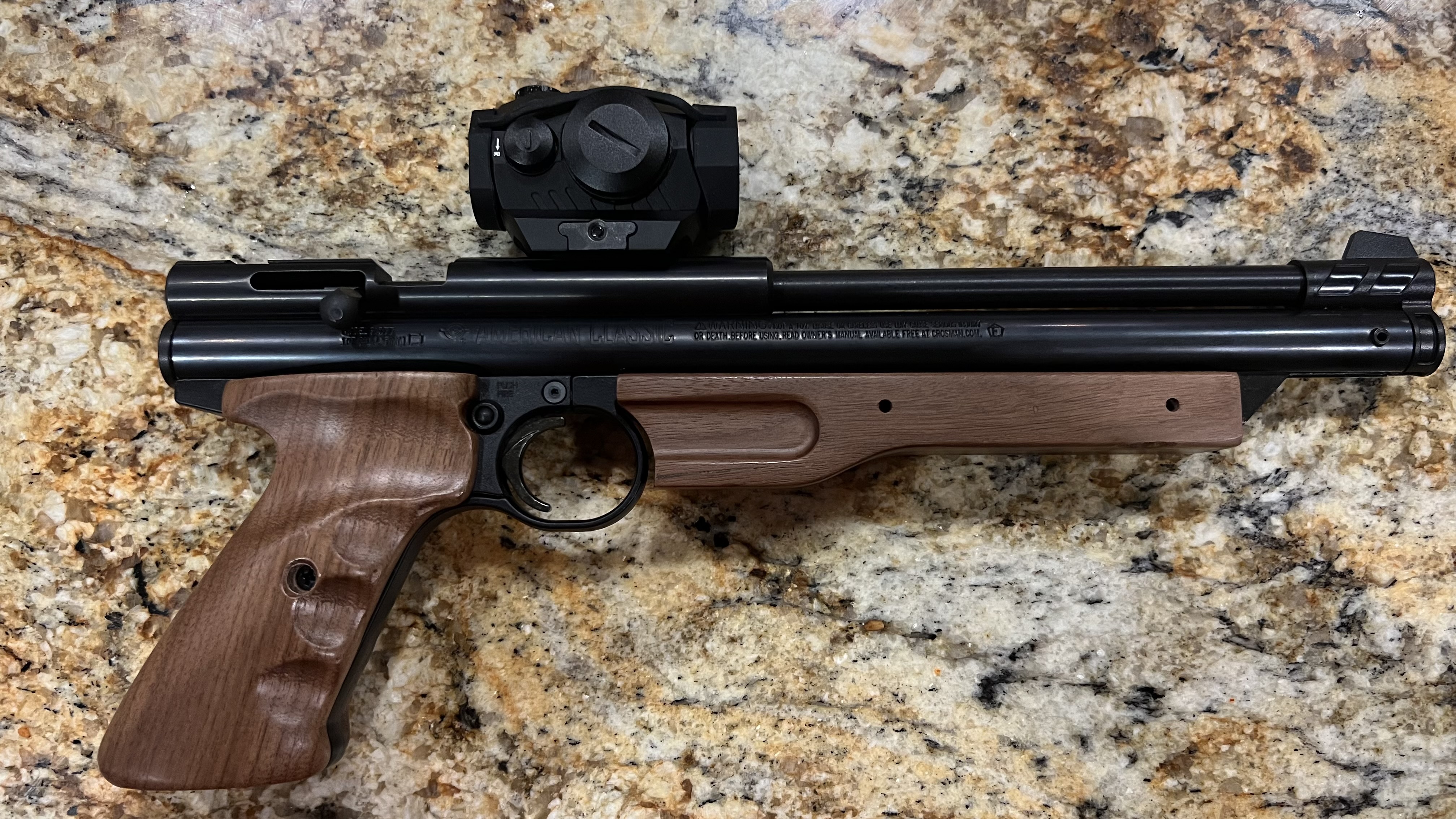

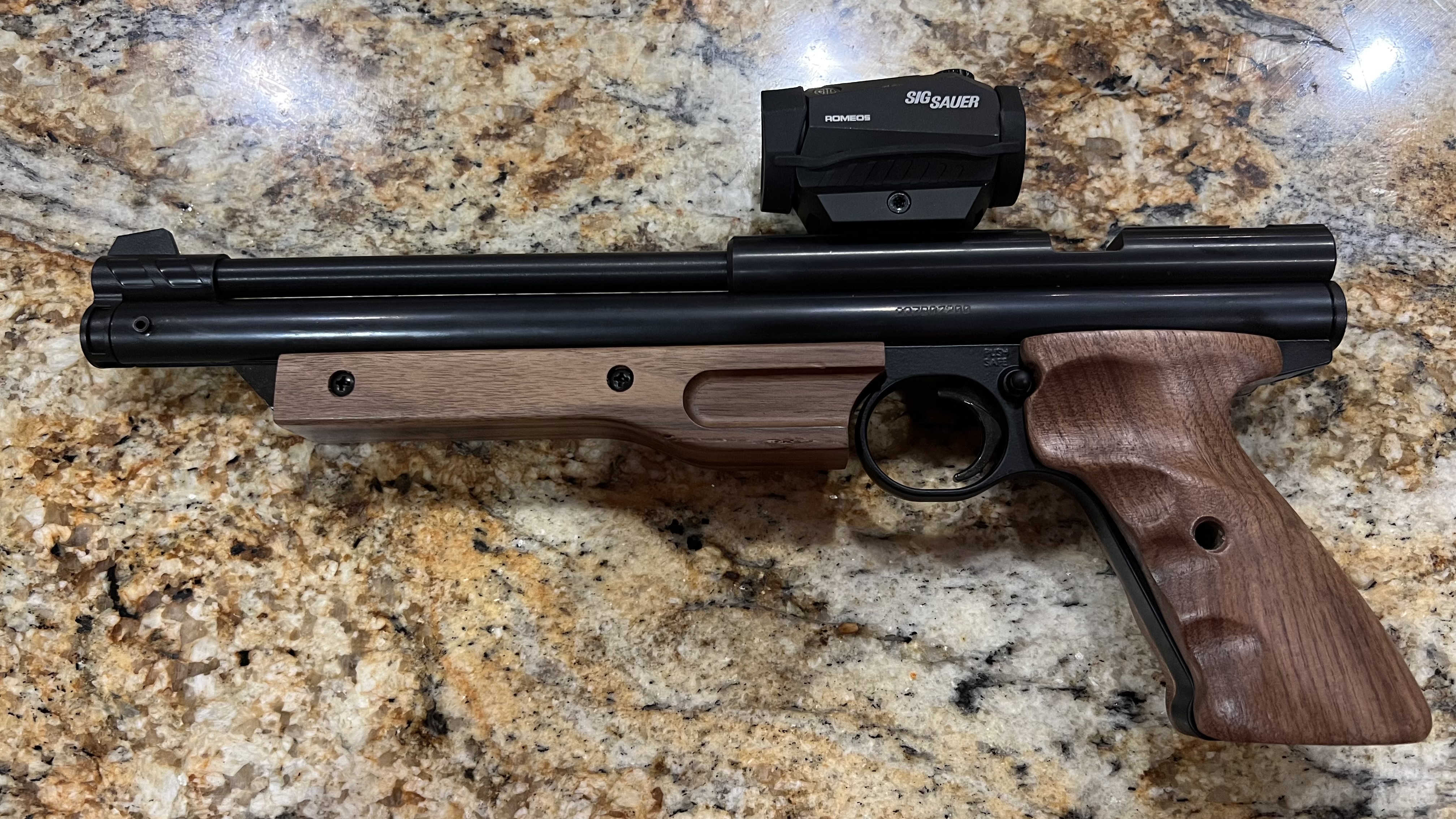

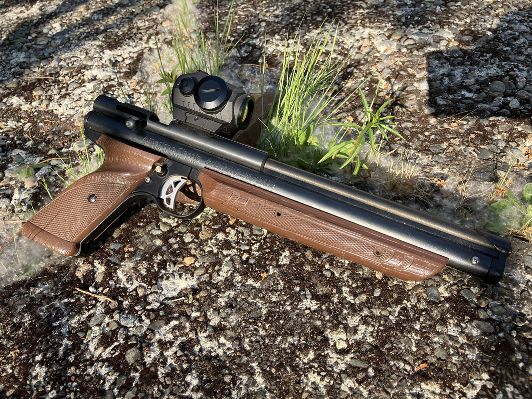

Crossman 1377 are really fun and quite accurate. I took out my old one bought 14 years agi and great fun with it, i started to upgrade it with the steel breech above , upgraded walnut, and sig redot. Shooting paper targets indoor at 15 ft with a homemade rubber mulch pellet stop. Lots of fun
There are no "existing rail clamps".
Steel breech solution costs over $100 for SB and to replace rear sight.
With the original factory set up. The barrel is being sandwiched in between two pieces of plastic. The breach and the front sight / end cap. That to me is not a very ridged place to mount a relatively larg and off center optic. The steel breach is an excellent upgrade. You say you want iron sights to help zero the red dot ? It’s not that difficult to zero a red dot.
Here is my suggestion. Shoot the pistol for a few months with the factory sight. Then buy the steel breach (with out sight)
Shoot it with the red dot for a couple months. If after this time. You still feel you need iron sights. Buy them.

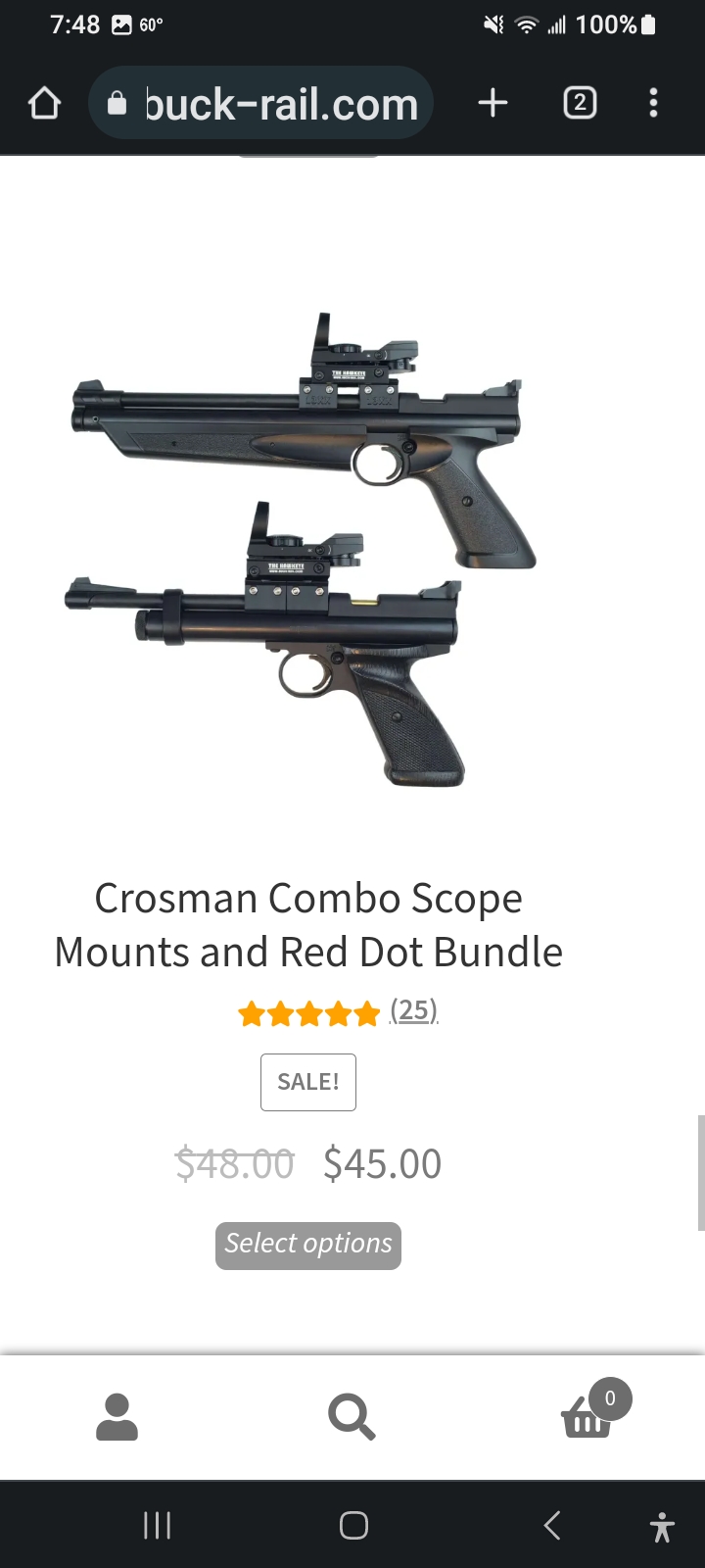

Two good suggestions for adding railings to the barrel. I missed the Buck Rail product before.

Also;*I use this on my Daisy buck. Different styles n such. Might be able to finagle one of these to work**they have the picatinny on it so I clamped.mine to the barrel and slapped a red dot on it.
Works great for me. Hopefully helps ya🎩🤙
I thought about getting one of these for my 1322 you have to remove the roll pin and front sight to installed it. I instead opted to 3D print one I found on Thingiverse Fits the barrel pretty tight and uses the clamping power of the red dot to hold it tight. I think it's a bit too long and the legs that rest on the lower cylinder are to big in diameter. Just put it on tonight so it needs more testing before I can say how well it works.
