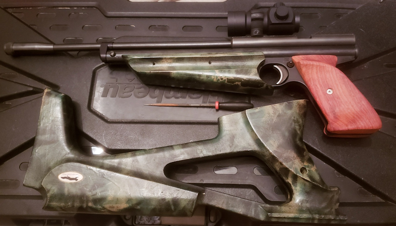

None of that will help. Use some silicone lube in the cylinder, and on the pivot pins both on the tube and the pump linkage. Other than that it sounds you are gettig good compression. I used mine so much the plactic pump arm eventually broke. I bought an older pump arm that was more robust, but due to the geometry, it was even harder to pump. (had flat top piston/valve that makes it even ahrder to pump) Started actually hurting my elbow joint. So I pulled the trigger on a Tom West stock that I'd been watching on ebay. Had been marked down $20. Main reason being, the pump arm geometry is superior to most I've seen. Much longer, and the angle of it is a mechanical advantage, too. Had that stock for some yrs now, and my 1322 has seen many many revisions.
Old pump arm
Old pump arm

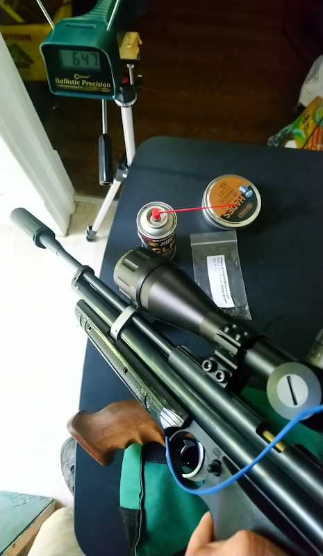

Hmmm, sorry for being late to the party. I put a steel breech on a 2289 (never done one before) and it pumps fine. I can tell you this, that whenever I put pellgun oil on the piston cup it makes it even easier to pump.
🤔I've been using 3in1...but I finally got ahold of some Pullgun oil😅
I'll try it next time I oil the 2289🥴

Tried the pellgun oil!
Holy money what a better difference!👀
I was using regular Ole 3in1 oil. Shame on me now 😅
I even had the lady verify.
She couldn't do but barelyyyy do 2 pumps before. Now she can manage almost 4.
For me; I oiled and started working the pump. 3 pumps in and she started to get easier. Now I can get it to ten with about half the force I was using with 3in1 oil🤓
First hand experience has given me a change of mind for oils for sure😅
3 in 1....coming iut of my tinker tool box and going back in the regular ole toolbox🤣🤷‍♂️🎩🤙
