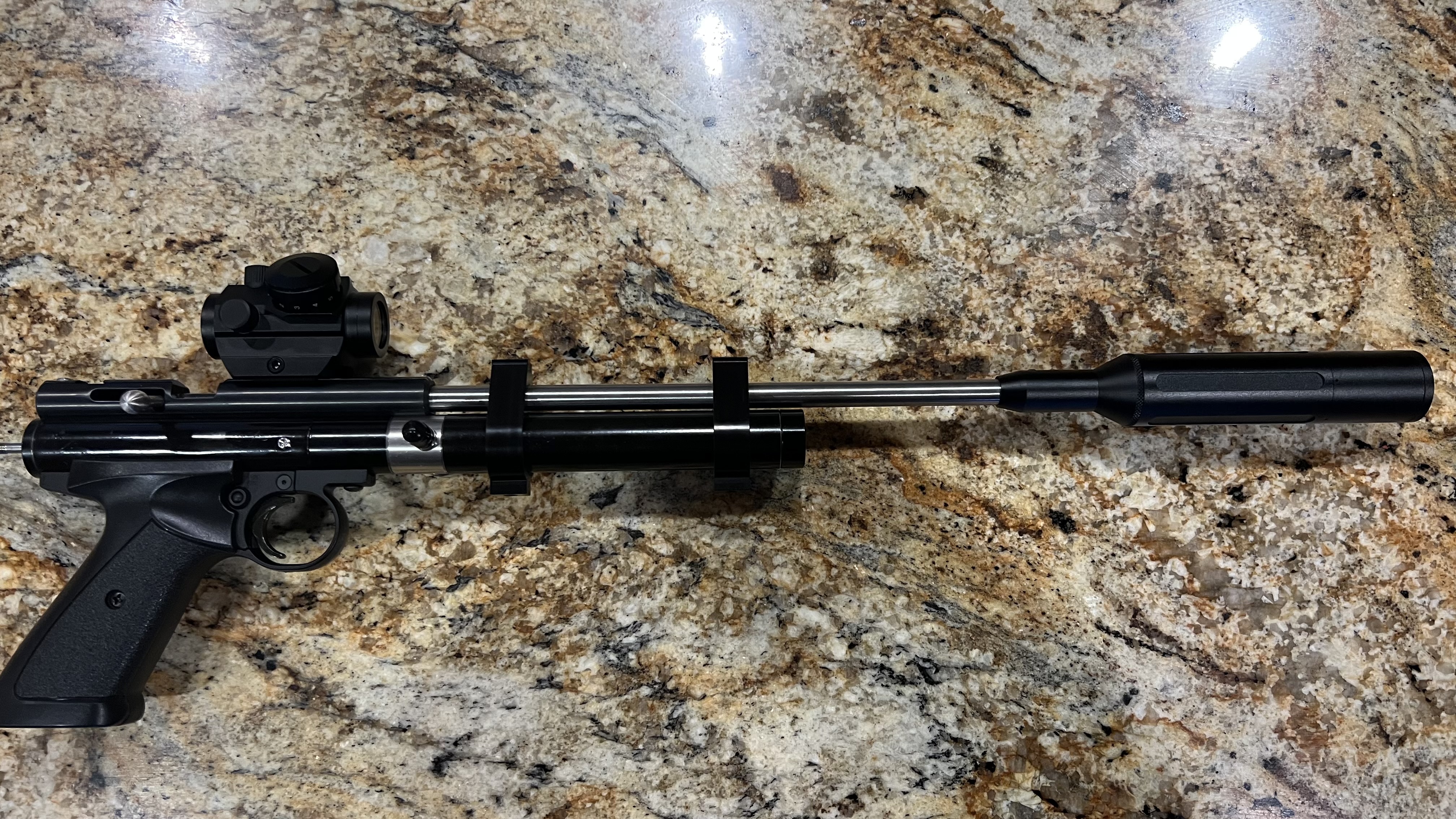

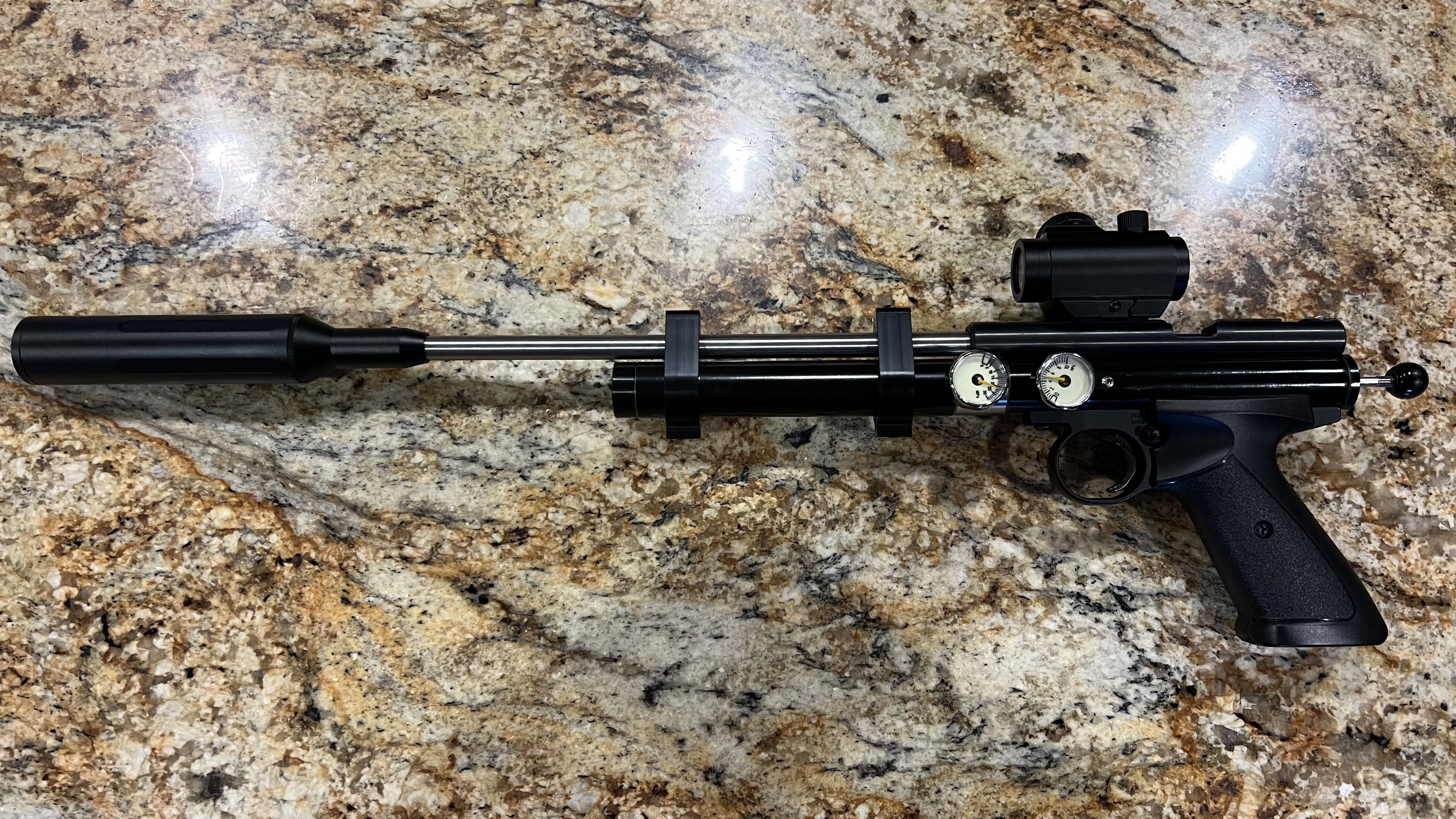

Got re interested in the 1377. Got a new version from amazon for $50, saw on ebay that there is a regulated dual pressure gauge conversion kit. $89, Steel breech conversion kit from pyramidair $50 and a polished 18inch barrel $60. Will add a better reddot and donnyfl adapter and tanto to lessen the bark when arrives
Added the adapter and tanto. Way way more quiet.
New pcp airtube and barrel bands in place

Need trigger grip assembly from donated 1377. Exchange the part in the grip that releases the hammer(included), put on regular 10.25 inch barrel on the 1377. And you are done, pcp chamber comes pre built, regulator is adjustable. I have filled it to 3000 psi. No leakes. Able to go to 4000 but I have reservations to push it that far.
The 18 inch barrel upgrade is optional.

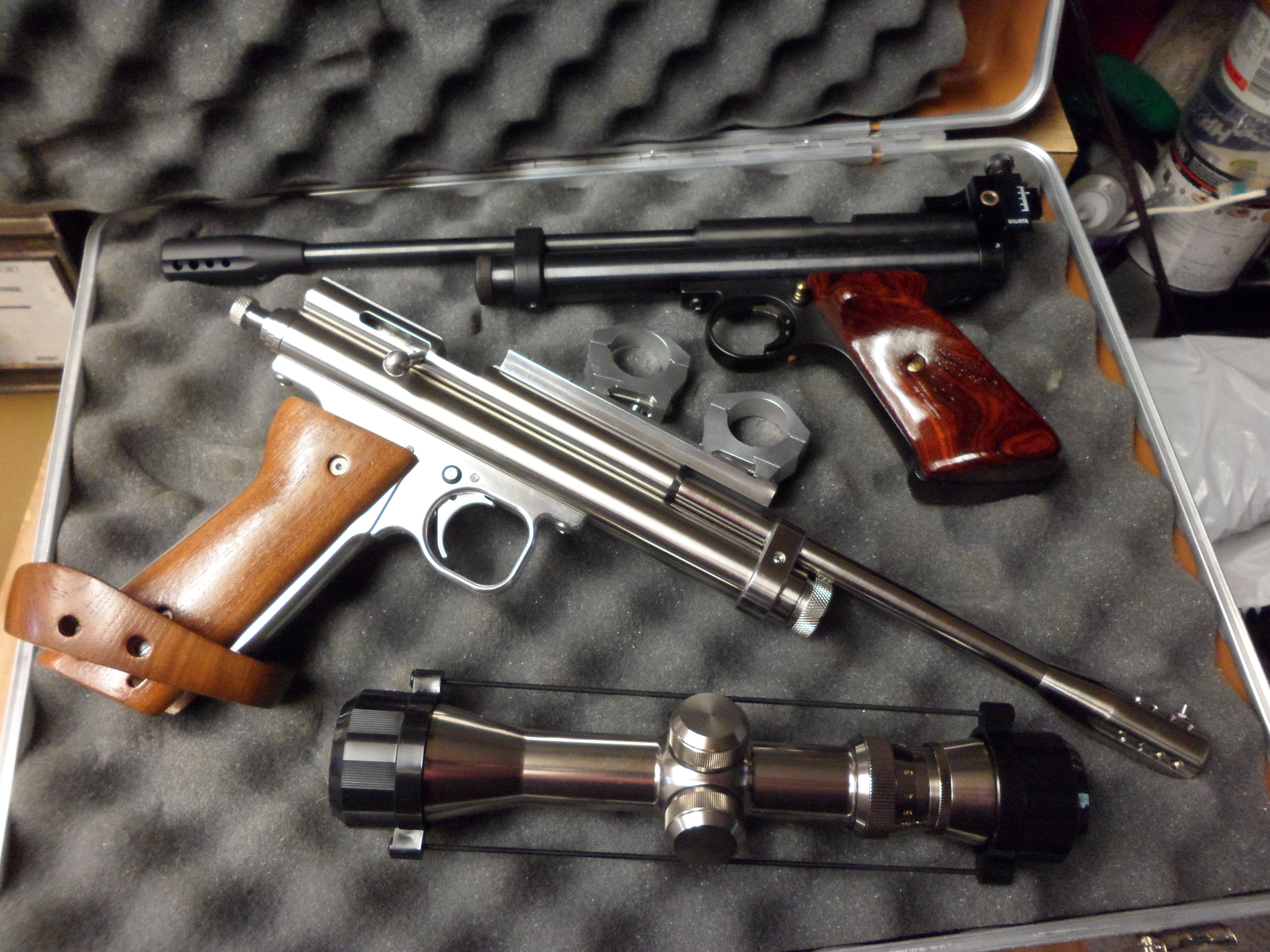

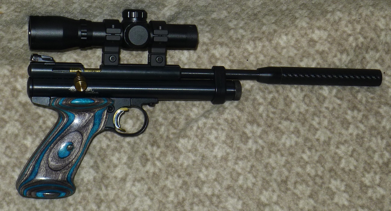

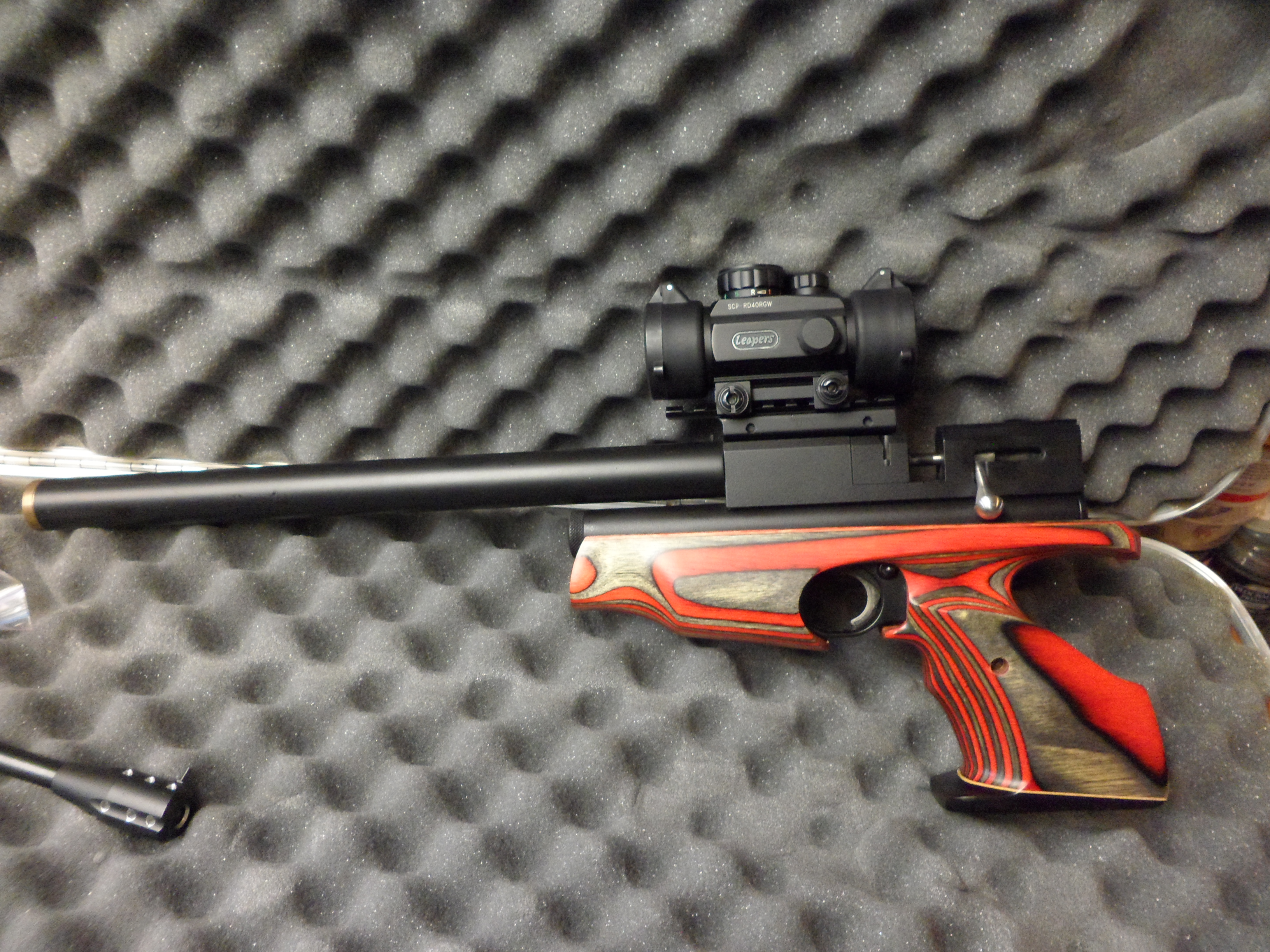

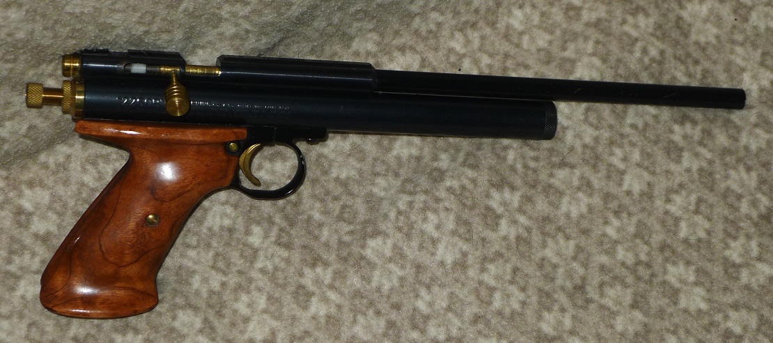

that is a Chaser 13 inch barrel this and that
the silver 2240 with scope would cost over 800.00 to build
the other pistol is a Venum Build with Steve Corcoran wood uses Marauder mags, i have never seen another but there have to be more
and this hobby is a money pit that is very big
and i am just a tinkerer no great builder, want help in this hobby is a great imagination and then be able to find the pieces to put it together
most of us have just hand tools a drill press maybe so we have to find ways to do jobs that need bigger tools
cut barrels using pillow blocks and just a drill but as i said imagination
