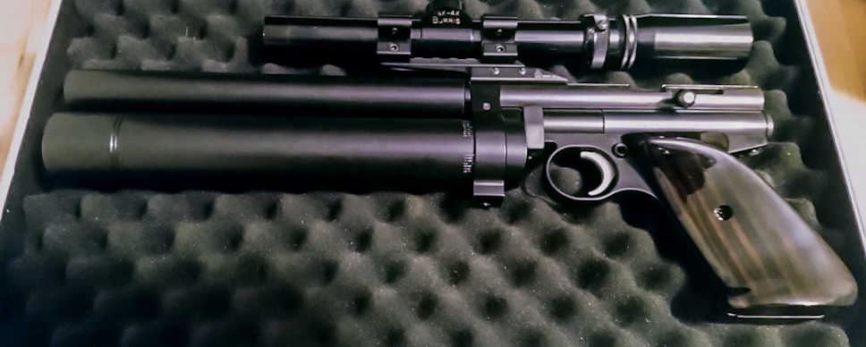

This is my pcp 1322, only original piece is the rear section of chopped air tube. Don't ask how much it cost :ROFLMAO: I built it myself and just parts alone totaled up is pretty stupifying. To be fair, the power output, capacity, huma reg, accuracy, and the fact that it's got a very complex and effective integrated baffle stack (as well as reflex shroud). Make it about priceless imo.

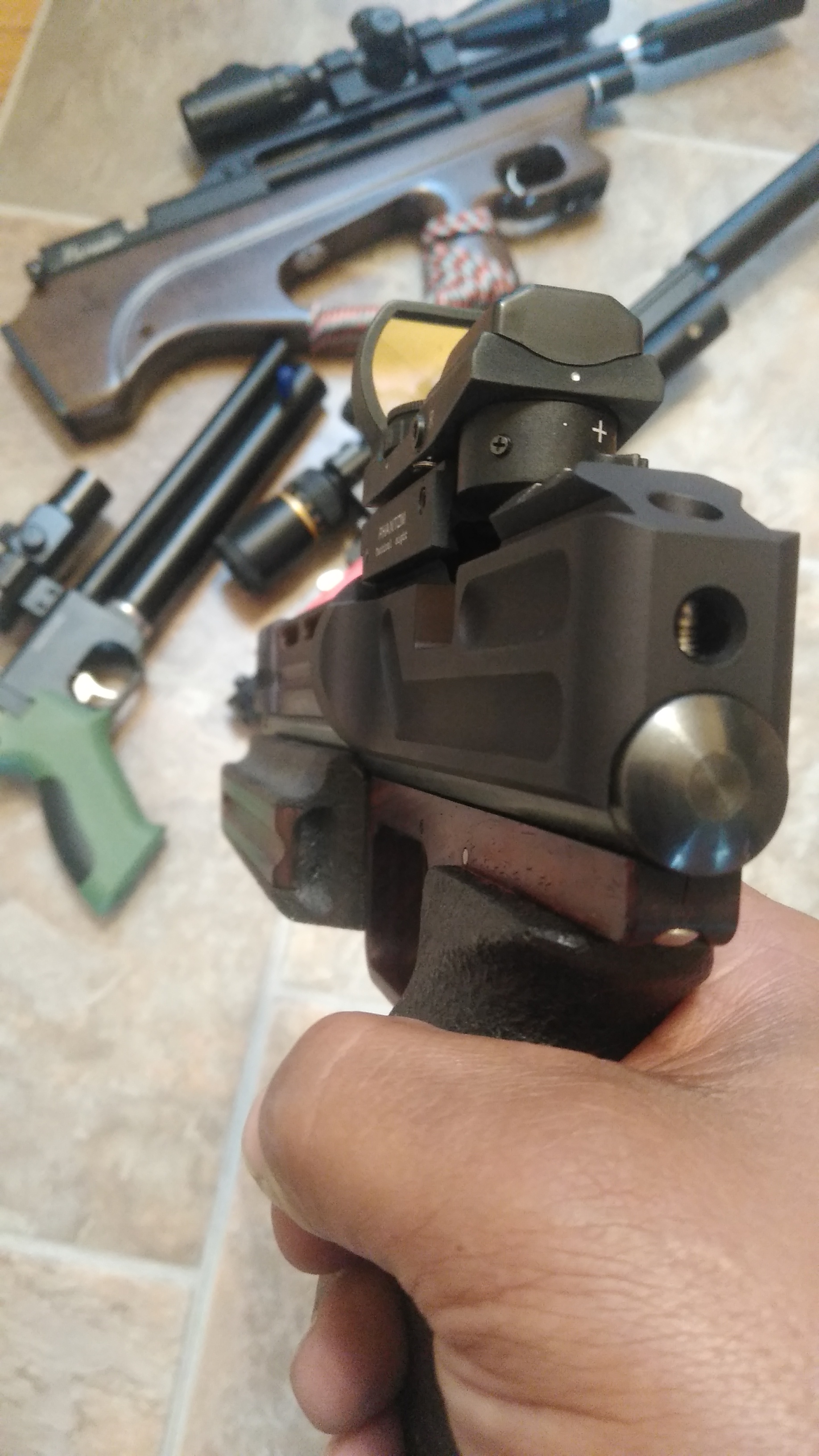

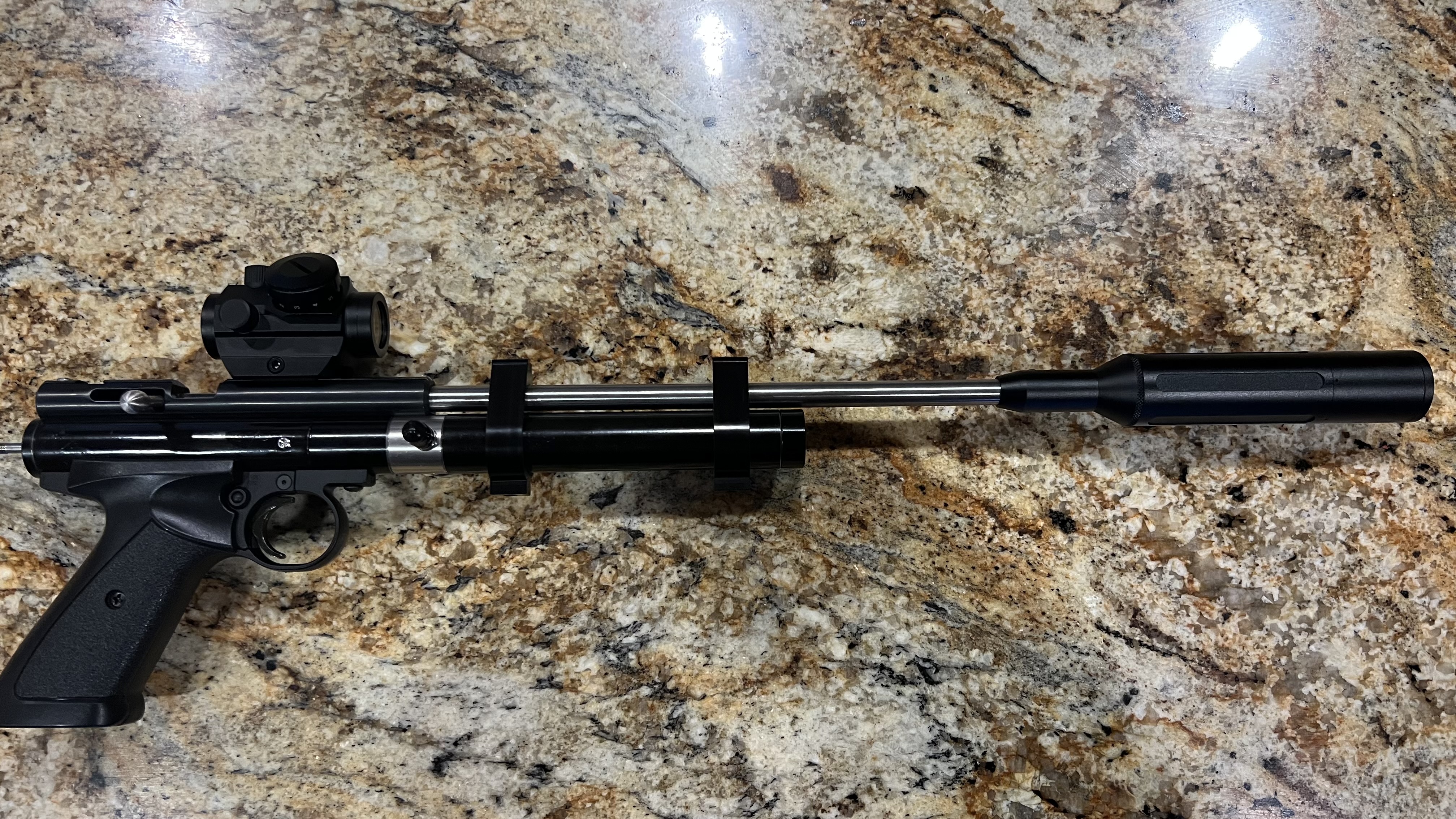

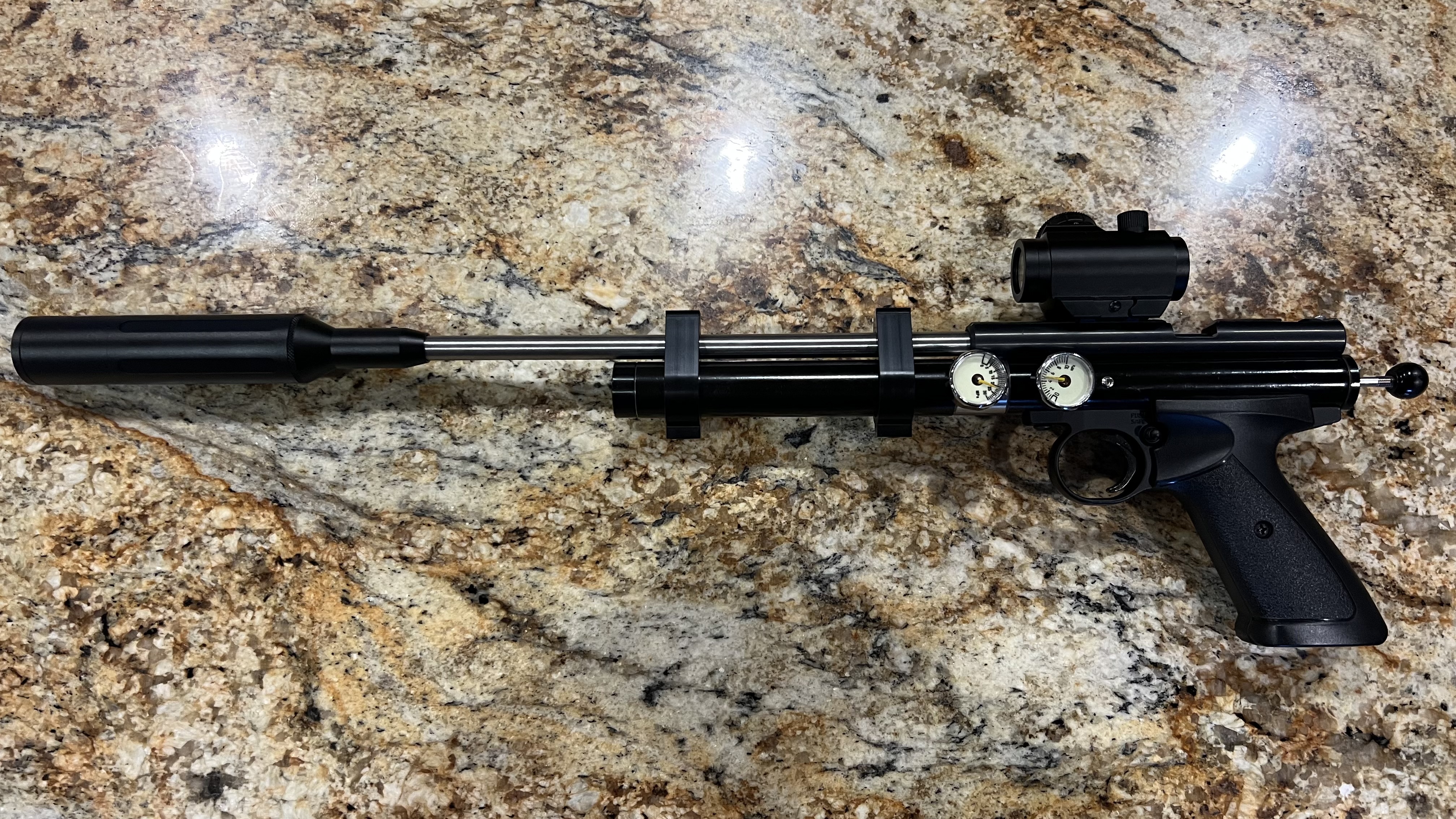

Got re interested in the 1377. Got a new version from amazon for $50, saw on ebay that there is a regulated dual pressure gauge conversion kit. $89, Steel breech conversion kit from pyramidair $50 and a polished 18inch barrel $60. Will add a better reddot and donnyfl adapter and tanto to lessen the bark when arrives
Added the adapter and tanto. Way way more quiet.

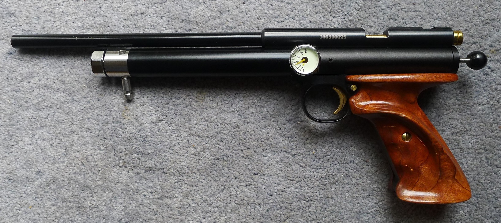

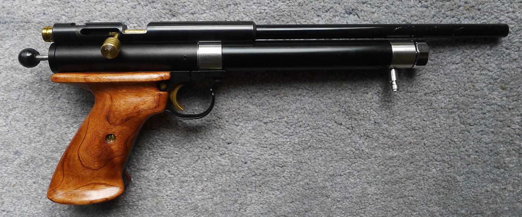

Got my conversion kit via Amazon today and installed on my 2250. I had forgotten that I purchased the 2250 from a custom builder 15 to 18 years ago (it has been in storage for the last 12 years). I also forgot that I had it built with a .20 cal. 12" LW barrel. The barrel/receiver TP and valve TP have been opened up and tubing used to connect them. The new conversion PCP valve comes with a connector for a stock barrel/receiver TP. Had to cobble up a connector to get the conversion working but will make a better solution next week. Just checked the system function today. Filled to 210 Bar and the regulator is set from manufacturer at 80 Bar based on provided gauges. Ran a quick test to get initial velocity data. 10 shots of H&N 11.42gr .20cal pellets averaged 589 fps. Seem to be using a lot of air. May be leakage at the TP. Overall, it looks like this will be a good conversion for PCP in a 2250 if I can get air usage under control. By the way, no documentation is supplied with the conversion kit. Also, the original cocking arm does not cock the pistol. It only allows you to load the pellet. The black ball at the rear of the valve section is pulled to cock the pistol.

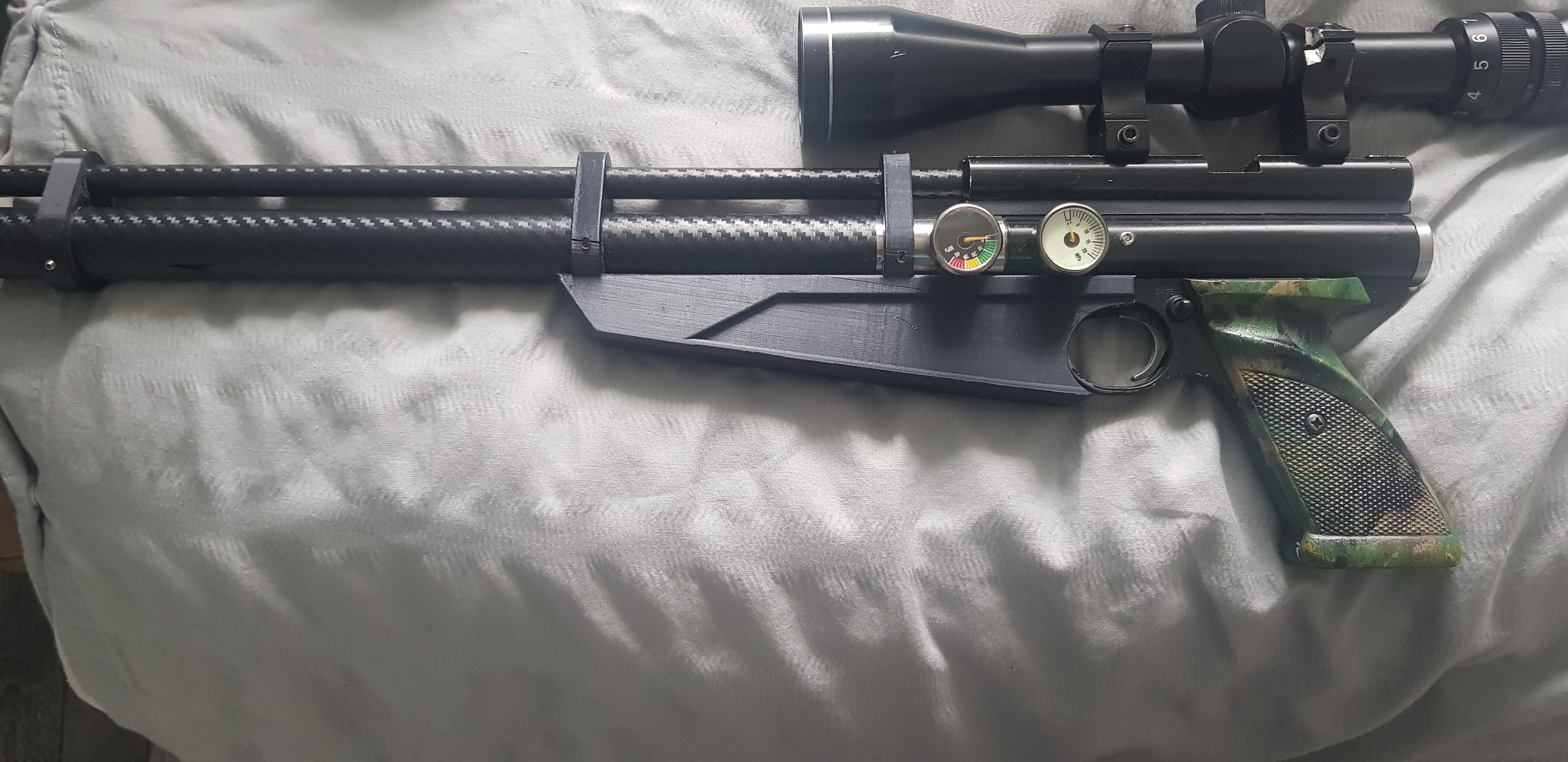

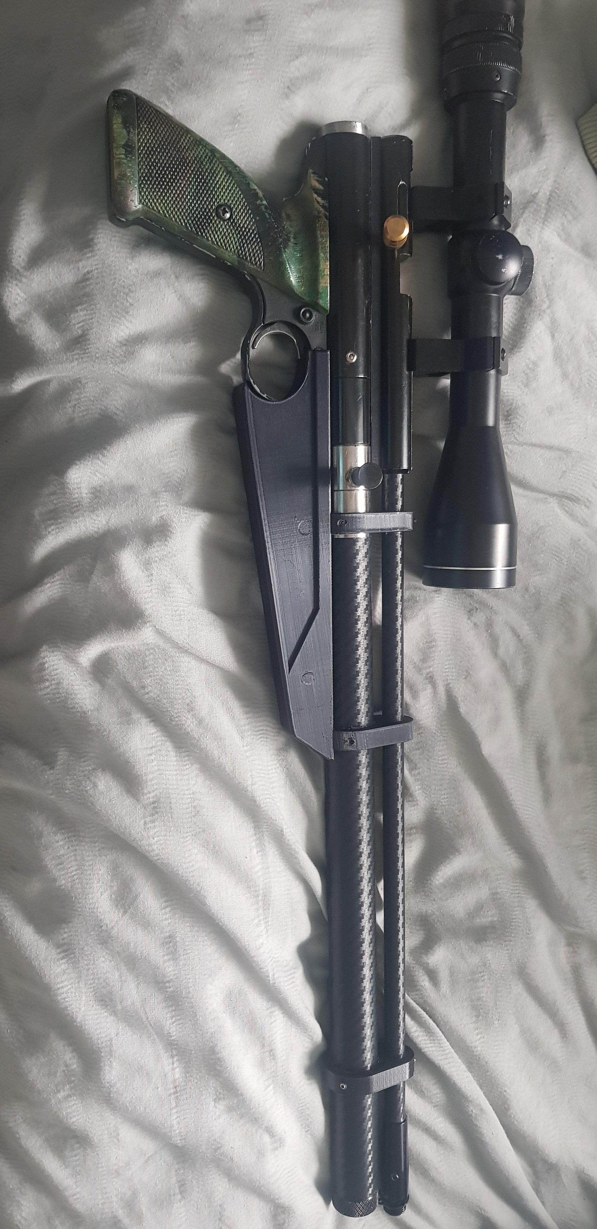

New pcp airtube and barrel bands in place

The air tube is unrestricted by the regulator as it's in the gauge housing.
