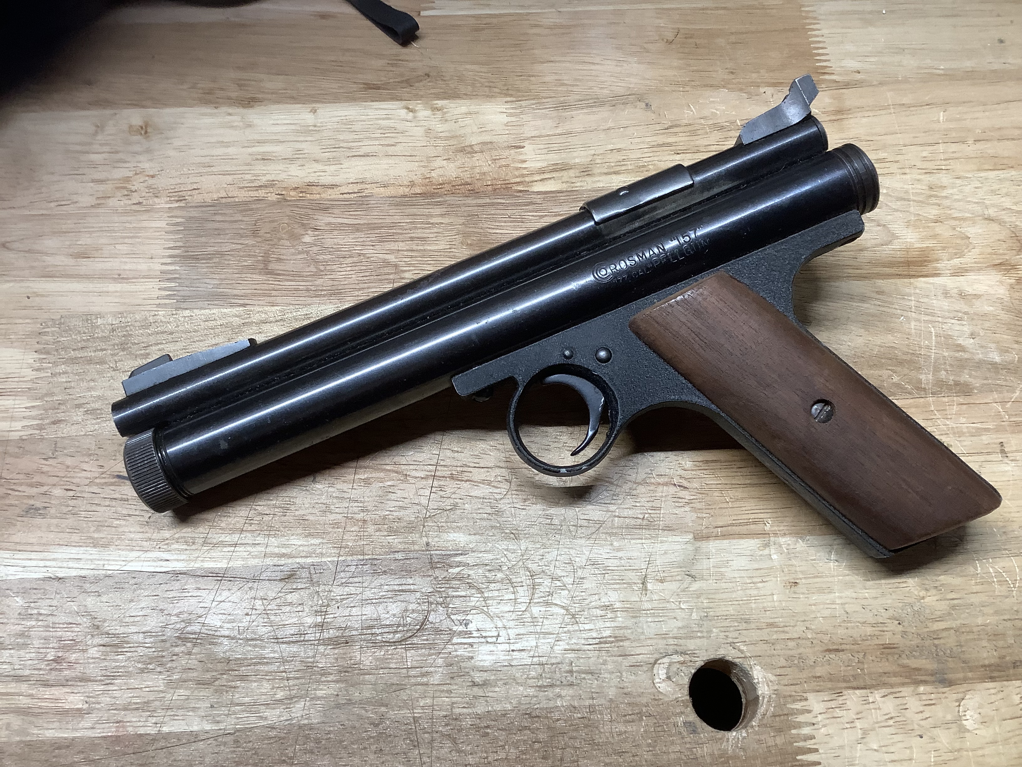

just bought a Crossman 157 resealed at Toy's show .177 ANY hint as to shot count or days unshot that a cartridge lasts ?
My plan was to shoot one shot per day and see how long it go's

thanks . time now here is 1pm the 24 hour mark to see if a leak is in this gun , so out to shoot for a while .
ok shot 46 till just a click heard = no C02 , last few pellets were very slow , just wanted to see , now i can shoot till i hear a slower shot .
OH 58 degrees outside , 10.5 grain Crossman domed ( got on sale TS @ $6.50 ) most likely will shoot H&N 8.64 match FT and 7.0 Wadcutters
