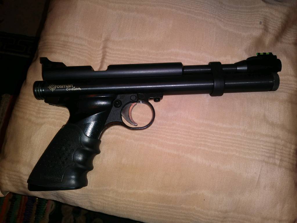

I chose the standard 2240. I wanted a steel breech but I also wanted the bolt handle on the left side. I shoot a pistol right handed so it's easier to reload with a left handed bolt.

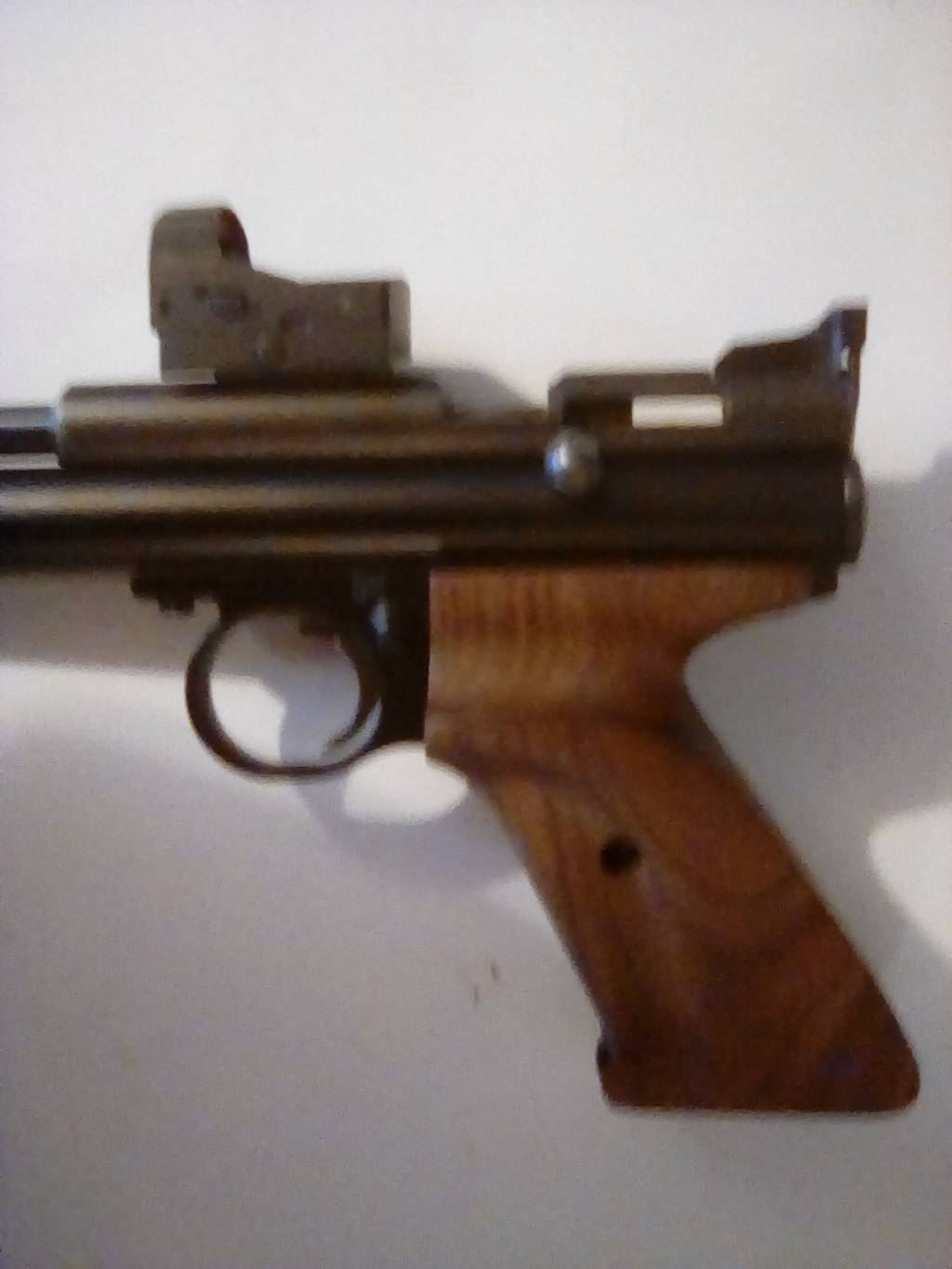

I bought an ambidextrous (I probably misspelled that) steel breech from Alchemy Airwerks. This gives me the the option of mounting the bolt handle on either side. It also has a dove tail to mount your red dot and you can still mount the original factory rear sight as I have done.
I have recently purchased the 2240 and modified it to my liking If you like to tinker and do your own upgrades that is the way to go. If you want to add a scope and just go shooting then the 2240XL is perfect. If I buy another Crosman pistol it will be the xl. Mine was very accurate right out of the box and from what I have read you would need to pay several times the price to get a more accurate gun.
