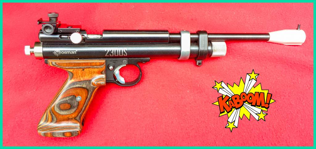

Tuning Crossman 2300s upgrade recommendations.
Super sear
Steve Corcoran Grips
Trigger Shoe
SS Trigger over-travel screw
Bling from Alchemy Airwerks:
Fill knob
Bolt handle
Power adjustment knob
SS Safety
SS Grip screws
Extra barrel clamp.....

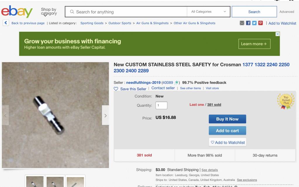

What kind of trigger pull does the super sear give, and is that the one on ebay.
I have been looking and thinking and cannot find anything on the SS safety, and power knob and fill knob, can you steer me toward sources/links?
