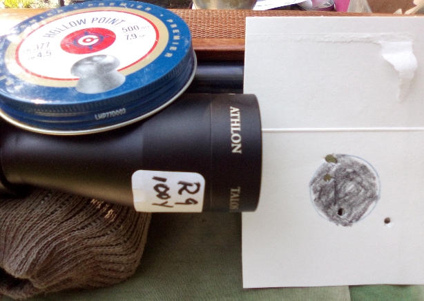

Thats not what I said at all. I said, "Were you reviewing the weather or the pellets? Any pellet shot in the circumstances you shot them in could give you similar results." He got horrible results at 37 yards, I stretched it out to 100 yards and got 'em all in a 6" group!

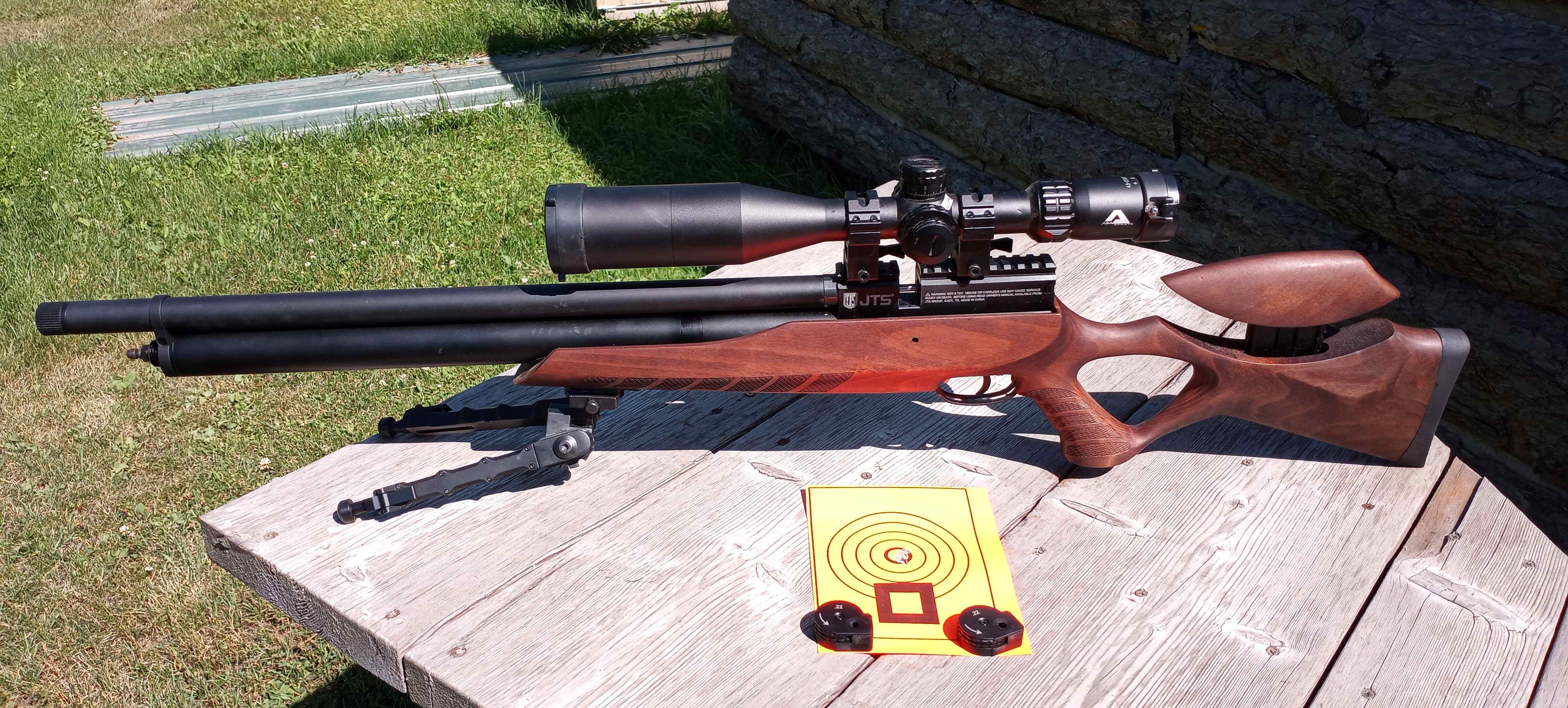

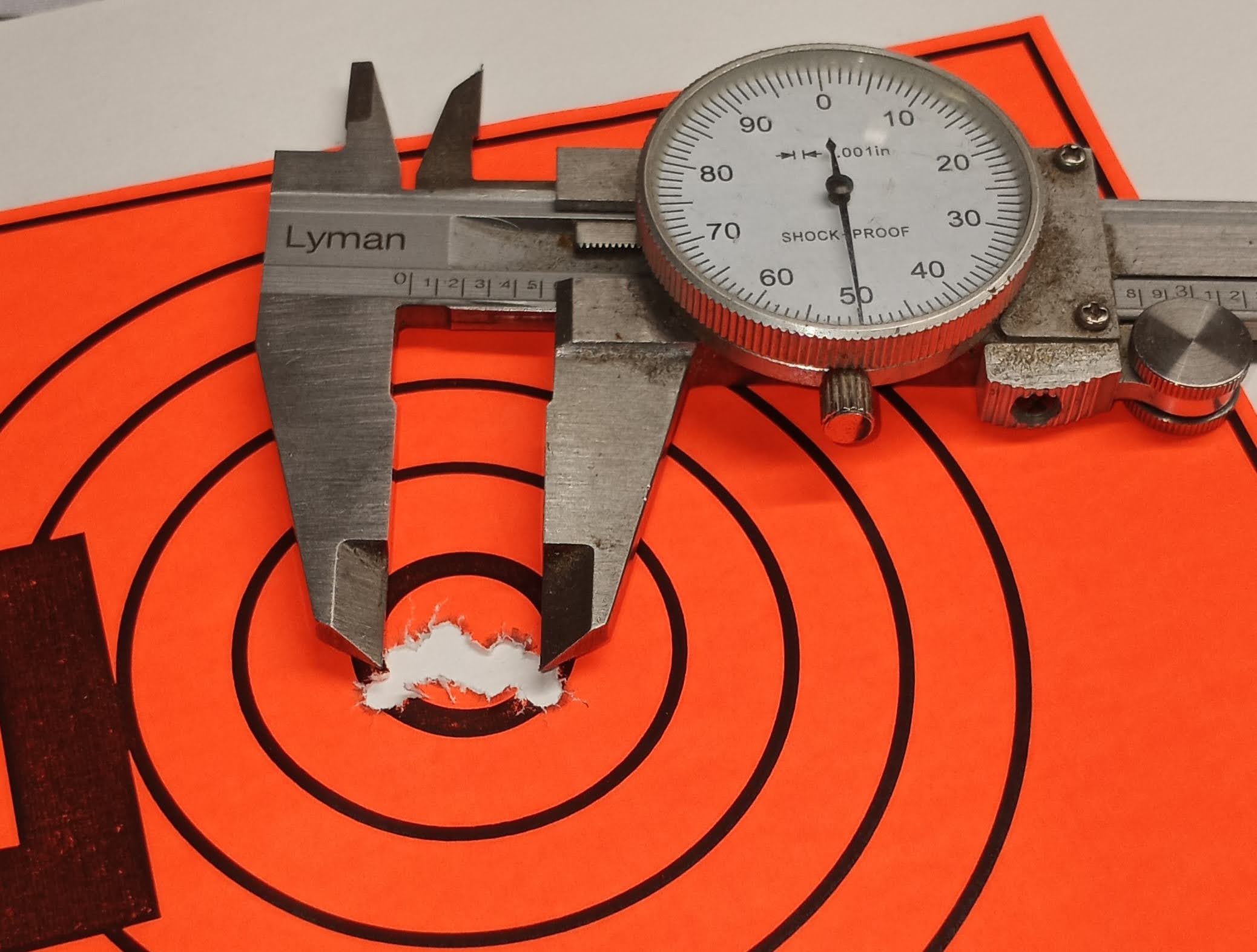

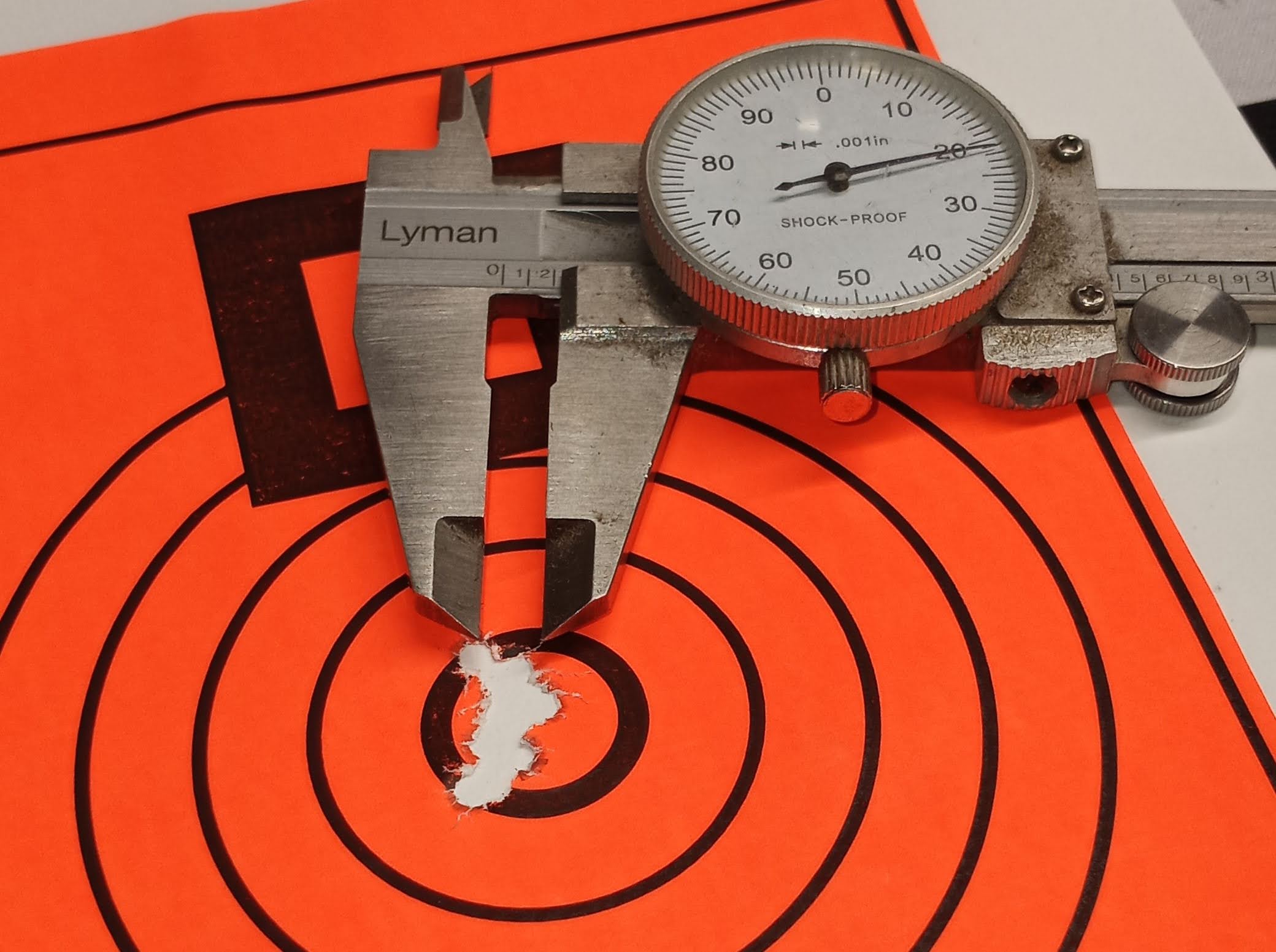

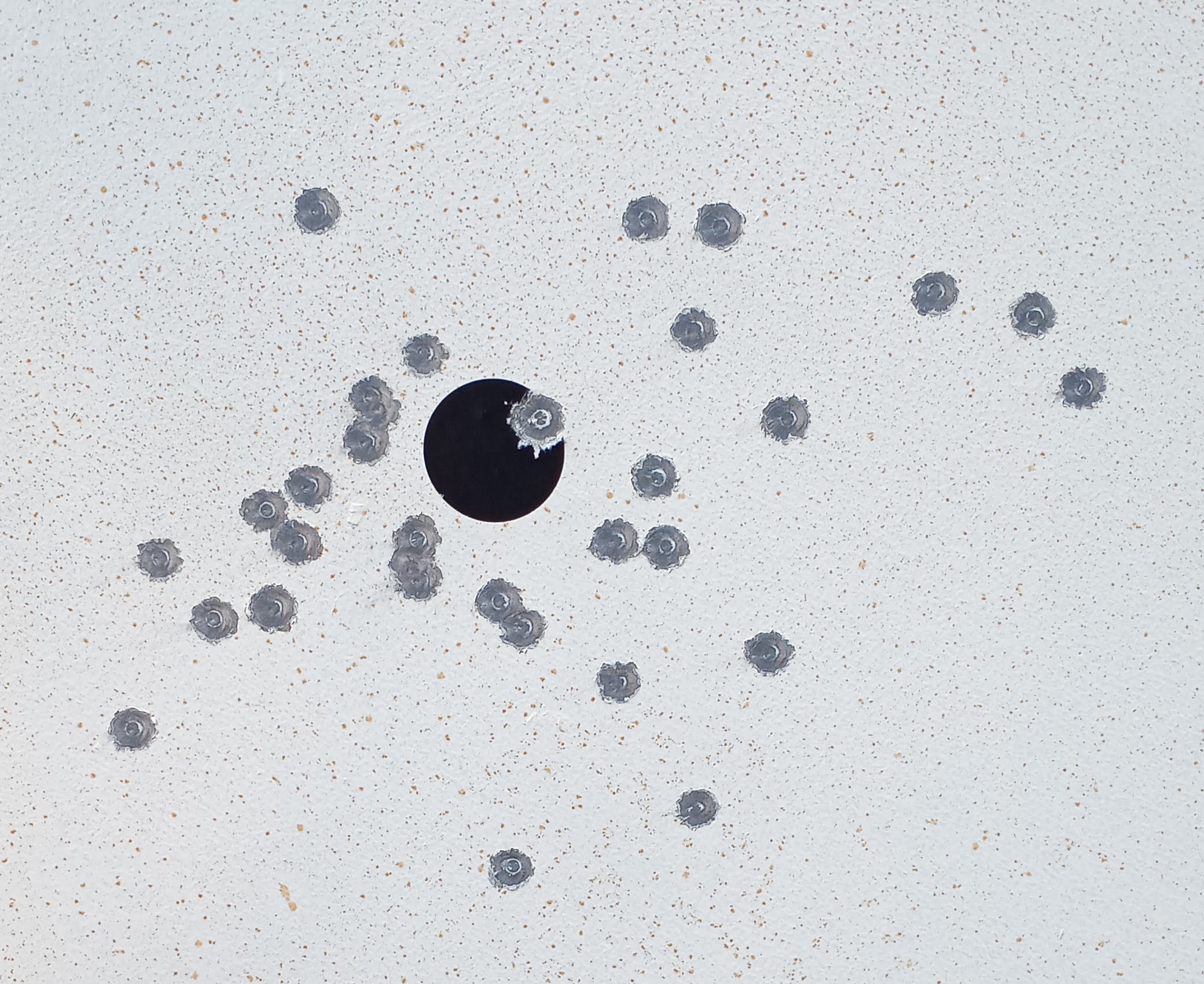

I was getting ready to do a little JTS MAX moderator 'thing' today so I grabbed the MAX in .22, filled 2 mags with CPHP's, grabbed an old cooler and a target, the winds were about the same as in the video, 5-7mph at a measure 37.5y.
I have already played 5 cans of CPHP. At a distance of 15-25 yards and 875-900FPS, CPHP is a precise pellet, which can completely replace the pellets of more than 20 dollars. From 35 yards to 50 yards, the group consistency of CPHP becomes worse. At this time, if using the dome pellets, the group will tighten to 1/2 inch, but occasionally fly solo, I can't find the reason.

Then what do i expect from $7 500 count walmart pellets ? Surely not this at 75-100y ( 5 shots). Yuck...
