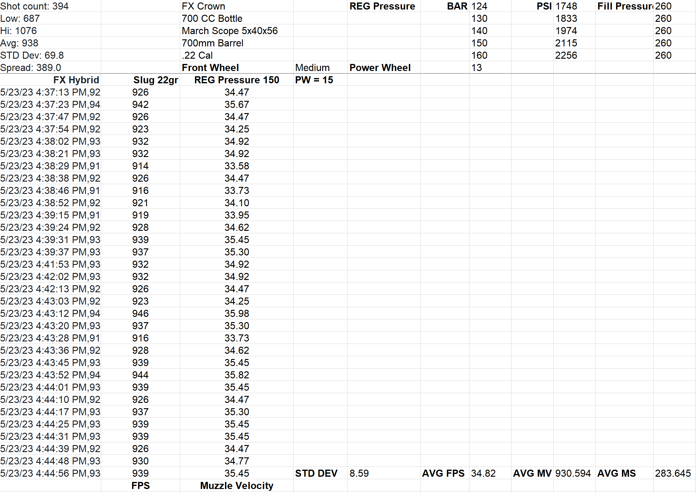

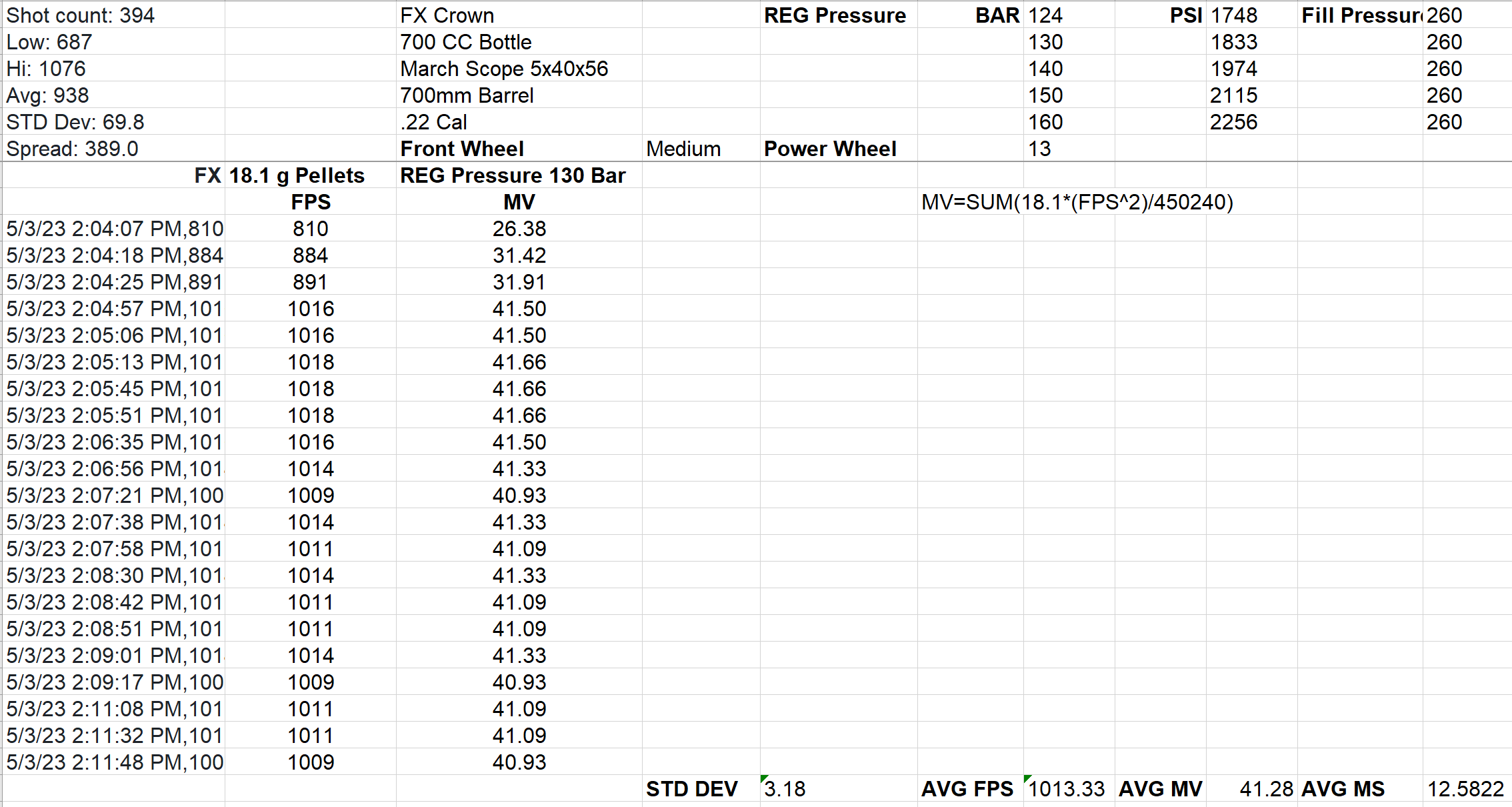

Currently working on a .22 cal FX tune for 100 yards, I found accuracy beyond 75 yards was very elusive. I have installed an FX Slug kit, and a 700mm Superior Heavy Liner and adjusted the hammer screw under the power wheel. I am finding the best results with a pellet: FX 18.1 gr at 1033 FPS and 22 g FX Hybrid Slugs at 930 FPS. Reg is set at 150 Bar, the Front wheel on medium, and Power Wheel at 13 and 18, respectively. I am getting close. I hope 160 Bar will bring the accuracy I am looking for at 100 yards. Currently FX slug group is around 2 inches. My goal is sub 1 inch which the Crown is capable of.
The question for the group is running the reg at 160 bar near the max pressure or should I look at swapping in a high-pressure Huma regulator?

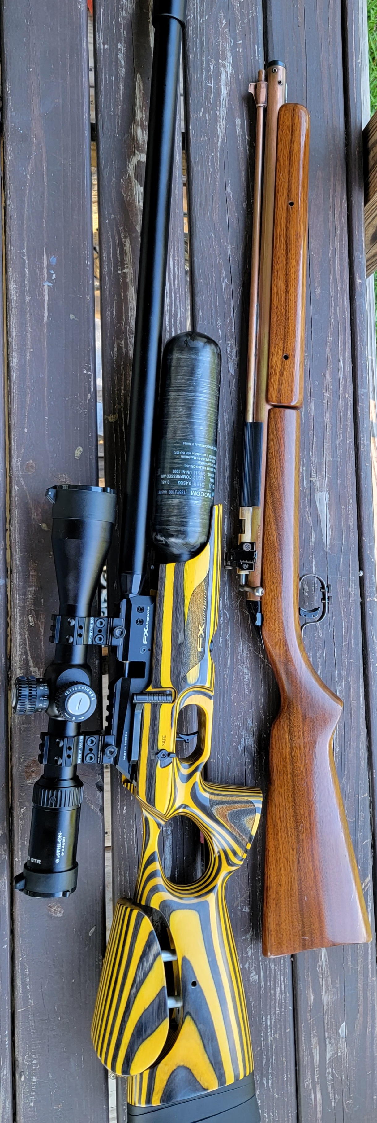

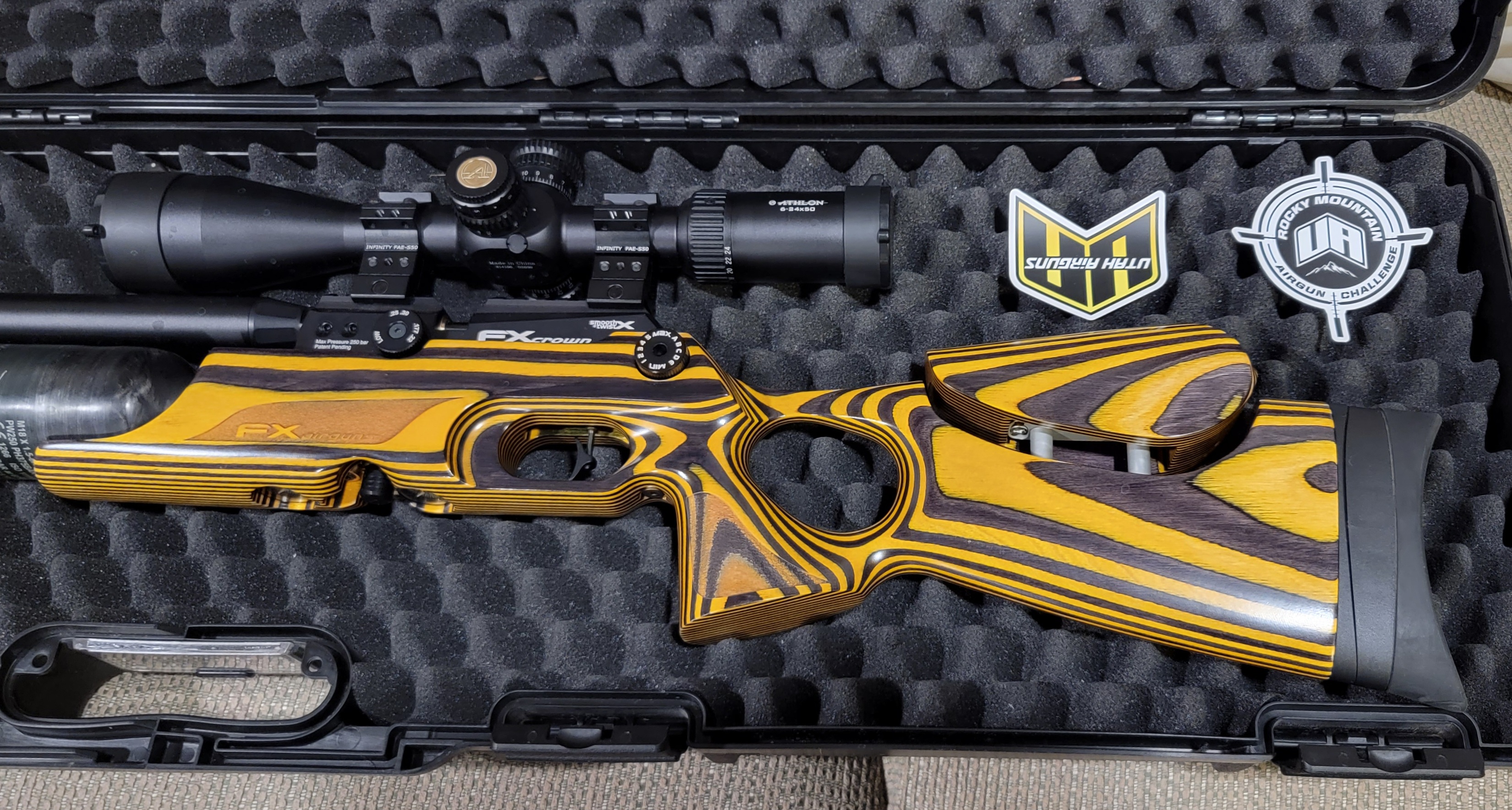

She’s purty, .20calguy. I am generally conservative and traditional, and that Yellowjacket is loud, but I like it! S7

Good morning Sanctify7
I was orginaly going for the Fx Impact, but being conservative myself I went for the Crown Mk 2, because it has some wood on it. I like walnut, but the Crown stock was plain and lack luster to me no real walnut character. Then a great deal on a used Yellow Jacket came along, but I missed that sale. That focused me on the laminate stock Crown Mk2, in any color. I found this one used, at Utah Airguns. I wasn't too hip on it being .30 cal, but I am liking it.

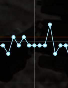

Here's the shot string of that group.
Interestingly the last shot of ten went high in the group, and is higher in velocity, although I don't think that little extra velocity would have a 1/4" difference at 72 yards, and is likely happenstance. That is only 5fps difference.
