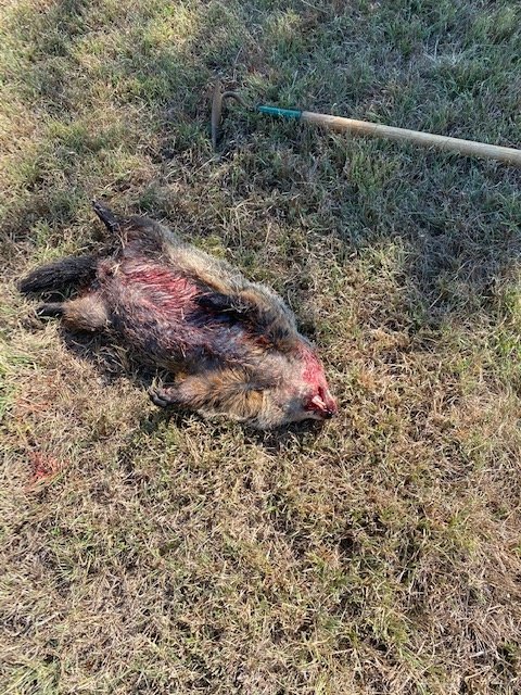

these crowns are really great shooters ,I shoot them stock all are 25 caliber with jsb 25 grain..I really don't see a need for mods..at 100 yards and under with pellets I'm satisfied...I shot this ground hog 1 shot from 80 yards with my 380 barrel length..I practice at 75 all the time, all the best.
