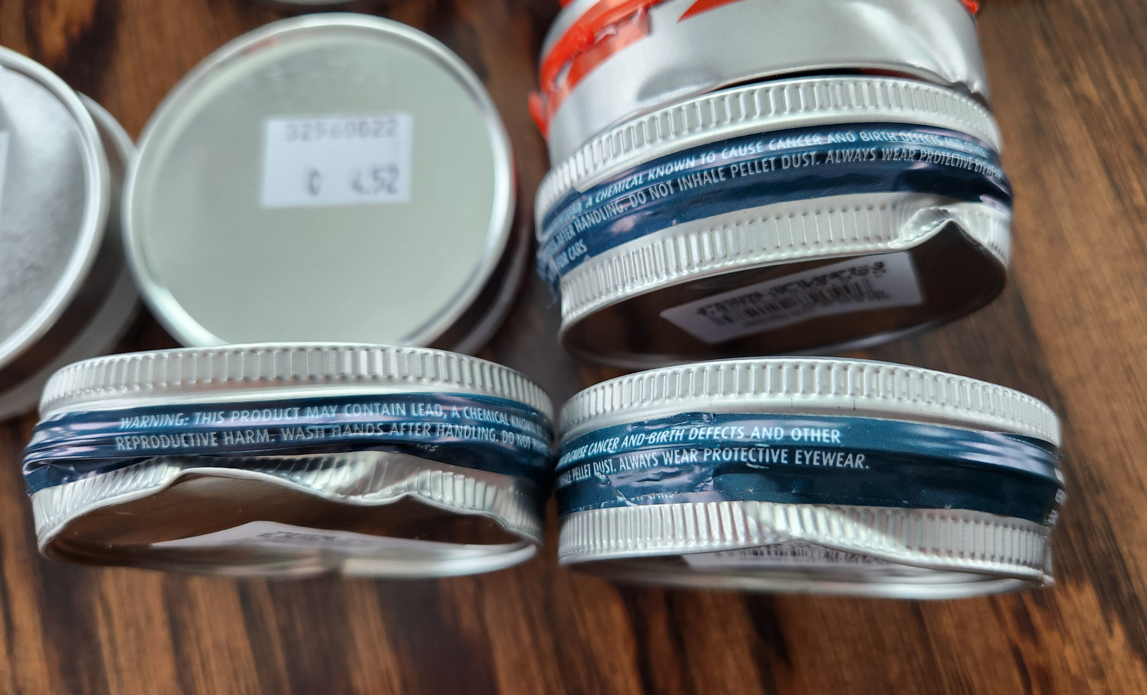

They didn't have the heavy liners available to order so I put my name down to be notified when they're back in stock. I also ordered 10gr and 13gr Knock Outs as well as the 16gr H&Ns. I won't be ordering slugs or pellets from overseas again as customs made a mess of the original packing and the tins got beaten up pretty badly. The slugs seem to have come through it alright though.
