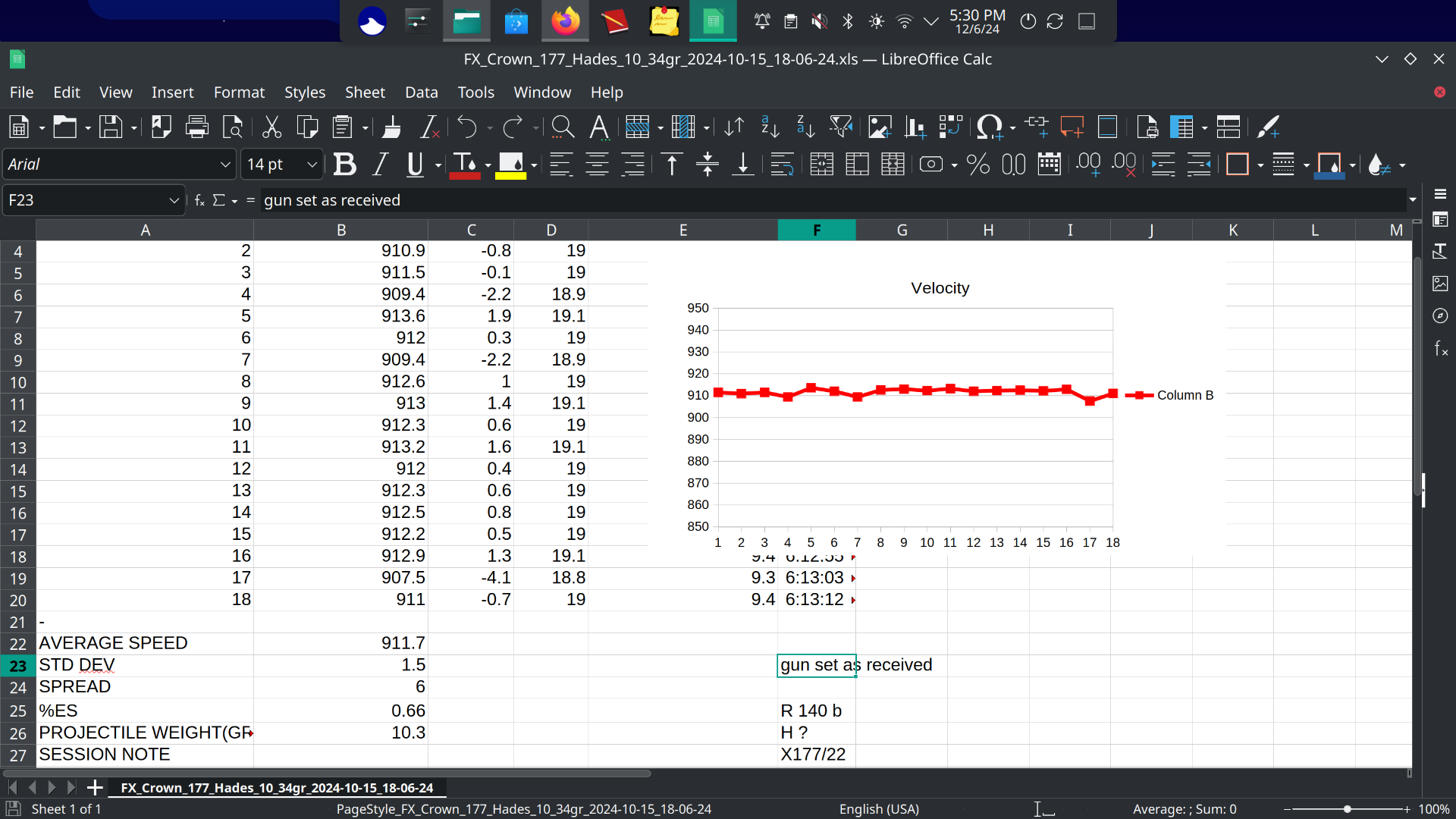

When I received my Crown 2, it was set up as a .177 500mm, and I pulled out some Hades and fired the test string and also fired all of them into a group of about 3/8" at 30 yards. That was just the first "look see" to get an idea of how it shot. With pellets, it is amazing. So, whoever said the .177 in Crown was poor, probably had a bad one.
