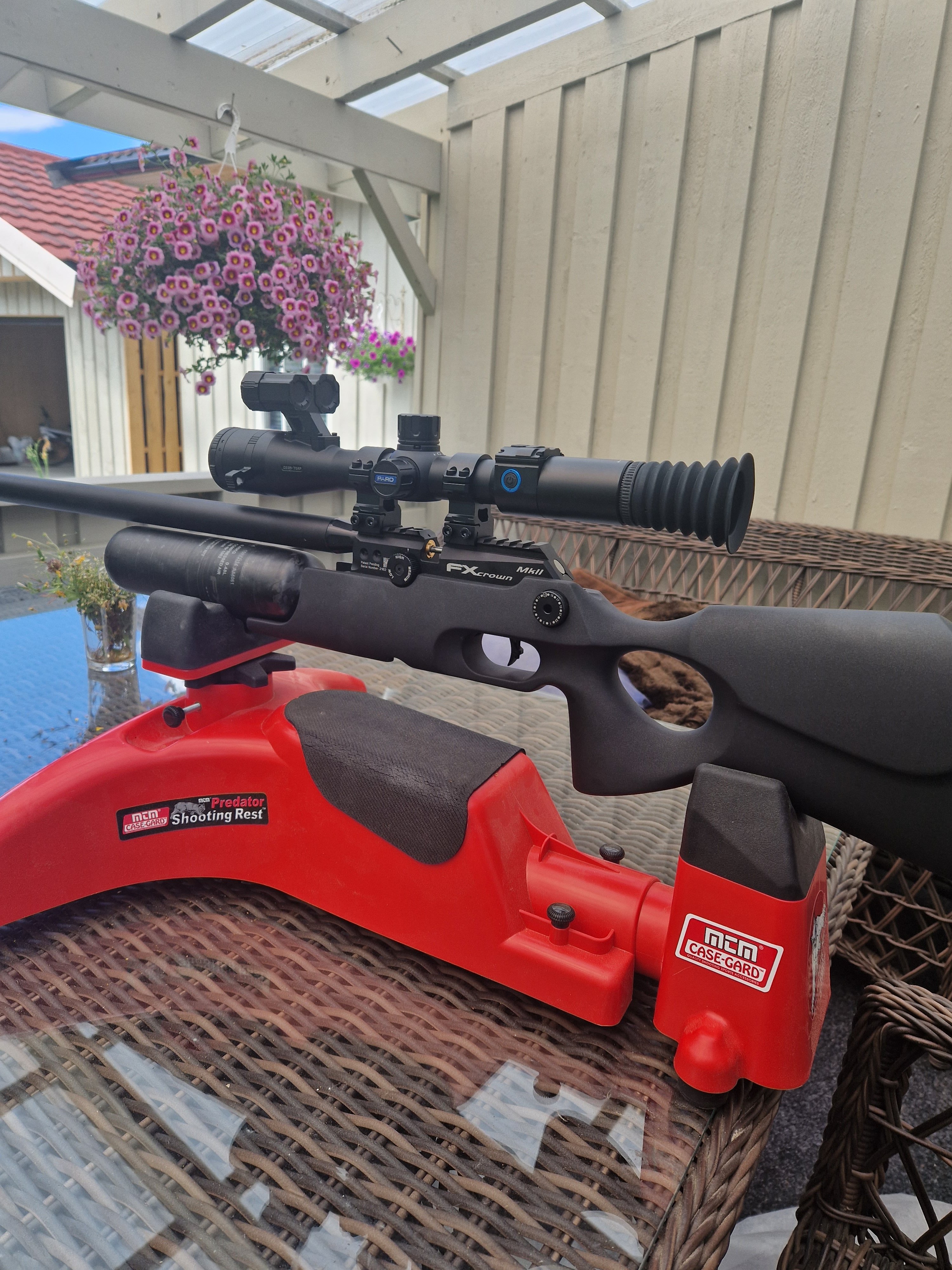

FX Crown mk2 .25

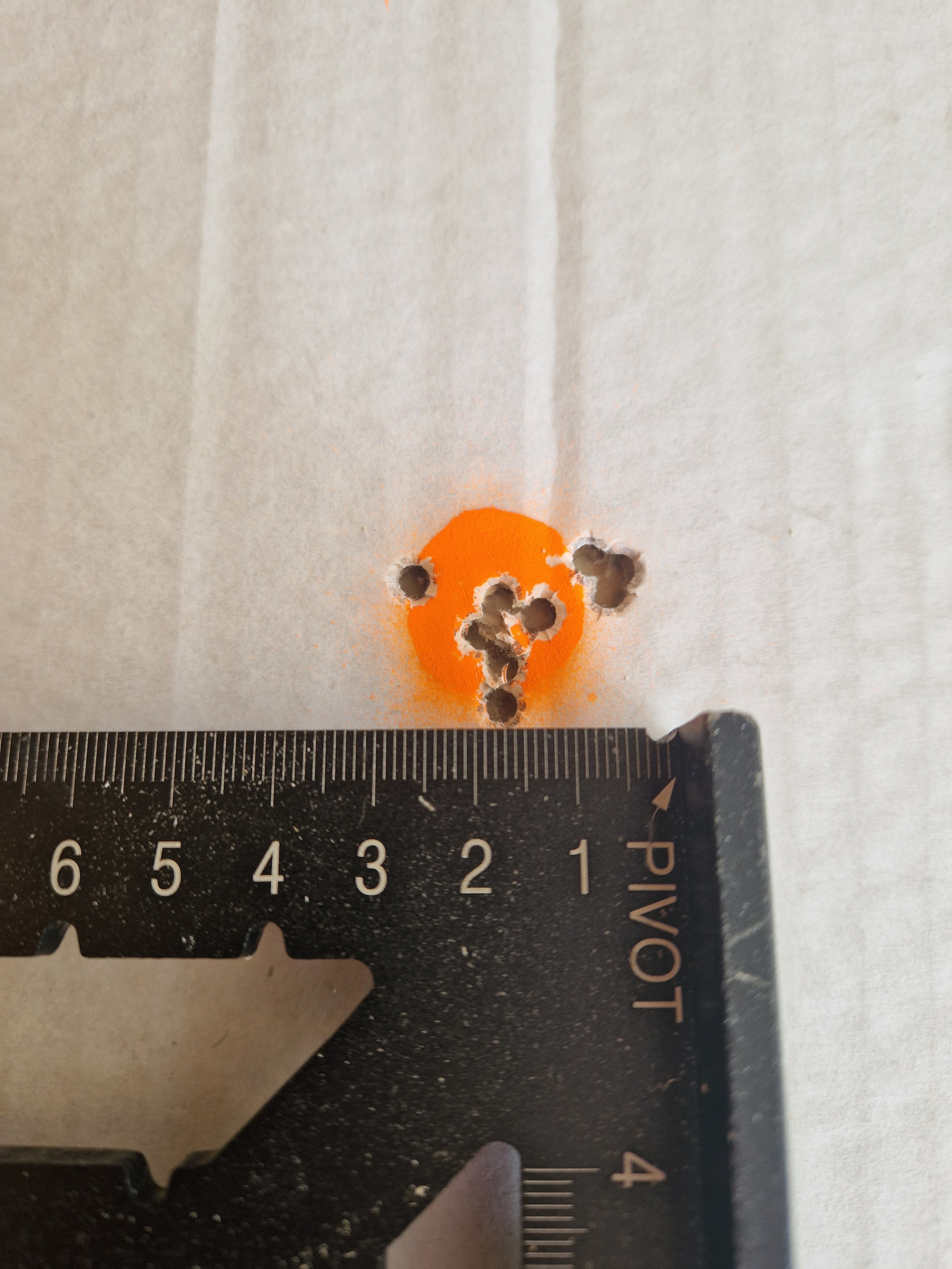

Just got my 600mm .25 barrel kit (not heavy liner).
The gun is shooting 34gr wildmans @910fps and group like this at 75m. Its can Just get better, the table i shoot from is not very stable, the liner has only 50 shots through it. Im very happy so far and dont think I need a heavy liner (yet). But I have orderd pin probe, hume dual tp port and hammer weight so I hope to get to 950fps+ with theese 34gr slugs :)
And I need to find a moderator, the one i had on my .177 does not fit xD
I’ll just confess that I’m not a fan of pin probes. In more cases than not I find that accuracy with slugs goes down. My suspicion is that the pin probe, combined with spring tension from the mag (which varies according to how full it is) allows the slugs to load in a cambered fashion. I tend to prefer to open up the passage on the pellet probe with a dremel, if needed.
How do you like the PARD DS35? Have you had any issues with elevation limits? I take it you have coyotes on the mind? ;)
Not allowed to Hunt with airguns here 😮‍💨 but I like the scope and not had any problems with it yet, its zero at 50m and the BC calc works out to 220m isj. If I zero higher i can get even further :)

Nice shooting BTW
