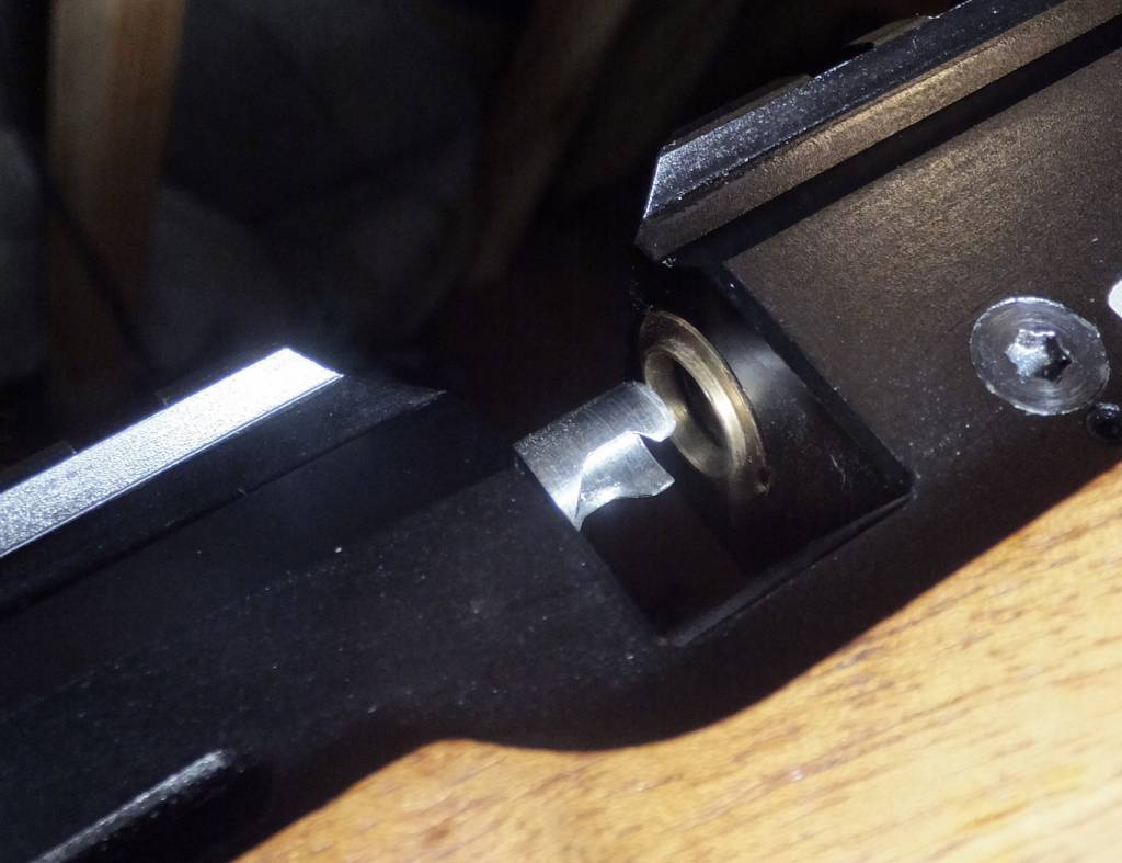

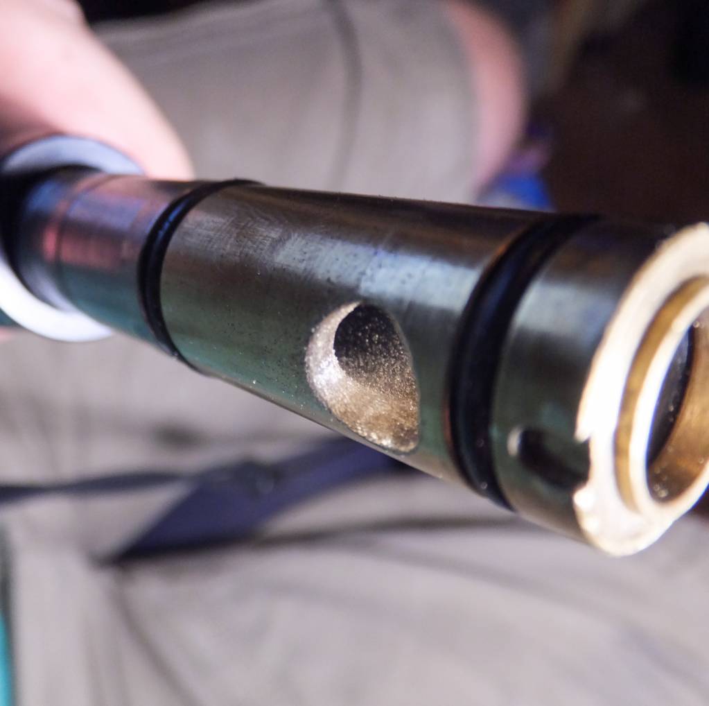

I'd say at this point, add a bit of hammer weight, and you should pick up a lot of power. I know my mk1 has a smaller plenum. I know the mk2 also has a larger valve which is theoretically harder to open. I don't know what the hammer weight is. But I do know I was able to get 85fpe with 7gm of added hammer weight @ around 145 bar
I guess I did massage my ports slightly as well. That helps some.
