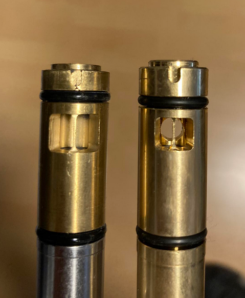

I have been tunning my .22 Crown II and can't get past 900 fps with Barracuda Match. I would like to shoot 25 gr pellets at 950. I have been thinking of rotating the barrel 180 degrees to bring the slug transfer port in line with the valve. Has anyone tried this?

Use the slug port as others have mentioned. Just because it is called a slug port, doesn’t mean you shouldn’t use it for pellets. I would say most use the slug port. If you wan the most power from the Crown, it is the way to go. Mine always stayed on slug, whether I was shooting 18gr or 25 gr. You can adjust the power wheel and the air flow as well to help with changing speed still, without having to adjust the reg.
My Crown had the best accuracy with 25 at right around 930-940. I could shoot them on max and 18s on low, and both were phenomenal. My reg was set at 150 with the 600mm barrel.

The maverick has 3 probes that I know about, the pin probe, a slug probe with a larger square hole and the standard smaller circular pellet probe. The square slug probe works well with the pellet port and of course the slug port, less air restriction.

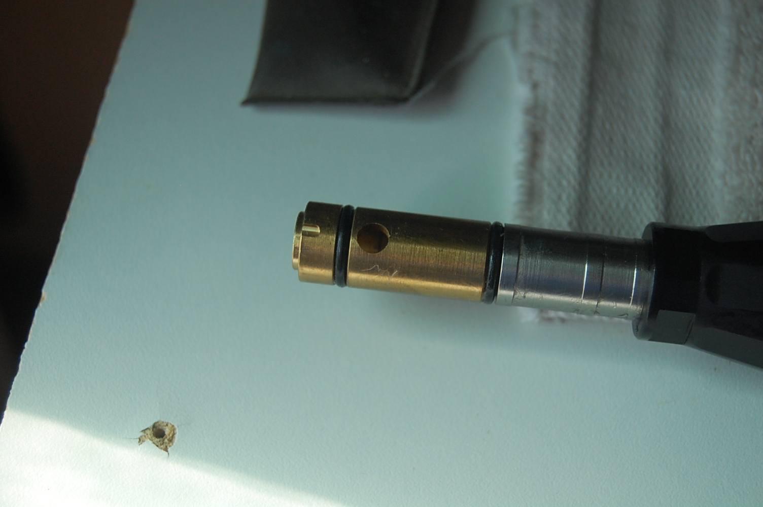

I ran into a problem with my Crown MK II, while trying to push slugs at higher velocities. The front dial marked High / Medium / Low worked loose and the internal ports were out of alignment. High on the dial was not the maximum port opening. This limited the power and speed obtainable. I took it apart and re-aligned the ports and dial to fix the problem. If you are not getting the velocities expected for the reg pressure and hammer spring settings, this might be your problem.
