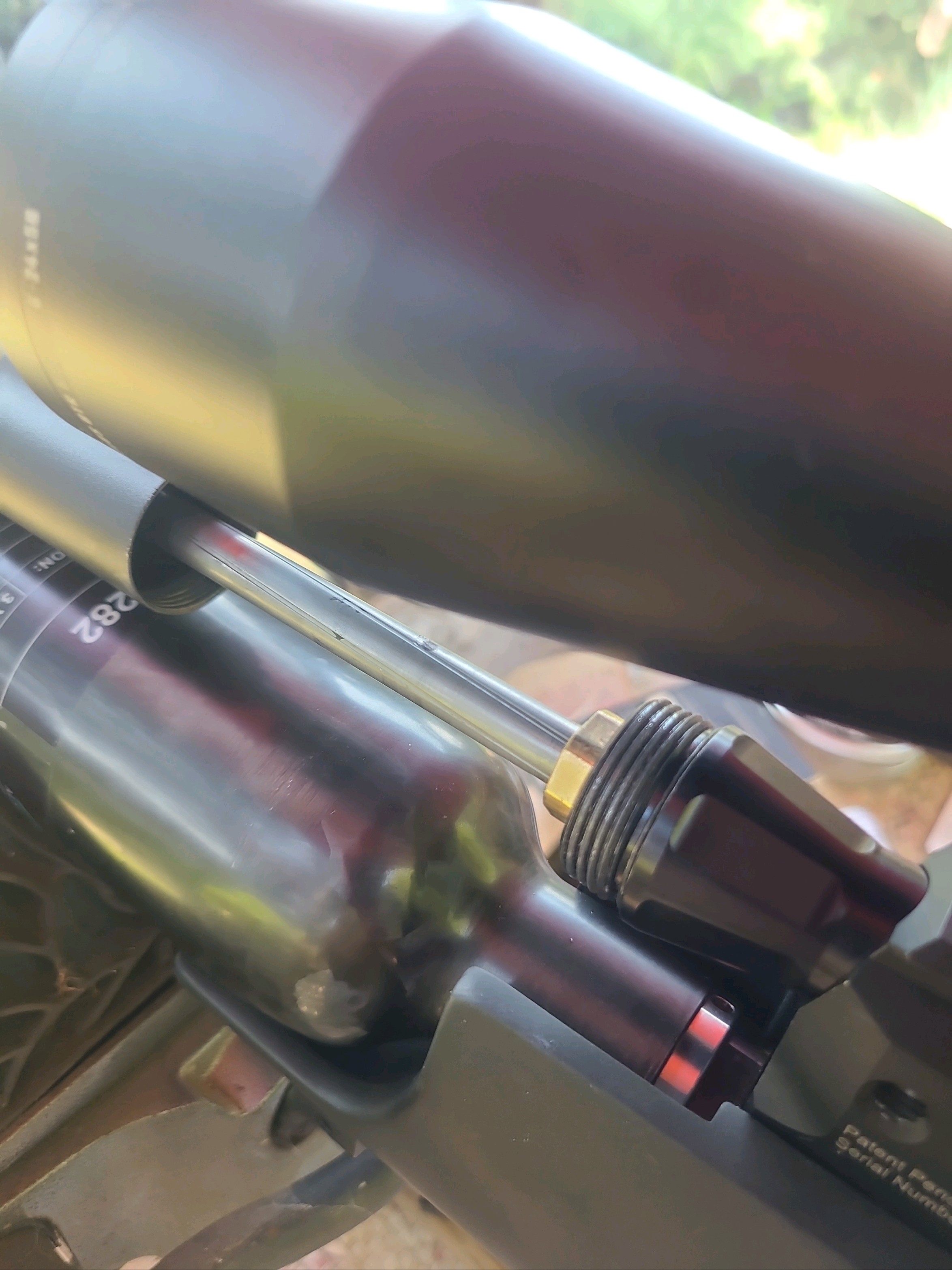

Hey Guys and Gals,
My .25 crown is sliding forward an inch in 3 shots rasing h*ll with my shooting.
I have 6 orings degressed on the block side of the shroud nut. I've cleaned the interior of the block where the barrel assembly sides into, and still shoot my barrel towards the muzzle.
Any ideas on how to rectify it?
Thanks.

Here's a picture. That small black dot is where the barrel was up agaisnt the nut. This is after three shots. Istop because the velocity started dropping drastically. From 970 , to 748, to 640 fps. Next shot probably would have jammed a slug. This whole thing started when i was indexing.
It works like an elongated compression connector, works okay but doesn’t instill a ton of confidence.
I think as long as you don't disturb ie indexing your ok. The orings are compress into the lands and grooves of the liner, when they are "older" they may not comform to the new location. My guess.
The FX exploded diagram lists 7 x O-ring 5,5x2 NBR 70 in .25 cal for the Crown Superlight
The brass nut in your pic tightens and compresses the O-Rings holding the liner in place, but it also needs the black outer shroud to aid in that (the part that threads into the cone piece).
The shroud threading onto the liner tube via the muzzle adapter (outer black tube) holds that in place via the 2 or 4 screws (2 for older and 4 for newer Crowns) that are within the receiver block.
It LOOKS like you have the 4 screw (newer) block. I used to torque mine so that I could reinstall the barrel assembly to the same spec every time. Alternating like you would when mounting a spare tire or rifle scope.
Are you certain that you have the right liner inside of the shroud? If the liner is a 600mm and your shroud is made for a 700mm liner, then it will shift forward because there isn't enough hold in the brass nut and O-Rings. It will move forward without the muzzle stopping it.
If the shroud for example is for a 700mm and the liner matches, then I'd consider the block screws are loose.

Hey Guys,
Evidently, when I bought my Crown mk2 600mm. 25, the barrel sleeve, not the shroud, the barrel sleeve, had 6 orings locking it into the block via the locking nut on the shroud cone.
Reviewing what was happening with FX USA, we discovered that the set of orings come in a 7 pack. Bingo!
6 brand-new orings held until I disturbed thier grip by the indexing process.
Fx USA is sending me the 7 pack of orings as a warranty issue.
