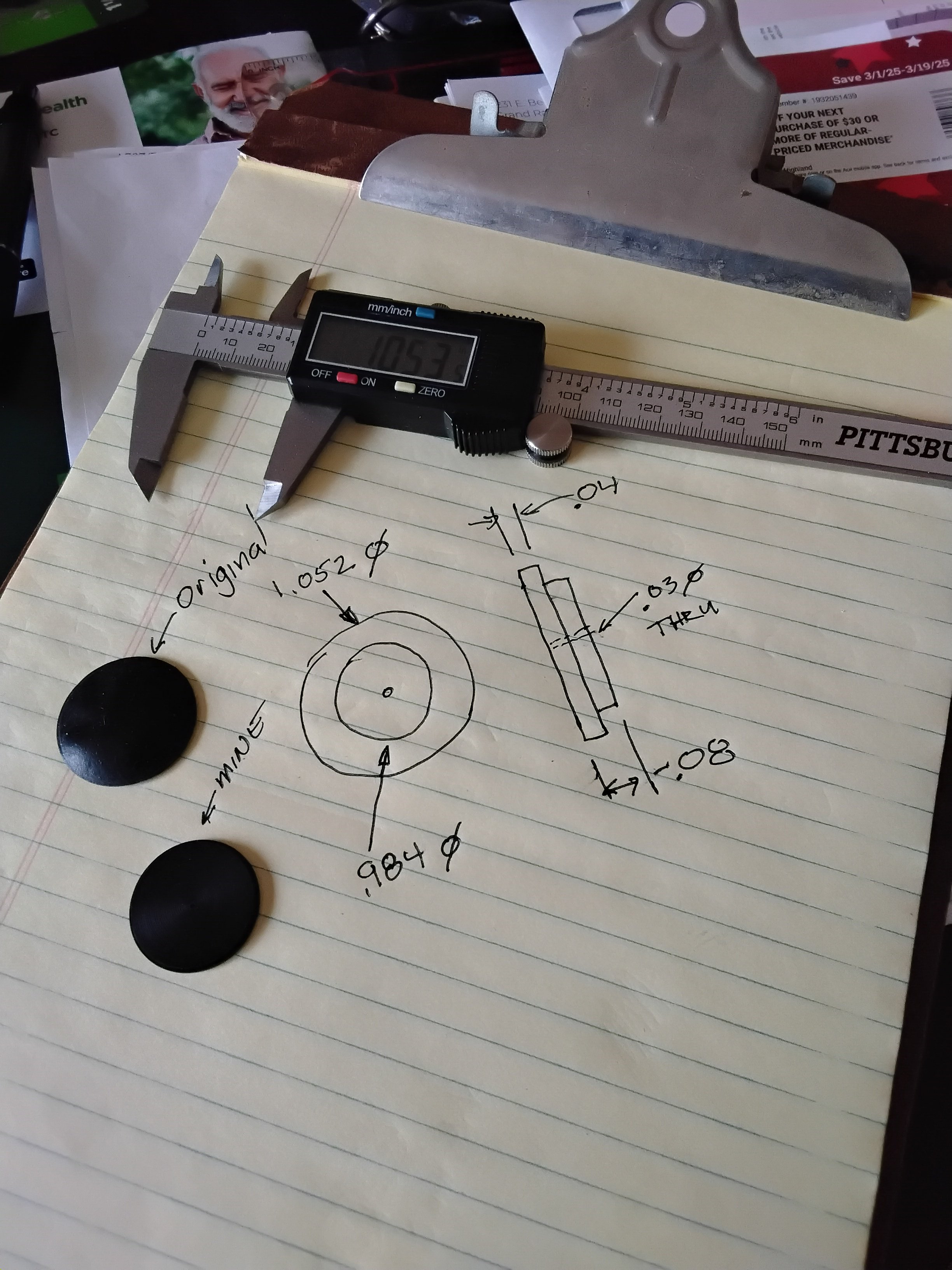

any pictures of the process?

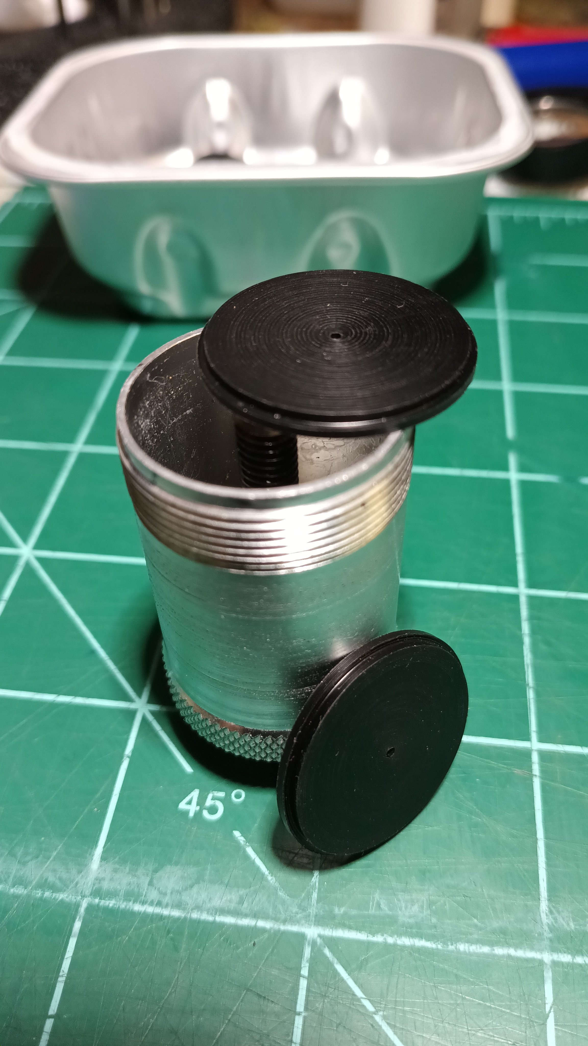

I made myself a couple of these for my GX K2. I was bored
nice!!! whats the outside diameter of your new piece?
Here ya go
I used some Copolymer I got off of Amazon. I've made a lot of parts with this material. Shock and swing arm bushings, moderator parts and so on. It is some pretty robust material, machines well, not gummy like nylon.
Not sure if the 4 and K2 have the same grease pots. On my K2 the outside diameter is 1.080 on the 4 it is 1.100 I would the think the insides are the same but who knows. (it's a made in China thing) If you have calipers measure the OD.

My early model CS4 the grease pot is great. The K2 one of the pots were sucking the grease like mad., so I made these. I'll probably order a few rubber discs just to have on hand. Thanks for all the info you post on the GX compressors.
